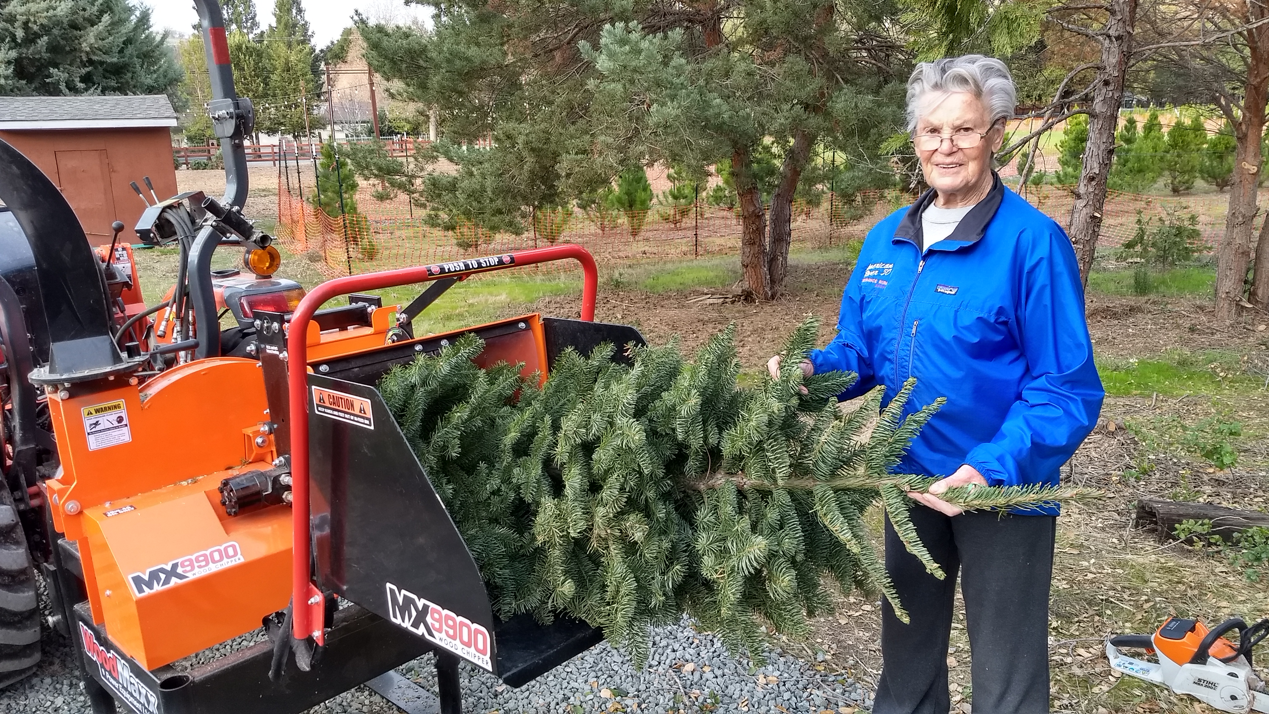

We do have a feed 3 point that is working well.

Thanks... Mom is always one to pitch in and always finding something that needs doing... she chipped all the unsold trees... all I did was move the tractor around.
She loves spending time at the tree farm... being able to help is very important to her plus her growing up on a family Diary farm likes being around the cows, pigs, chickens, horses... well they never had horses on the farm...
After shopping for used units my brother opted to go with the 3-point with feed based on favorable TBN comments...
When it arrived the knives were way out of spec... dialed them in and unit has been working well the last two seasons... so no long term report. Another plus is not having another motor to maintain...

You can tell she keeps active. How old is she in the photo?
/ Used chipper prices? #11
84... soon to be 85
