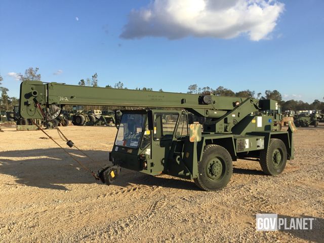

I've been looking into buying a used mobile crane for on-farm construction tasks such as setting steel roof rafters.
Browsing auctions for government equipment I saw many Terex LRT-110, a mil-spec crane, with very low hours (under 50) regularly sell for around $15,000 in operating condition aside from a dead battery. I don't know how old they are, but assume most were made in the 1990s.
Mobile Cranes For Sale | GovPlanet
How do these military cranes compare to other used cranes? Is there expensive maintenance I should expect to do immediately?
Would something else like a carry deck crane or telehandler make more sense? I want to spend under $20,000.

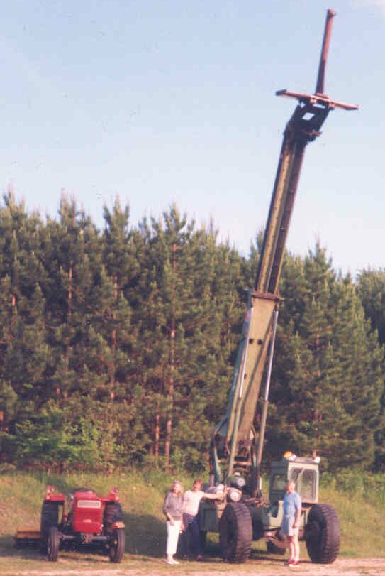

I have loved cranes since I was around three years old. There used to be a pipe manufacturer near us with all manner of tracked cranes in their yard. I would go nuts.
But for most, including me, it would have very limited use. A telehandler would be much more useful (I owned a 12 ton one). It can fill in for a crane.
The day we got the Dynalift.
Always liked those REAL sized wheels! lol

I was the equipment officer/manager for several Navy expeditionary Reserve units. Those low hour units are virtually brand new. The military replaces CESE (civil engineer support equipment) based on calendar age not on hours. Some reserve units do not use stuff very much; but, they over maintain for training of maintenance crews, batteries run down, and rubber goods deteriorate. Beware electrical systems are 24 volt and the batteries are very expensive. In your case you could get by with smaller batteries though.
Because of requirements for durability and reliability over wide conditions; military CESE is way over engineered compared to civilian market equipment. We used to re-certify our cranes every year even though not used just for the training value. That unit you were looking at probably cost DOD $100K +/-. We had a tactical wrecker built onto a 5 Ton cargo truck that cost $350K where a civilian counterpart would be $100K. If you get one be sure and get the O & M Manuals. Engine internal parts are fairly standard but most other parts are unique to the military. Most parts are available in the surplus market place. Major work is done in specialized depot maintenance/repair shops not by field units. In Vietnam I Corps area the Marine Corps actually had depot shops the Seabees built; right across the road from the camp I was in. Military parts were fairly easy to get over their but we had a civilian fire truck that needed a drive shaft for the main pump; previous battalion had on order 6 months, we were there 10 months, still on dead line.
That unit will outlast you 2-1 if maintained. Also they are diesel hogs with engines way bigger than a civilian counterpart. Not built to Green standards.

I have been told the mil units have short booms compared to similar commercial lift units. Military uses them for material handling (containers) more than construction. Look carefully at your use and their reach charts.

Thank you for sharing your expertise. I don't expect to be building anything taller than 25ft and only a few dozen hours a year use most likely (higher fuel usage not a significant issue) so this will be perfect.
My thinking is the 2 piece boom means less to go wrong and easier to repair. The idea of military reliability and very low hours is appealing.
They sound like great machines for the price.
I will probably buy one of these in the next year or two unless I find a better deal on a good condition telehandler or truck crane.

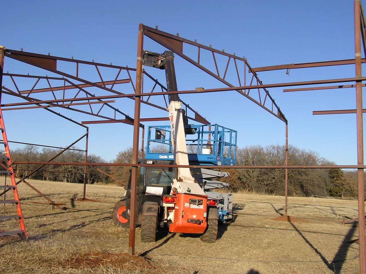

Sell your tractor and buy a compact telehandler: http://www.tractorbynet.com/forums/...pact-telehandler-post3243370.html#post3243370
These are 40' steel trusses:

I worked for a crane manufacturer for 10 years. In that time frame we built cranes for the Air Force and Marines. Memory wise unit was built structurally same as other units. Now could be different specs for engine or tires or such. Remember the Marine unit had mount for M16 in the cab. Things I can remember different was special paints used due to the use of one in water and it also had all electrical connects sealed with silicone sealant. But basically same machine as regular unit was except tweaked for their needs. If battery box is like the ones we had we used 12 volt batteries wires in series to get the 24 volts. Then all our units cranked on 24 volts.
Using crane with boom rotating and you sitting below it is not as good as one that rotates wit the boom but you will or should have clear view of about 180 degrees. I would have no issue buying a unit like that. Just do the normal checking the machine. Regardless of what type of machine you buy tipping is a major concern. Study proper operation. Move load low as possible to help prevent roll over, much like front end loader use.

Don't do it. You'd be much better off with a telehandler. The crane is single use. The telehandler is the way to go.
First, read this thread from 2001. It's a long read, but makes tons of sense. Worth spending some time reading.
http://www.tractorbynet.com/forums/related-topics/5108-compact-tractors-designed-all-wrong.html
Implements, with few exceptions, like dirt plows and large mowers, belong out front where you can see them.
For all other tasks, the telehandler makes the most sense and bang for the buck.
Read Xfaxman's posts and reasoning...
For that matter, if we can't talk you out of buying that crane and into buying a telehandler instead, consider investing the $20,000 and using the interest to rent a telehandler when you need it. In the end, you'll still have your $20,000 (probably way more), and won't have a single purpose machine sitting behind your barn with the tires going flat and batteries dead. ;)
