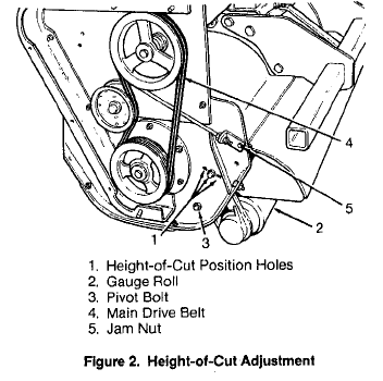

Just bought a 917 flail. Is the rear roller height adjustable? It resides at my property a couple of hours from home so I can't just go outside and look. Hope I'm not guilty of thread hijacking by asking the question here.
Three pair of holes, they're considered coarse cutting height adjustments. Fine adjustments are subsequently made with the toplink. Top holes put mower chassis closest to the ground (short cut). Middle and bottom holes progressively increase chassis height. Mine's just for pasture & roadside maintenance, so I stay in the bottom holes full time.
//greg//

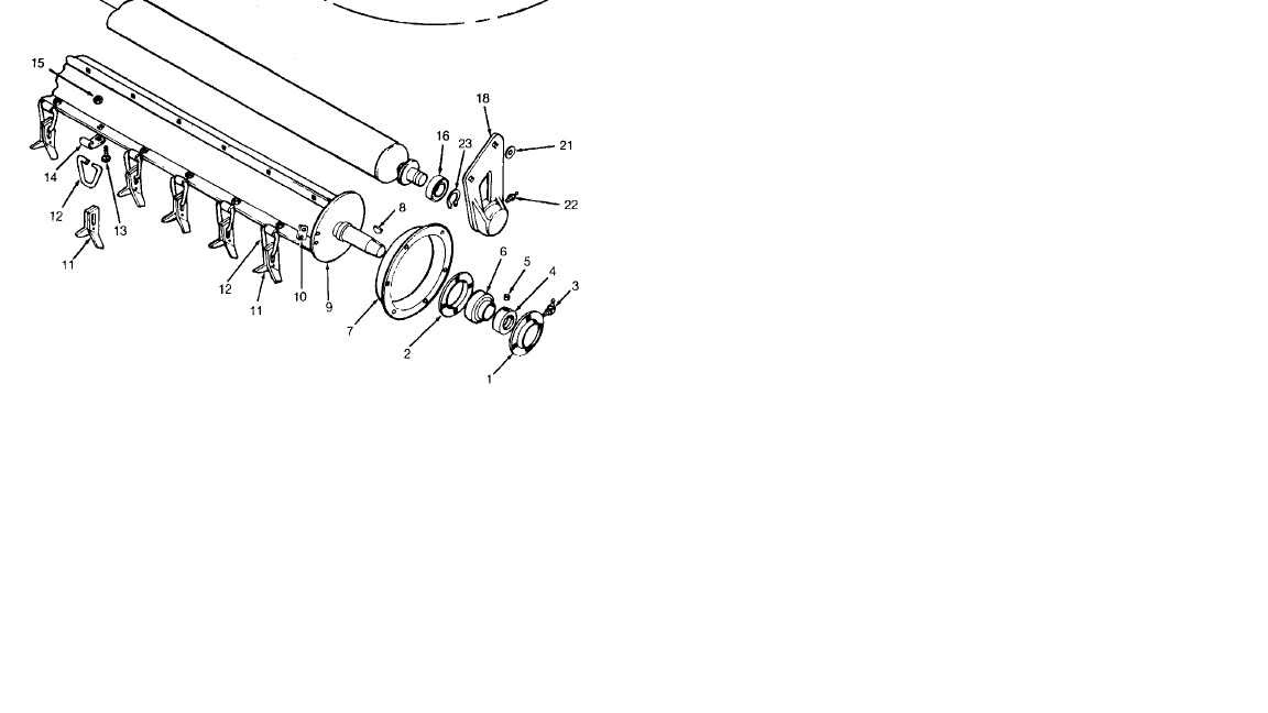

Greg, are the adjustments made from the inside of the rotor housing?
/ Used Flail Mower. #19
There's a bearing carrier on each end of the rear roller, which double as the roller height adjustment points. That's the triangular bit in the diagram (#18). Obviously, the other one is at the opposite end of the roller. The bottom hole is for the pivot bolt, the upper hole is the one that can be fastened to any of the three roller height holes on the frame. See below: #3 is the pivot, #1 is the adjustment selection
//greg//
