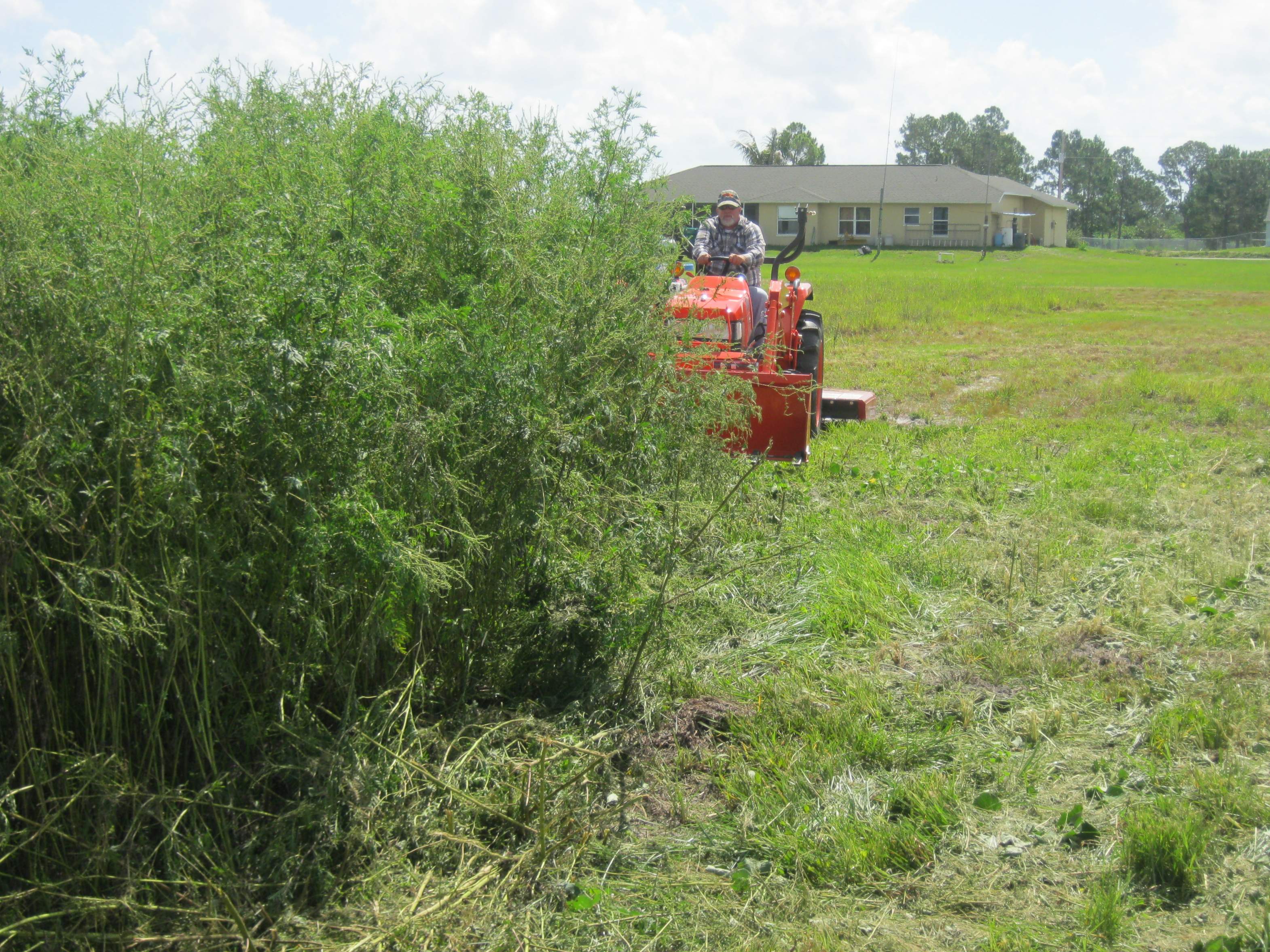

pic # 2 me collecting ragweed to ship to James k0ua :D

Oh, and you can keep that danged ragweed, I hate that stuff!:mad:
