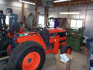

I forgot to throw this in and its kinda after the fact because you already bought the 3710 but--
The 5030 I have has the new style loader on it. It's an LA853. I believe it's the largest capacity loader Kubota offers on this series. I have a problem with it over the loader that comes on the 3710 and that is--
The 3710 had 4 pins to remove and very stable swing down legs for dismounting the loader. It usually took about 2 minutes to dismount and 3 to remount the loader.
The 5030/853 loader has 2 pins and is a LITTLE quicker in both aspects but the stabilizer legs are not adequate for the loader and the loader has to be absolutely level on dismount to get it aligned for a remount. This was not the case on the 3710. I don't have very much concrete available to remove the loader on and I found out the hard way the first time I dismounted the 853 in the dirt. I had to pin the loader on one side, lift it slightly and block the other side to level it before it would slide into the upright. I never had that problem with the 4 pin mount on the 3710. /forums/images/graemlins/crazy.gif /forums/images/graemlins/crazy.gif
