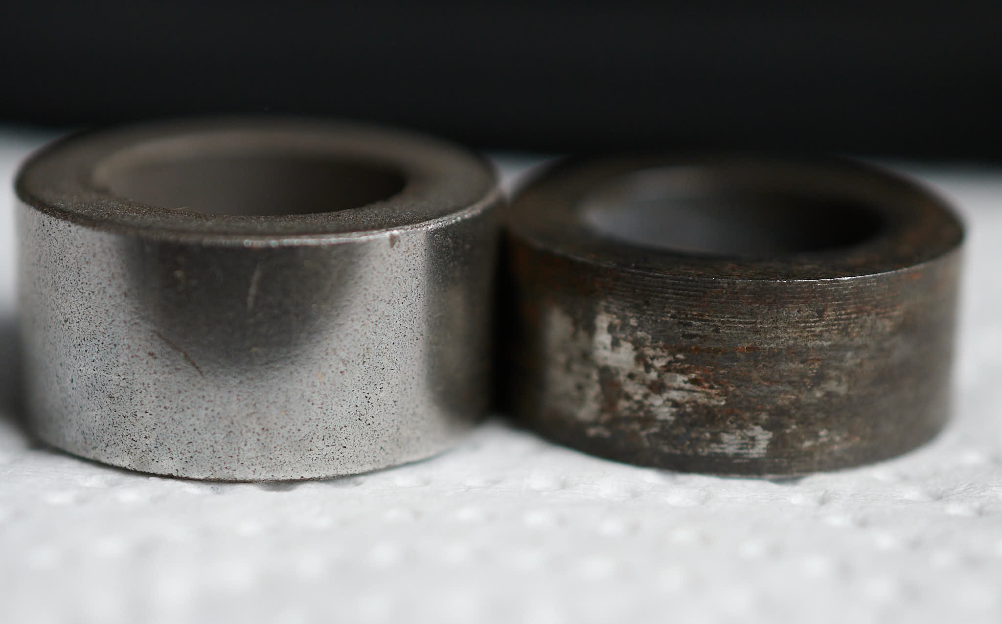

The parts from McMaster Carr arrived. The bushing looks to be of a higher quality than the OEM, but it's 1/2" long where the OEM appears to be 3/8. Is your blade 1/2 thick where mine is only 3/8? Or is the 1/2" length supposed to work?
The diameter is also tight to the mounting hole in the blade which I assume is a good thing indicating that my blade mount isn't wallowed?

These are oil impregnated high load bushings which would be great to use provided I can understand how they fit. Maybe I could use a couple of washers as spacers, IDK?
McMaster Carr's on line catalog does not show a 3/8 length for these 5/8 ID x 1" OD type of bushings.

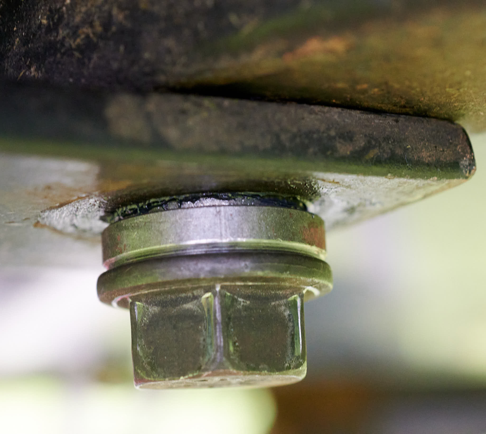

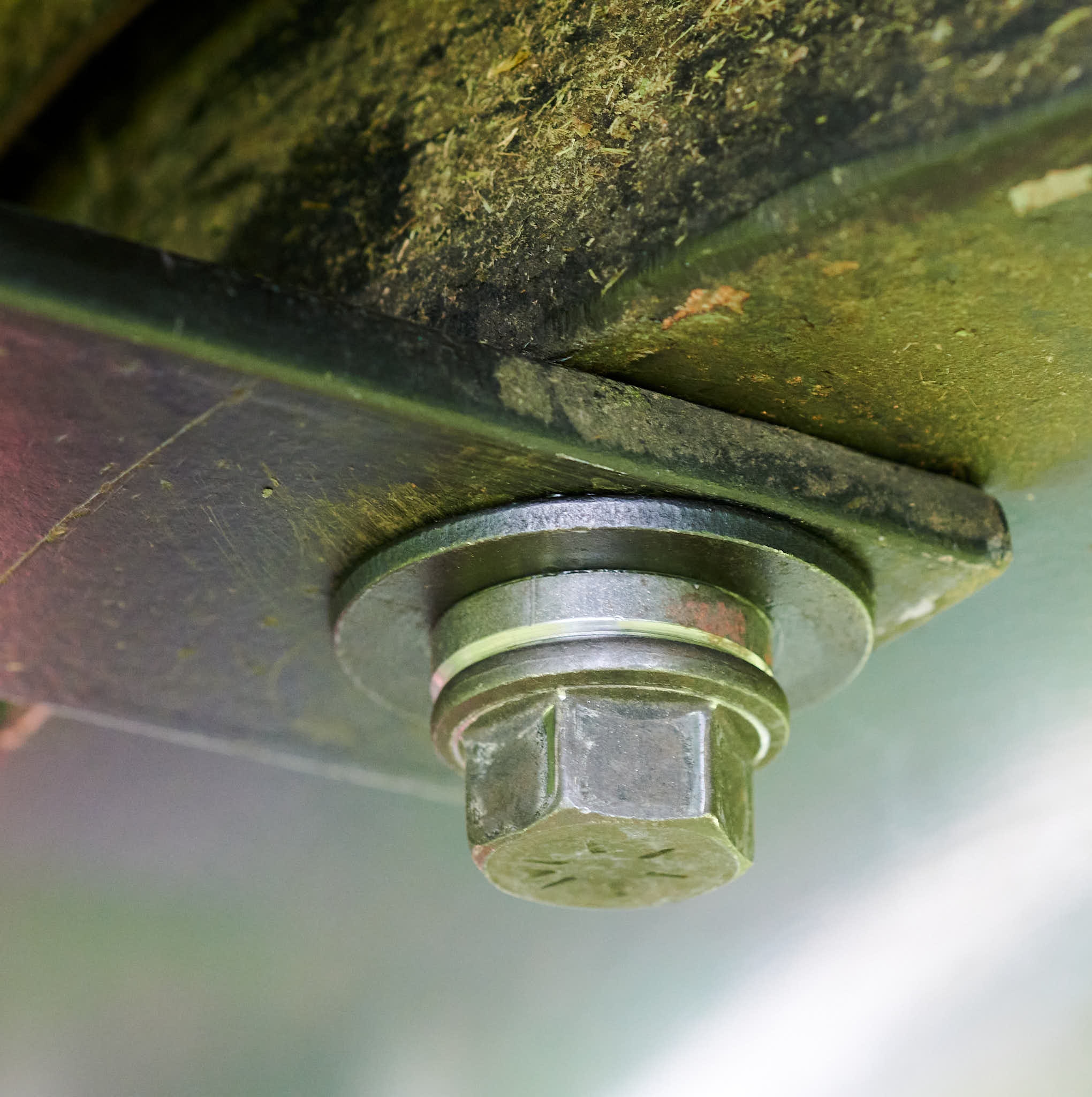

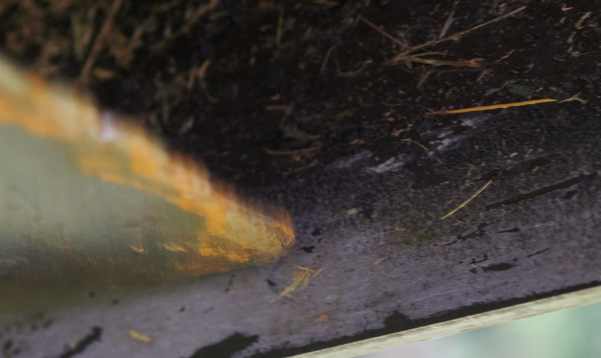

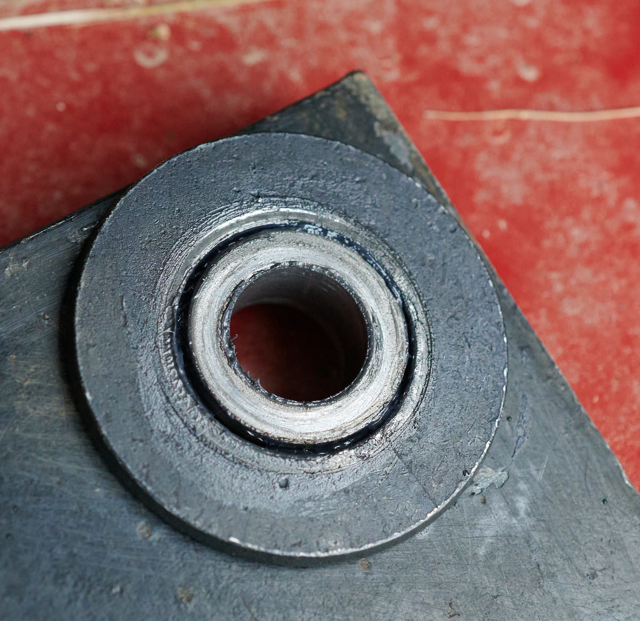

Adding a few pictures to help clarify where I seem to be on this at the moment.
If I add a 1"ID washer to take up the slack, the blade no longer wobbles up or down, but the washer seems to be locking the blade in place so it can't freely pivot. My concern is whether the blade attempting to pivot on its axis will work the bolt loose?
If I remove the washer, then there is enough free play that the blade can then wobble up and down again, which seems worse than the original problem.
The original problem was the OEM bushings wallowed out and this allowed the blade to strike the edges of the mower deck housing.
edit: Wondering if I can use blue locktite to lock the bolt in place using the 1" ID washer to make up for the bushing being 1/2" long instead of 3/8" OEM?
One alternative is to get rid of the 5/8 nut and bolt, and replace them with 3/4 diameter fasteners since McMaster Carr stocks a 3/4ID x 1OD x 3/8T oil impregnated bushing part no. 2868T178.

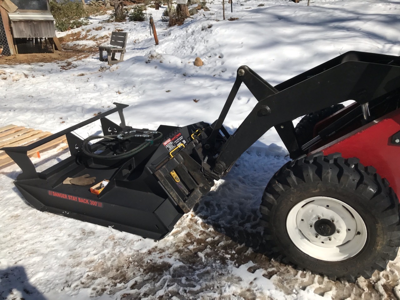

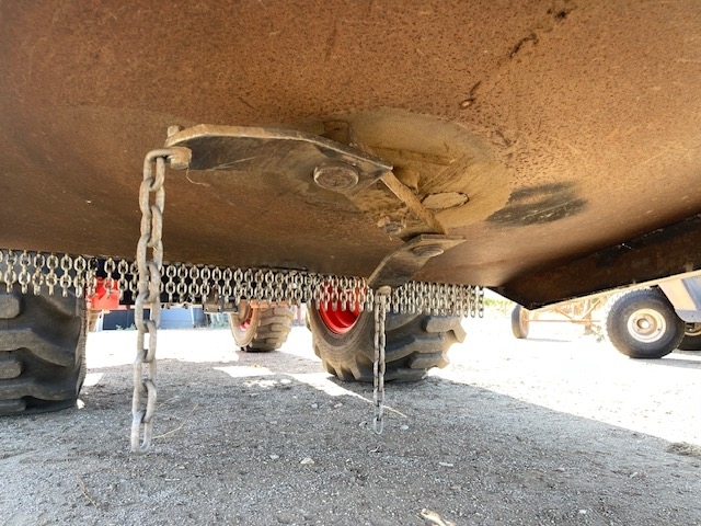

I use my PT rotary for just cutting grass and with sharp blades it does well. For large brush I picked up a Rut Mfg for the 1460 and it takes down 4" Mountain Laurel (I raise it over and lower it down mulching it better then just cutting at ground level and driving over it). I have always been intrigued about the use of chains like a heavy duty string trimmer. I assume you take a cut off old blade and weld chain to it. Then hit rocks with immunity.
I would worry about adding heavier blades to a PT cutter. If anything fails it could potentially be fatal.
After all, a set of PT blades for my 1430 cost $50 last I bought. One blade for the Rut cost $50.
