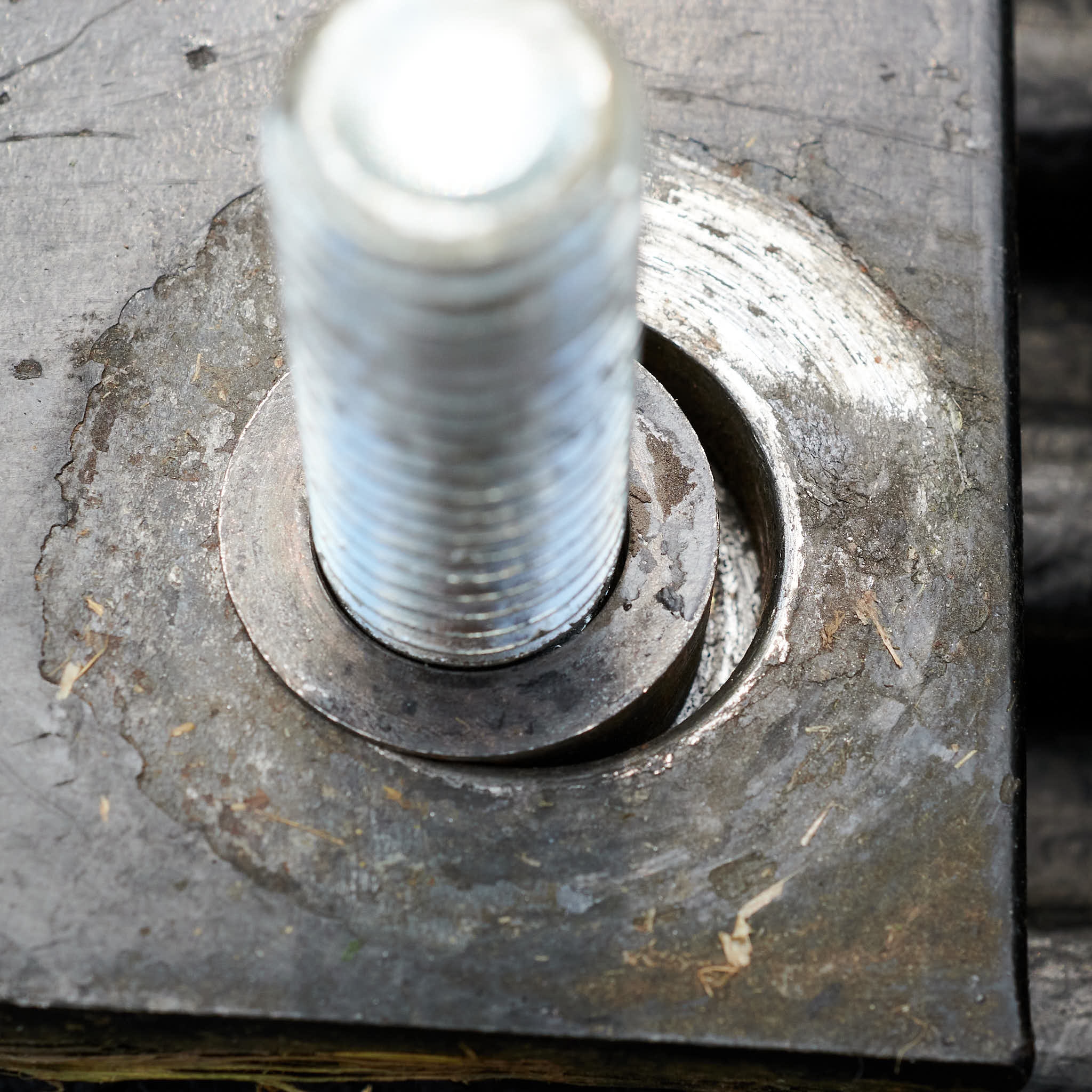

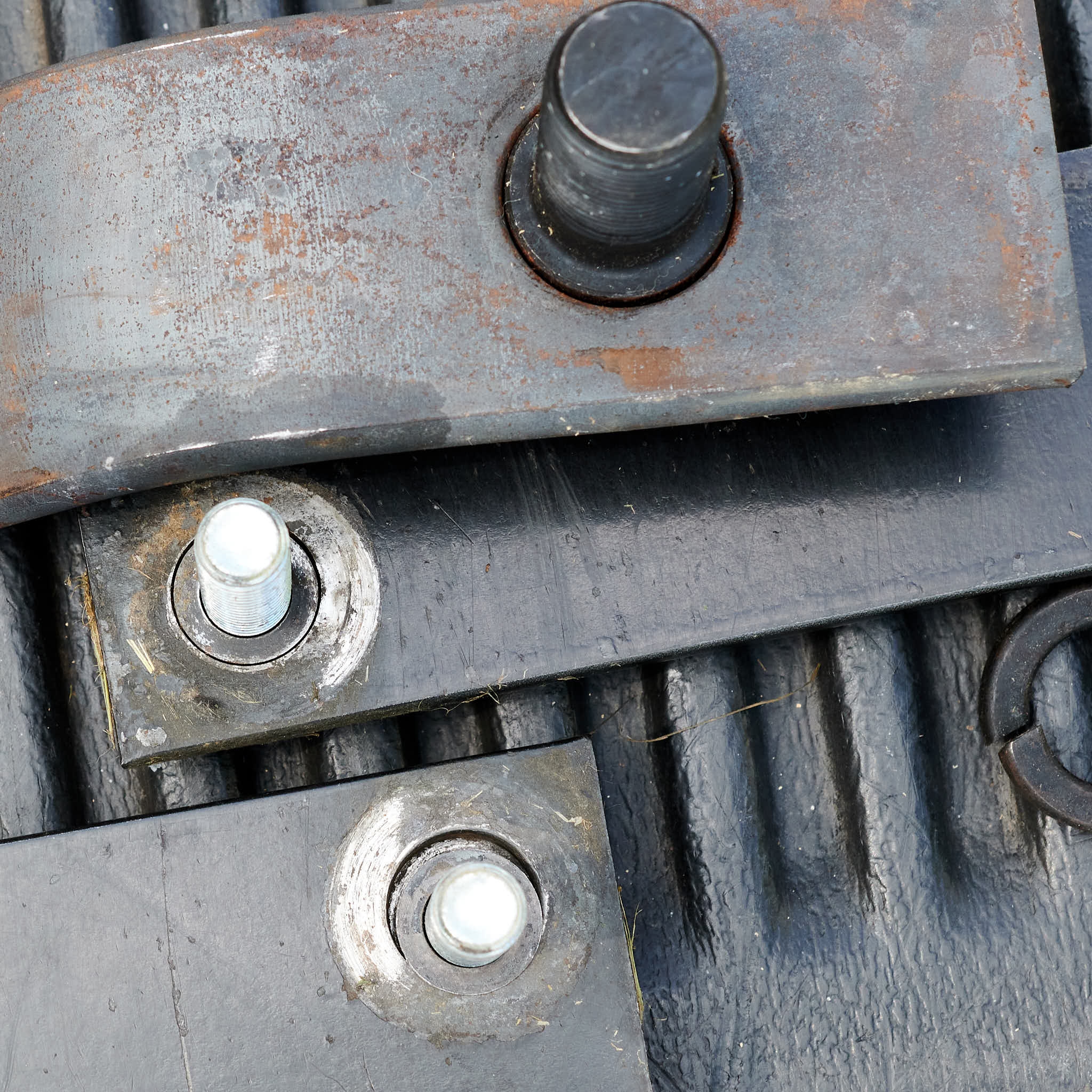

Removed the OEM blades, bolts, and bushings with an impact wrench to find one of the bushings severely wallowed. The McMaster Carr replacements haven't arrived yet.

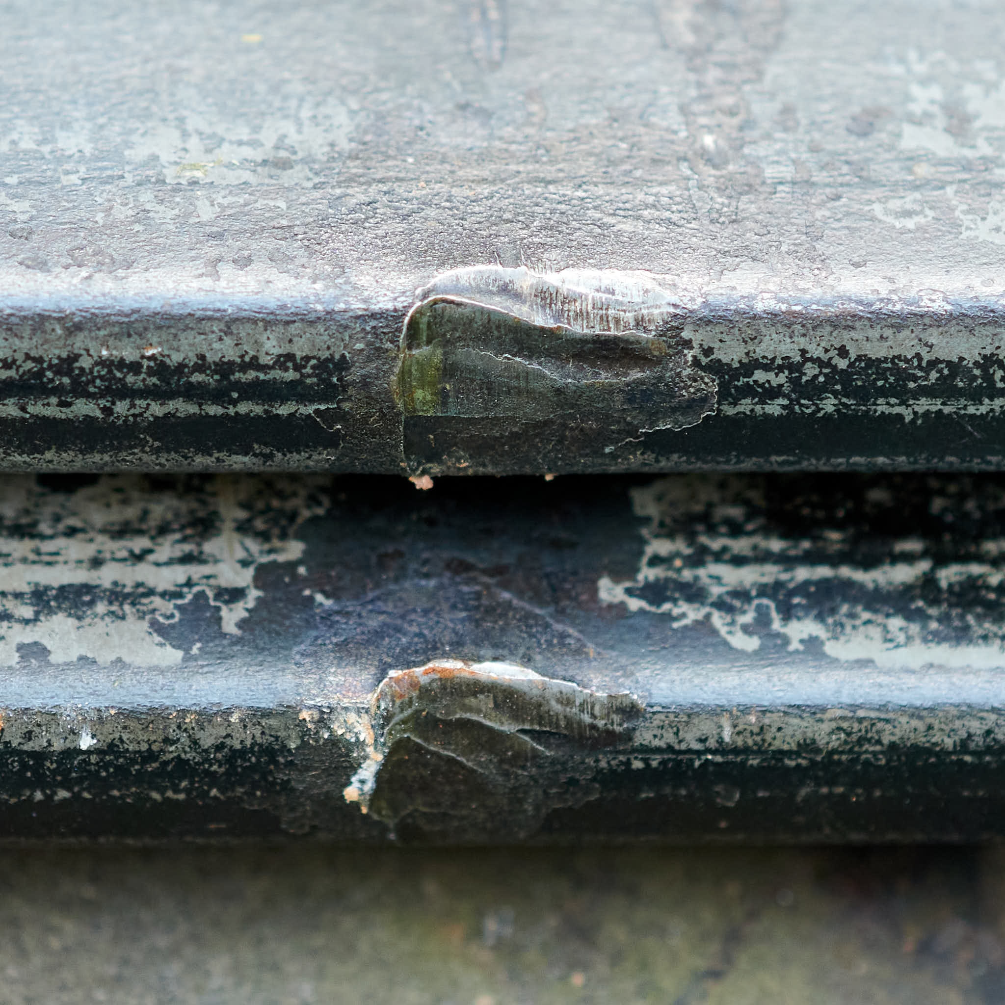

Noted impact damage on one side of each blade in the same area that must be from the blades hitting the bolts in the hub.

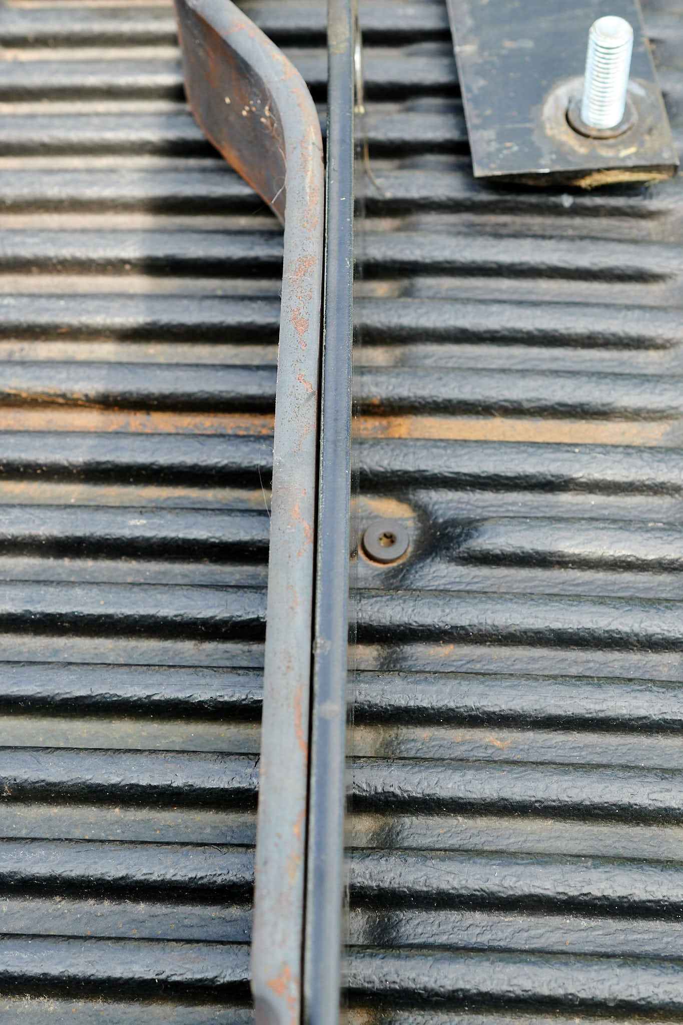

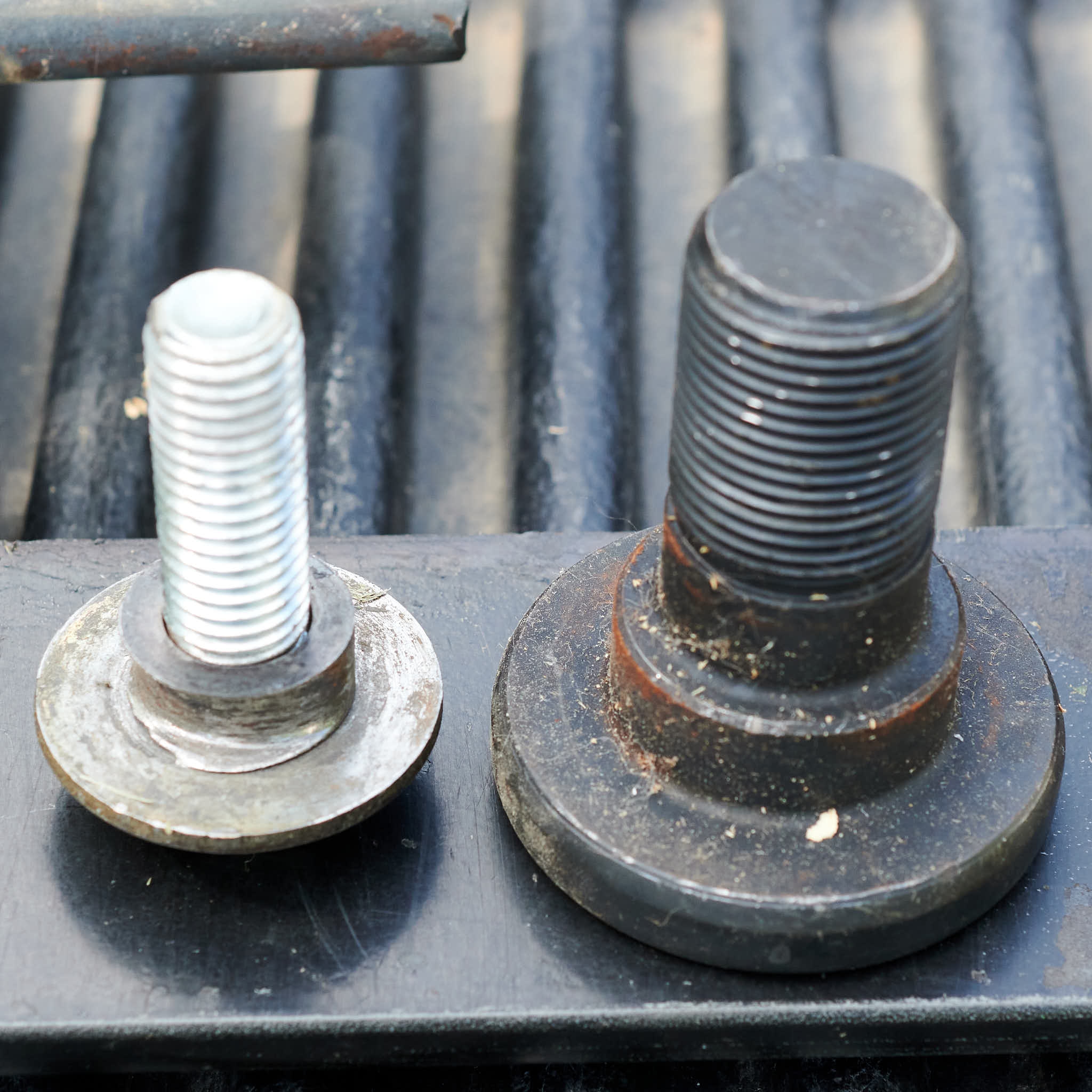

For comparison sake, I included a photo of a new cutter blade for a 6' J-bar and its bolt with the integral bushing. The J-Bar blade and bushing design is much beefier. One odd thing I noticed is that the hole in the PT blade for the mounting bolt and bushing is offset from the center of the blade width instead of being centered.

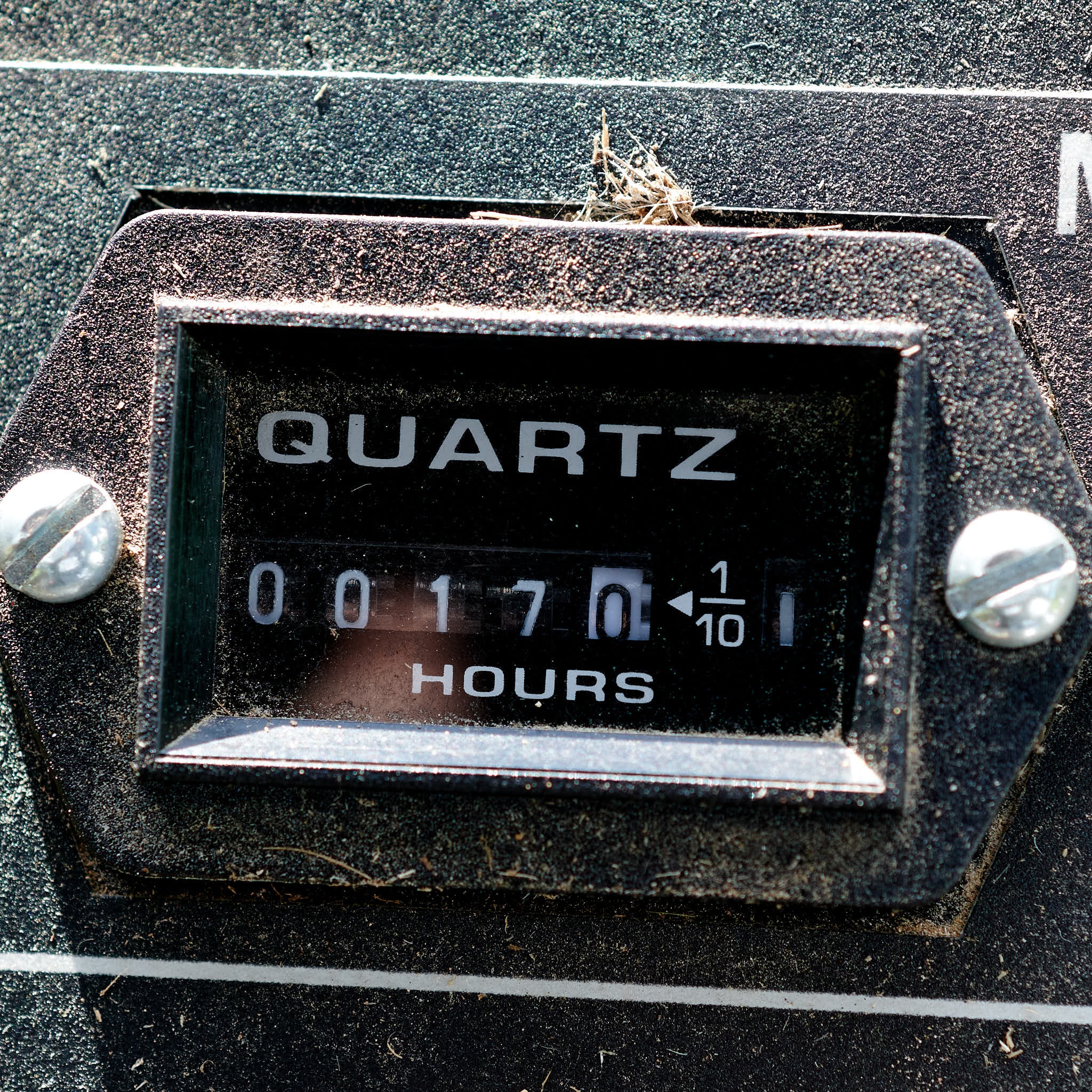

To my eye, it looks like PT used a soft metal bushing without any grease from the factory, and this is what it looks like at 17 hours.
I don't know how hard these blades are, but they are beat up already.

I think that the mower blades are the same metal that PT uses for the bucket edges, and yes, I agree I think that it is not very hard. I do keep my blades sharp and balanced (one blade to the other, and with the center of mass in the same place +/-). I removed the two bolts that weren't being used. Terry said that the bolts were there to keep the blades from swinging all the way around. Other folks(@woodlandfarms?) have put things like hockey pucks on the bolts. I stick to never starting the mower with engine at anything other than idle, and it hasn't been an issue for me.
I have welded material back into the wallowed holes to bring the hole back to the required ID. That plus the McMaster oiled bushings and regular greasing made welding a one time fix. I think I used 7018, but don't quote me. I have used 7018 to fill in large divots in the blades, and to make up for wear along the outside leading edge.

I like the design of the Brush Hog gull wing blades and beefy bolts. I looked into switching to a different and more robust system for blades, and for me it was one of those loose thread issues. You start pulling on a thread, it just unravels. I decided that to run beefier blades, I was going to need to beef up the rotor, the bolt mount, the larger nut to hold the bigger bolts, and to take the stresses of the beefier blades, adjust the height of the deck edge, the wheel height, and the mount. My takeaway was that I decided I would wait until the mower blade wallowing and wear was a problem. With the McMaster bolts and bushings, blade wear has not been enough of an issue for me, so I have just left it. Those, plus a bit of welding to touch up the blades have been more than enough. I haven't bought new blades in fourteen or fifteen years.
