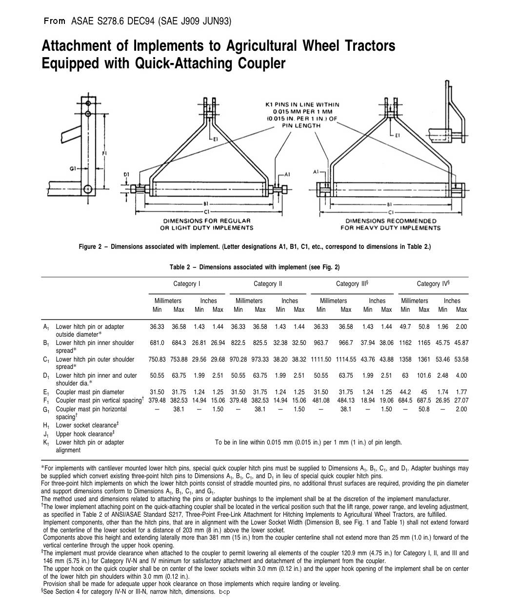

But there is a standard, just because a manufacturer of implements choose to not follow it and do their own dimensions so only their product line fit their I-match does not make the "standard" wrong or invalid....
Best thing QH manufacturers could have done is follow one standard and probably NOT made top hook adjustable and noted specific necessary clearance around hook area, biggest fault in all this is CHINESE QH... Buy it cheap and spending more money buying new hooks and such to make things fit, where is savings.... Only thing Chinese QH did was make some equipment manufactures look real greedy....
Dale

I just sent WoodMaxx an inquiry to see if the wrong lift bracket was sent with the unit. It surely does have a Cat III F1 vertical distance instead of a Cat I.
Thanks for the chart Dale.

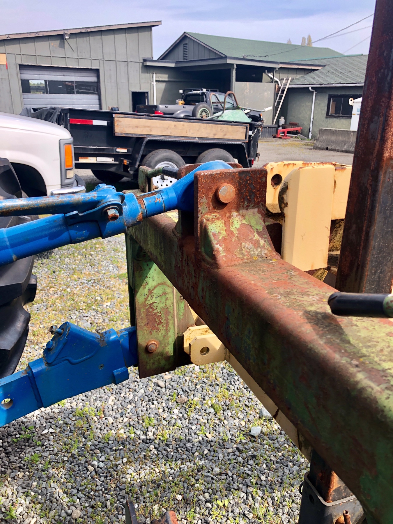

One more trick to defeat a mismatch or interference at the top hook: Get lined up and drop the hook upside down over the implement's top pin. I have one implement that has a horizontal bolt parallel to and below its top pin, preventing the hook from entering. This was my solution.
This still is easier than dismounting the QH and attaching directly because I can lift the implement by its lower pins to drag it out of the weeds before setting the top hook.
Using the hook upside down assumes the top hook is held by push-in pins with hairpins..
(Also shown in the photo - trailer ball drawbar in the QH lower hooks, with anti-rollover straps that are bolted at both ends of the strap. The straps look lightweight but I've pulled a 2600 lb watering trainer over rough ground for several years without bending those straps.).

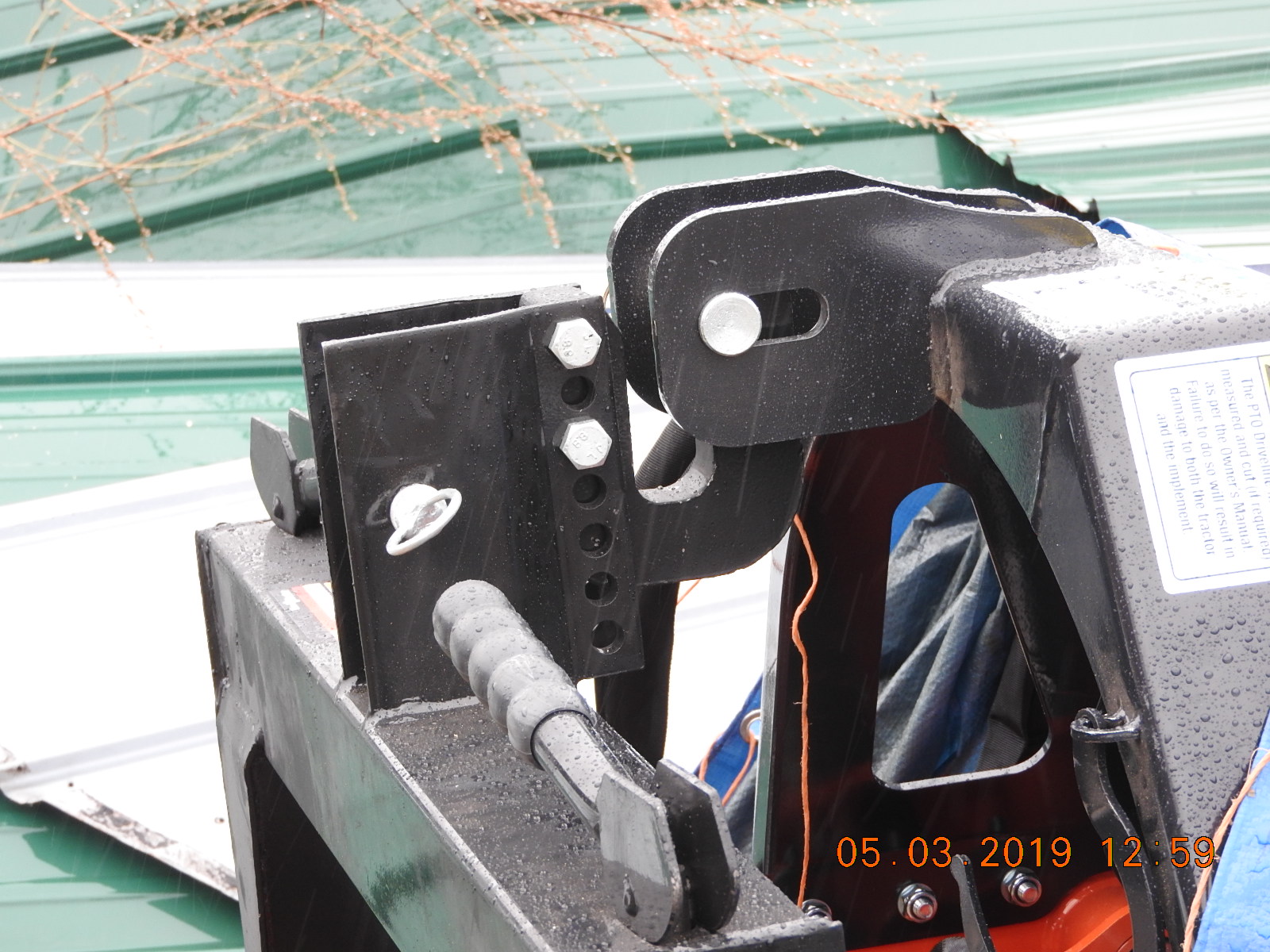

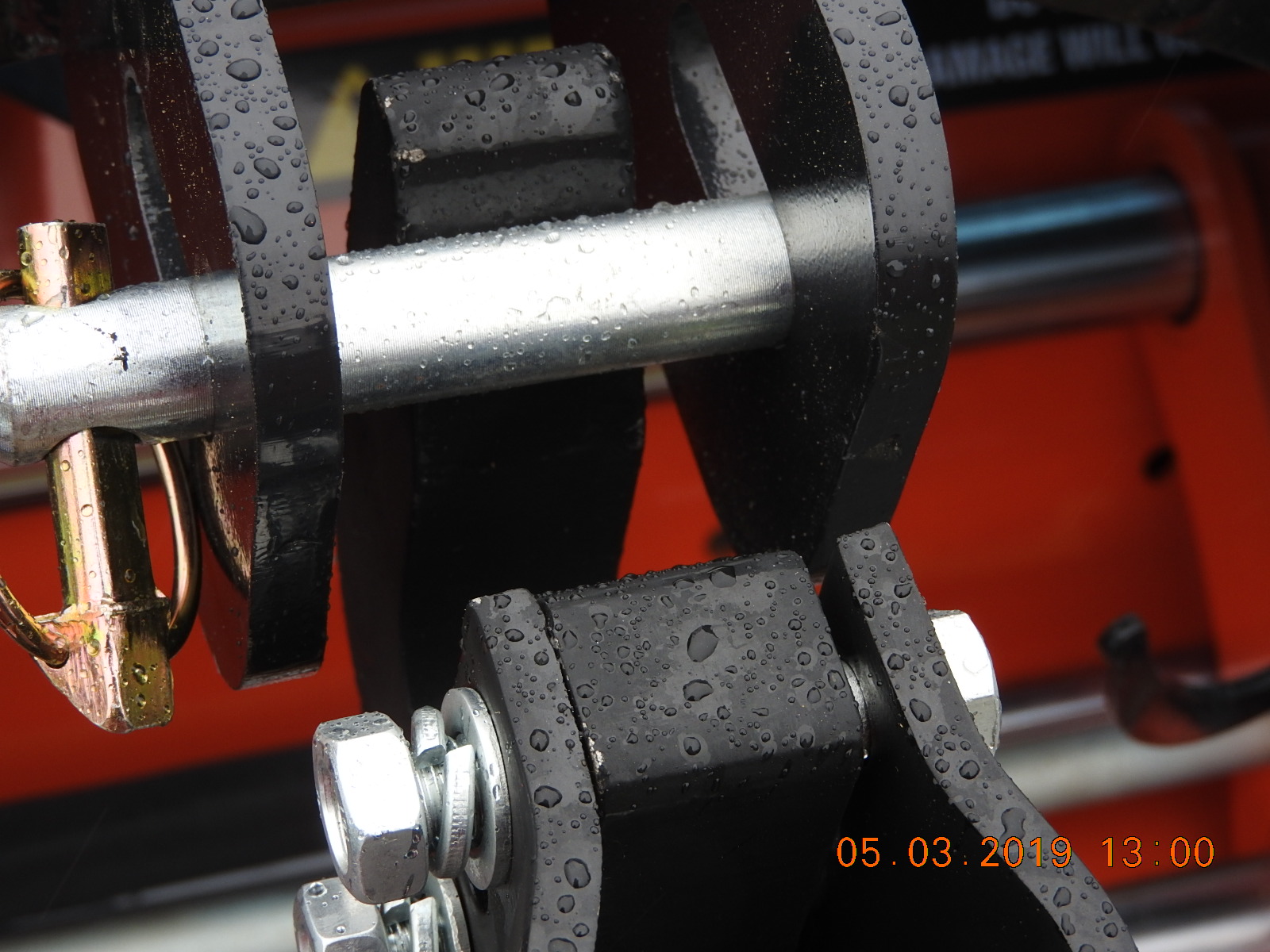

The WoodMaxx guy asked for pictures, here are some that I sent

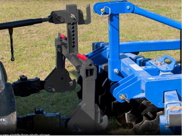

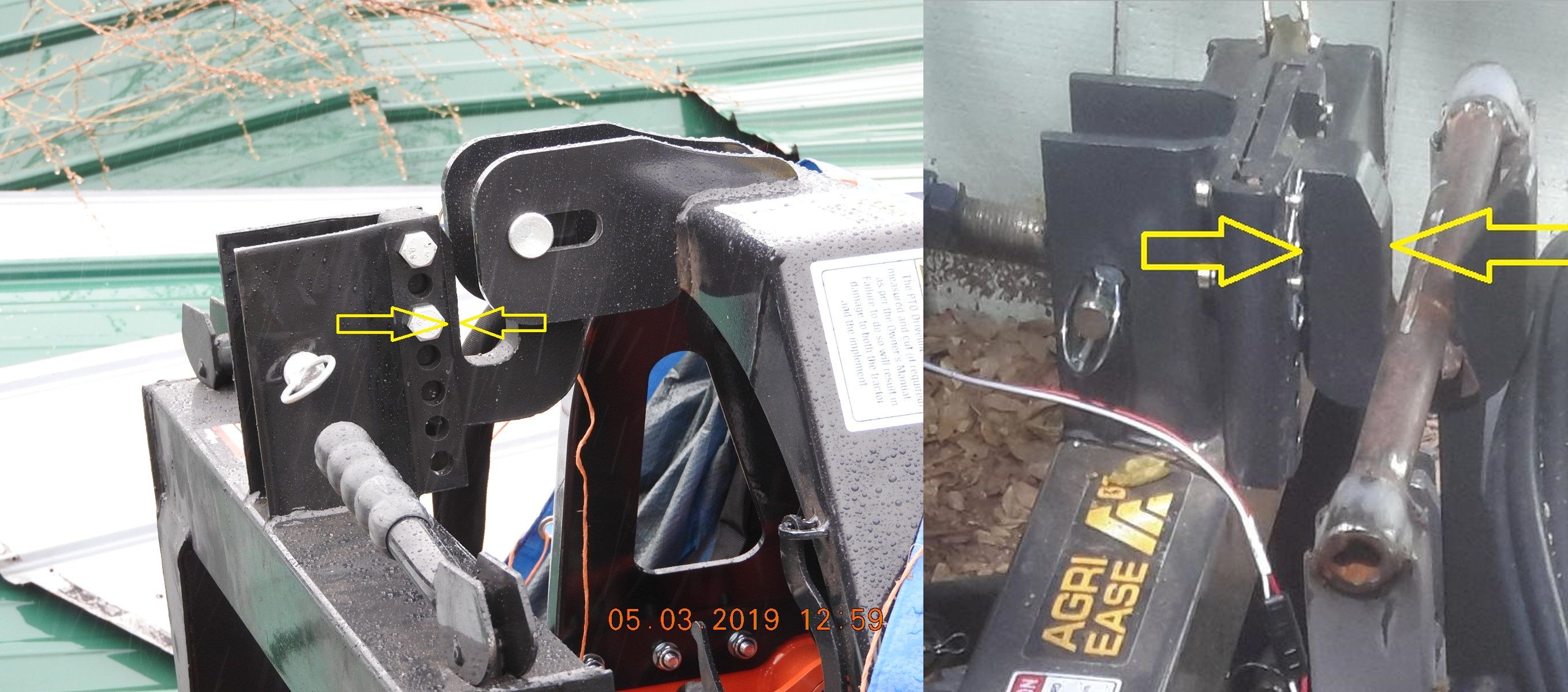

Would seem to me there is another design fault with QH side.... Clearance issue is with hook designed by some Chinese engineer(?) who has never connected up a tractor implement....
Also heard the concept of top hook (maybe with a pivot link) is so implement can not be kicked up (limited) into vertical position and possibly come forward enough to injure operator.... Also heard one can use a chain to allow implement to float (no rigid top link) as long there was some limiting device to prevent "kick up"????

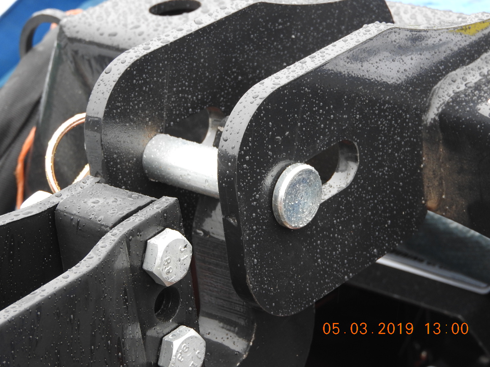

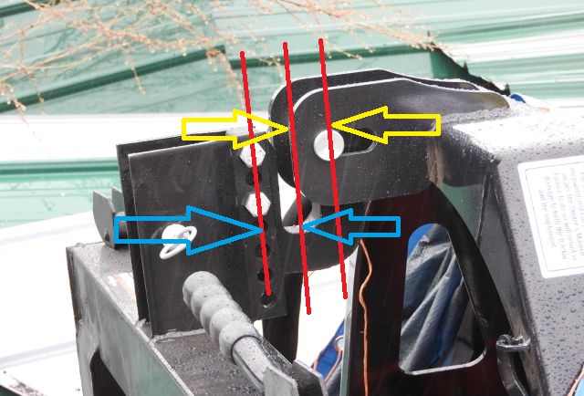

To me. looking at pivot top attachment point look like it going to hit the bolts that holds the hooks when top bar drops on to hook....
Not only does top mount look to high (cat 3) as you see it, it also looks like space between bottom of hook and bolts that hold hook to mount is two small to accept top attachment point of implement...

OK, I see now. I didn't think about that, I was focusing on the height issue. I'll have to see if the gap is wide enough. If not I guess I need to get the "fork" regardless.

This interference is why Threepoint has the extra hooks he mentioned at start of this thread. The replacement hooks project out farther so bracket on the implement do not contact the bolts.
Bruce, you could gain 3 advantages by modifying the existing hook by welding a piece of bar stock with holes drilled to match the existing pattern to back side of the hook to move the hook back plus make the bar stock slightly longer to accommodate 2 more holes lower down to raise the hook higher for the flail mower. By having the hook moved outward you could use hitch pins to quickly change hook height versus wrenching on the bolts.

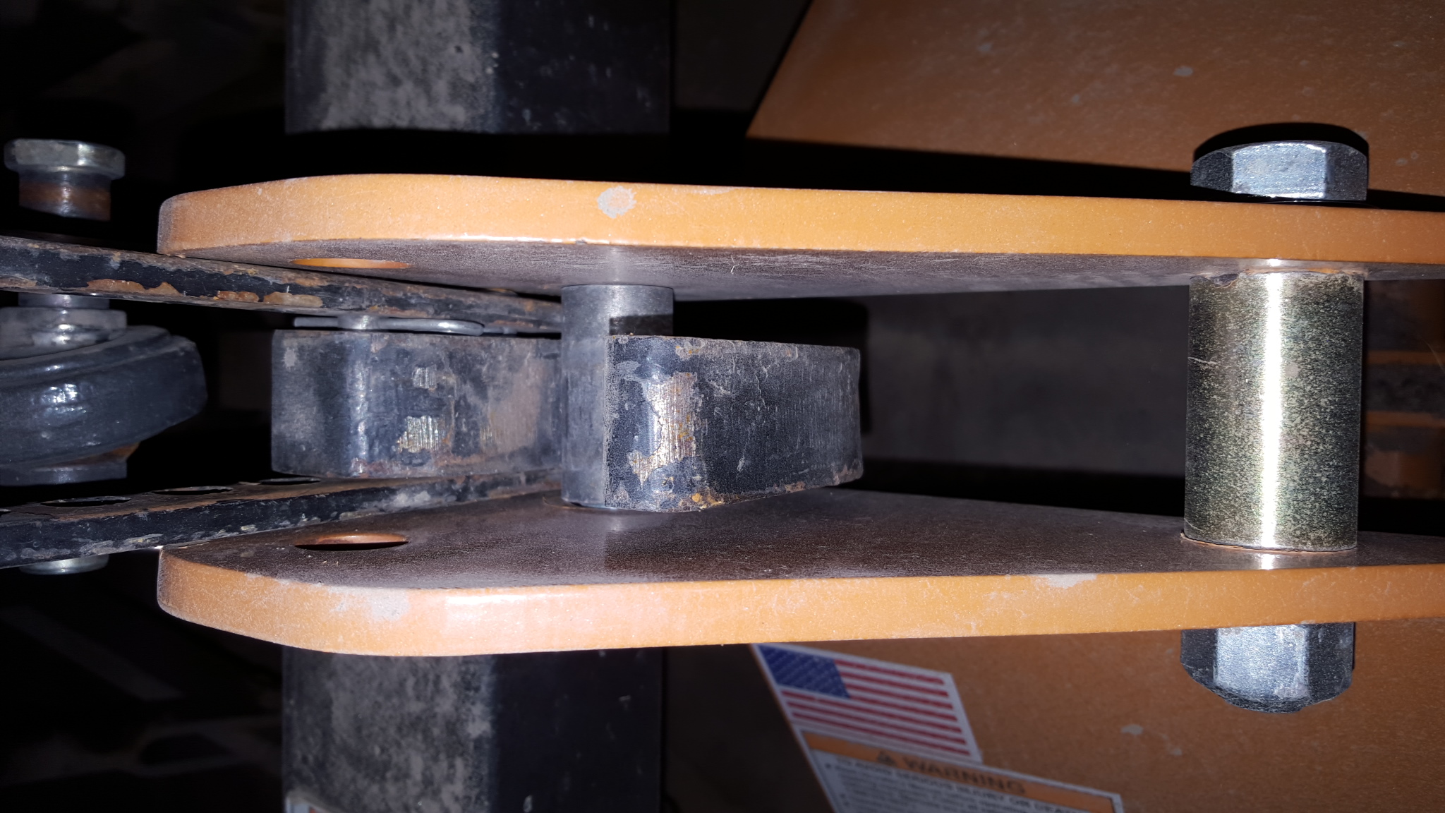

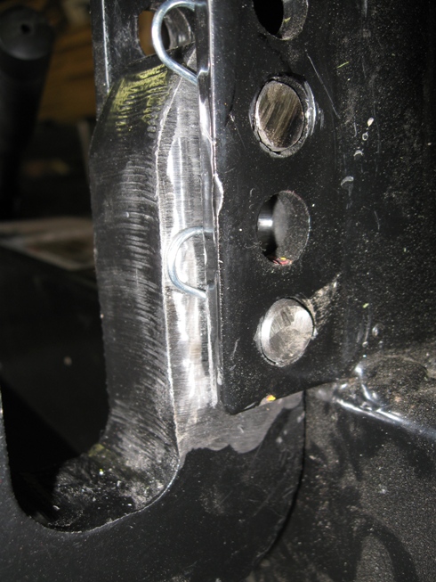

Dale's pic is a good one to show the clearance problem with the bolts that the after-market extended top hook is intended to address. However, even without switching to an aftermarket top hook, or welding an extension onto the back of the OEM top hook, there is an easy mod that solves the problem. And no welding required. With a hacksaw, cut the hex heads off the two bolts, then trim the bolts' shanks to length so that the ends are flush with the outer walls of the hitch's bracket.
Next drill a small hole through each bolt near one end so that a small hairpin clip can be inserted through it between the inside wall of the bracket and the top hook itself. Now there are not protruding parts of the bolts to interfere with the implement's top bracket if it needs to slide over them. See pics below of my mod of my original HF top hooks. In fact, the mod works so well that I use the same modified "pins" to secure my new extended top hooks, even though it isn't necessary so far with my current implements.
The conversion of the bolts to flush pins was an idea originally posted by Kennyd, another TBN member, several years ago. Ken now sells an extended aftermarket top hook of his own on his website.
