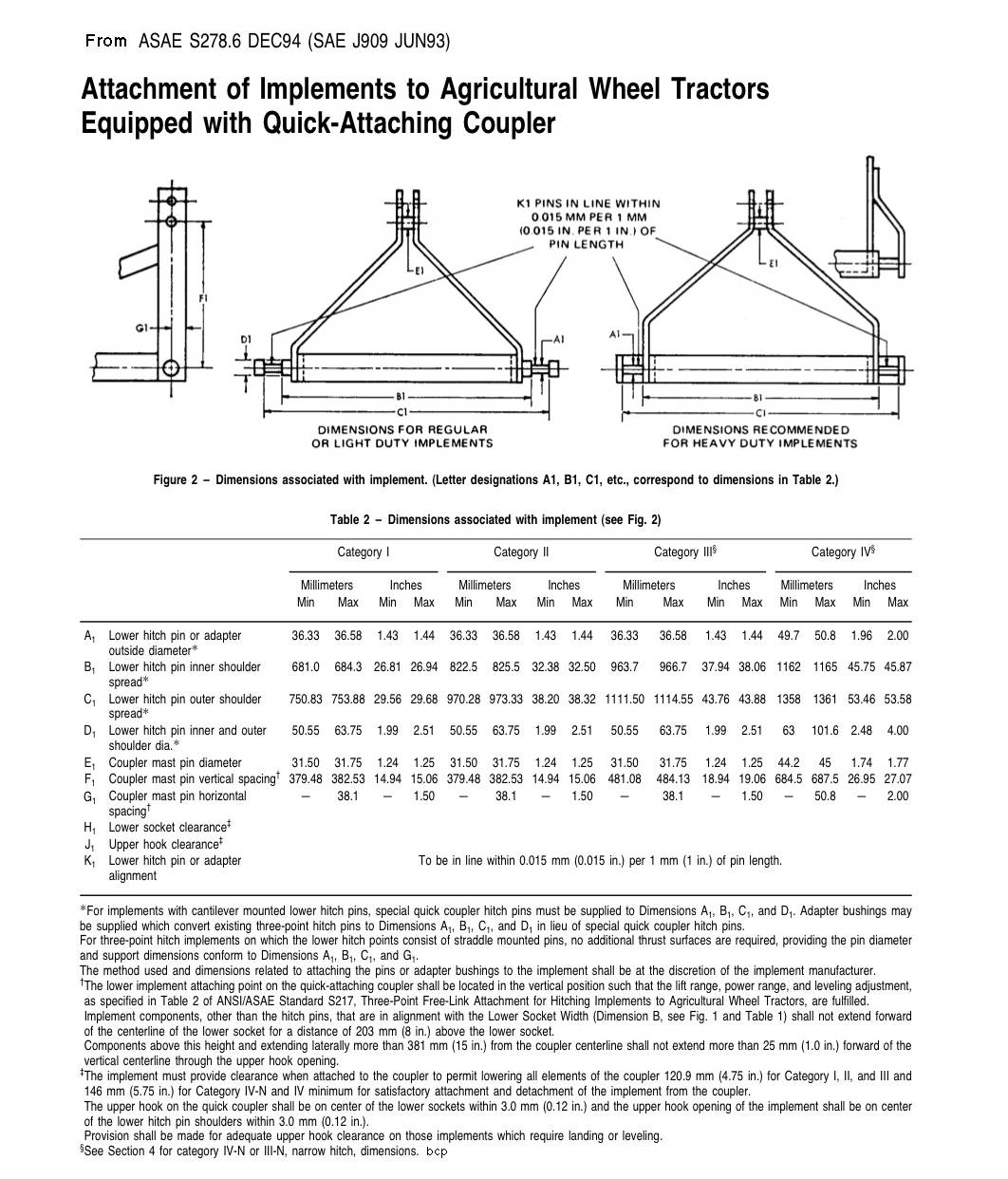

But there is a standard, just because a manufacturer of implements choose to not follow it and do their own dimensions so only their product line fit their I-match does not make the "standard" wrong or invalid....
Best thing QH manufacturers could have done is follow one standard and probably NOT made top hook adjustable and noted specific necessary clearance around hook area, biggest fault in all this is CHINESE QH... Buy it cheap and spending more money buying new hooks and such to make things fit, where is savings.... Only thing Chinese QH did was make some equipment manufactures look real greedy....

I just sent WoodMaxx an inquiry to see if the wrong lift bracket was sent with the unit. It surely does have a Cat III F1 vertical distance instead of a Cat I.
Thanks for the chart Dale.

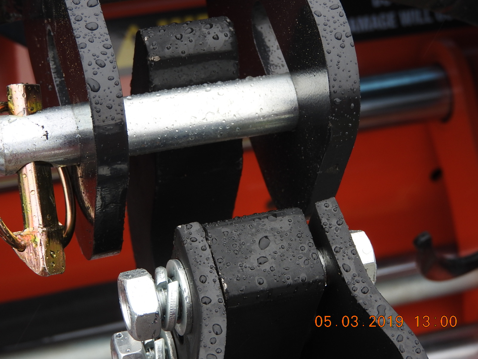

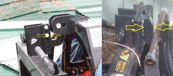

The WoodMaxx guy asked for pictures, here are some that I sent

Would seem to me there is another design fault with QH side.... Clearance issue is with hook designed by some Chinese engineer(?) who has never connected up a tractor implement....

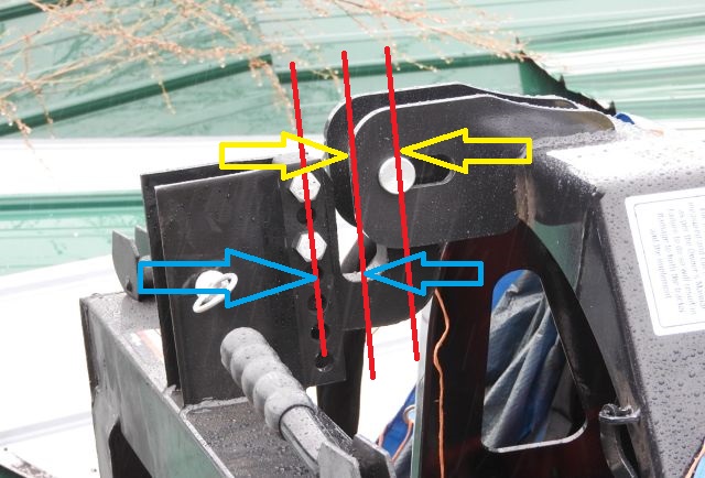

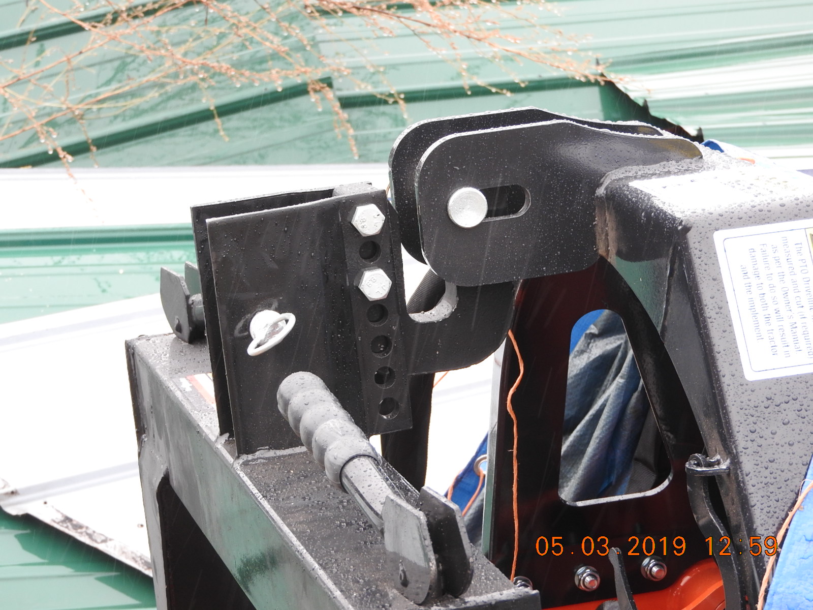

I'm not sure I understand the "clearance issue" Dale. The picture was taken with the mower's cat 1 pins in the QH's cat 2 "hooks". The mower is still in its shipping "crate" with one side removed so I can connect it to the tractor to pull it out and finish the setup. The mower's lower pins are sitting in the QH's lower hooks and the QH's top hook is just barely high enough to contact the top pin at all. If I take the pin out, the QH pivots away from the mower.
I know I'll need bushings to bring the pins on the mower and rake up to Cat 2 size. Seems like companies would make Cat 1 quick hitches since it is unlikely people with Cat 1 3 points, and the smaller tractors they are put on, would be buying Cat 2 implements. Instead there is a big market for bushings to "fix" the mismatch.
I'm hoping the service guy at WoodMaxx is going to look at the pictures and say "****, they put the wrong arch in the crate" and send me the proper one. They do make an 88" and a 96" mower that are Cat 2. I think they've sold plenty of the 3 models of Cat 1 mowers and if they all had the same F1 spacing it would have been noted some long time ago. Maybe not.

To me. looking at pivot top attachment point look like it going to hit the bolts that holds the hooks when top bar drops on to hook....
Not only does top mount look to high (cat 3) as you see it, it also looks like space between bottom of hook and bolts that hold hook to mount is two small to accept top attachment point of implement...
Dale

OK, I see now. I didn't think about that, I was focusing on the height issue. I'll have to see if the gap is wide enough. If not I guess I need to get the "fork" regardless.

This interference is why Threepoint has the extra hooks he mentioned at start of this thread. The replacement hooks project out farther so bracket on the implement do not contact the bolts.
Bruce, you could gain 3 advantages by modifying the existing hook by welding a piece of bar stock with holes drilled to match the existing pattern to back side of the hook to move the hook back plus make the bar stock slightly longer to accommodate 2 more holes lower down to raise the hook higher for the flail mower. By having the hook moved outward you could use hitch pins to quickly change hook height versus wrenching on the bolts.
