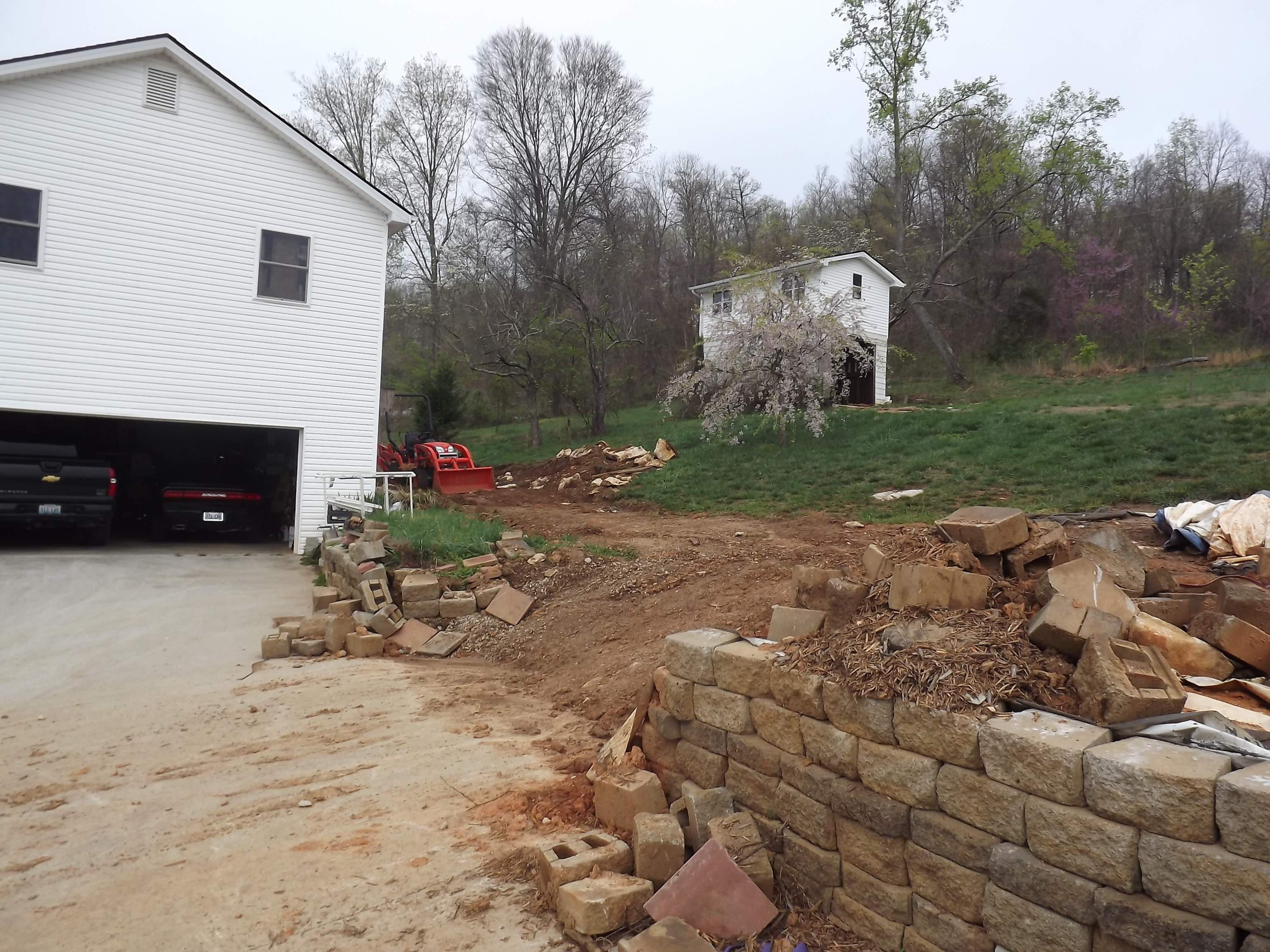

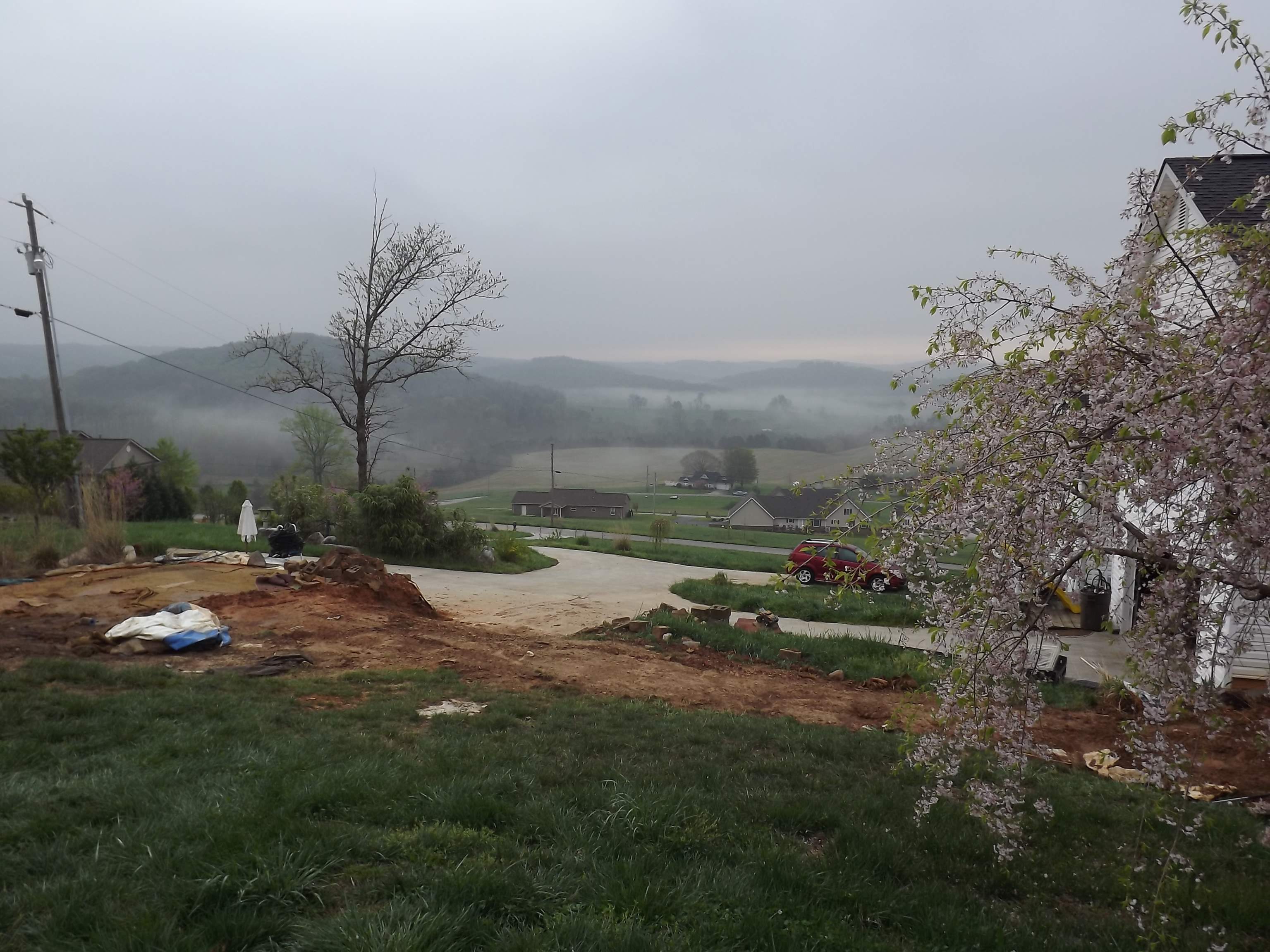

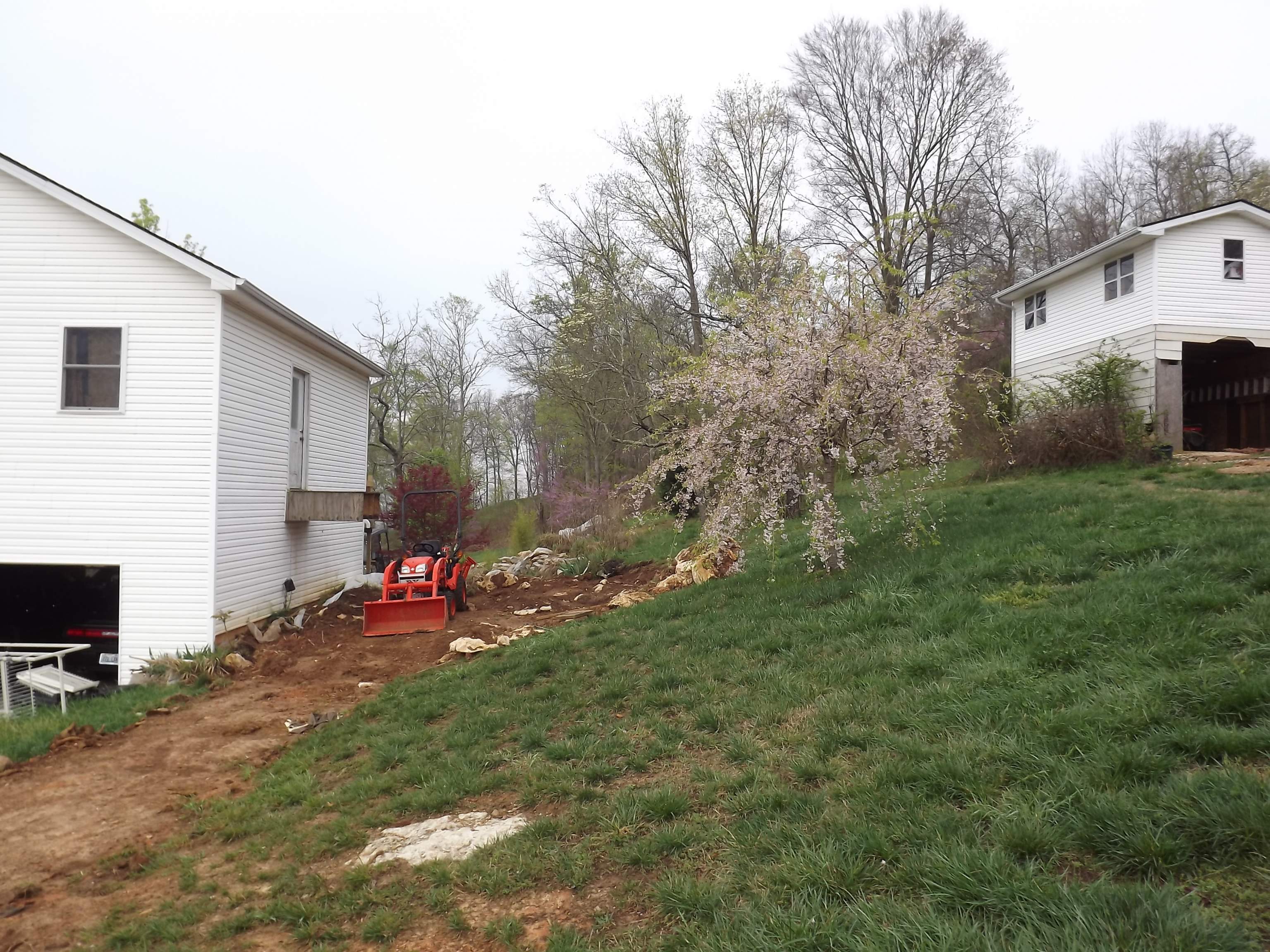

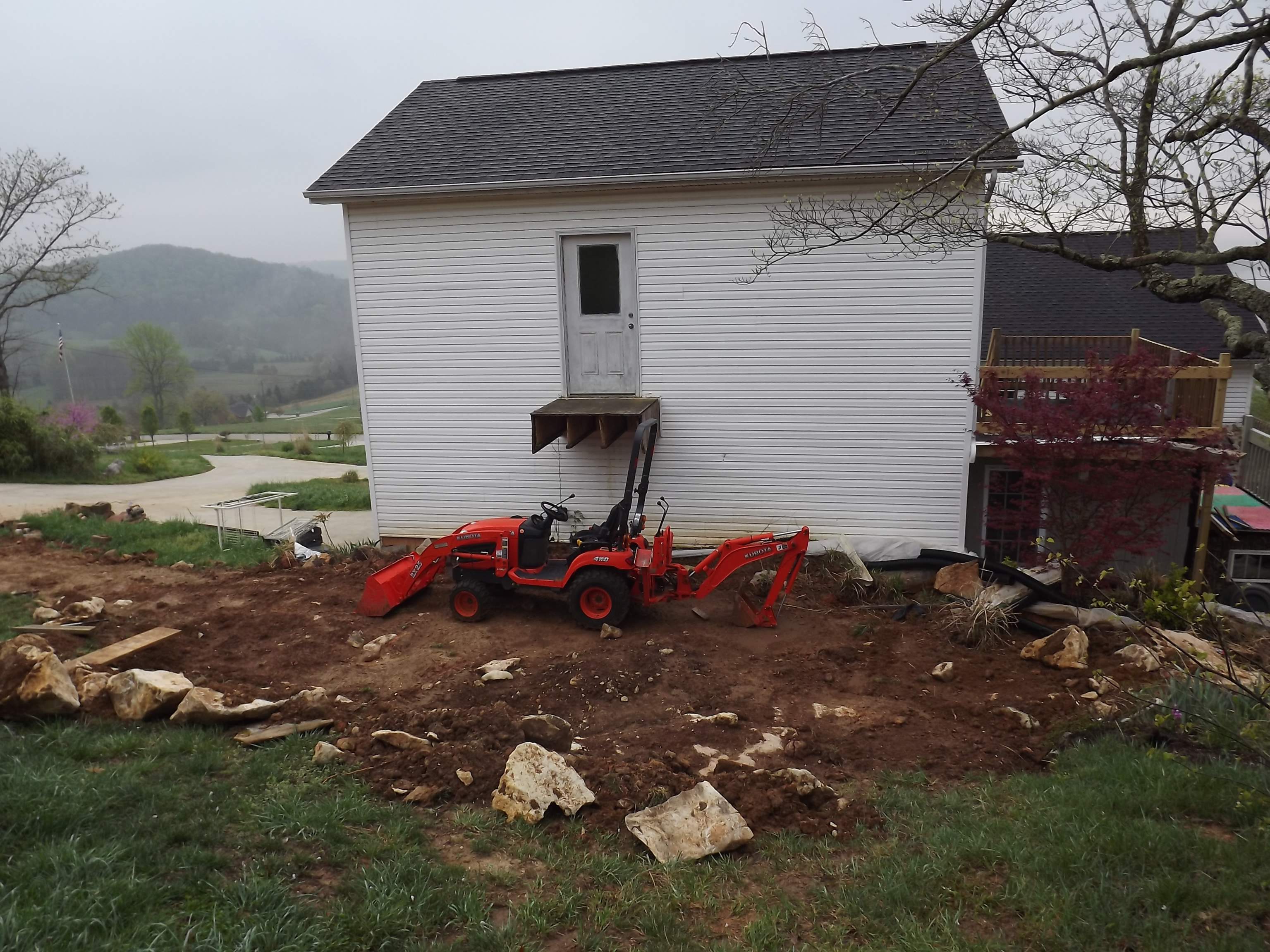

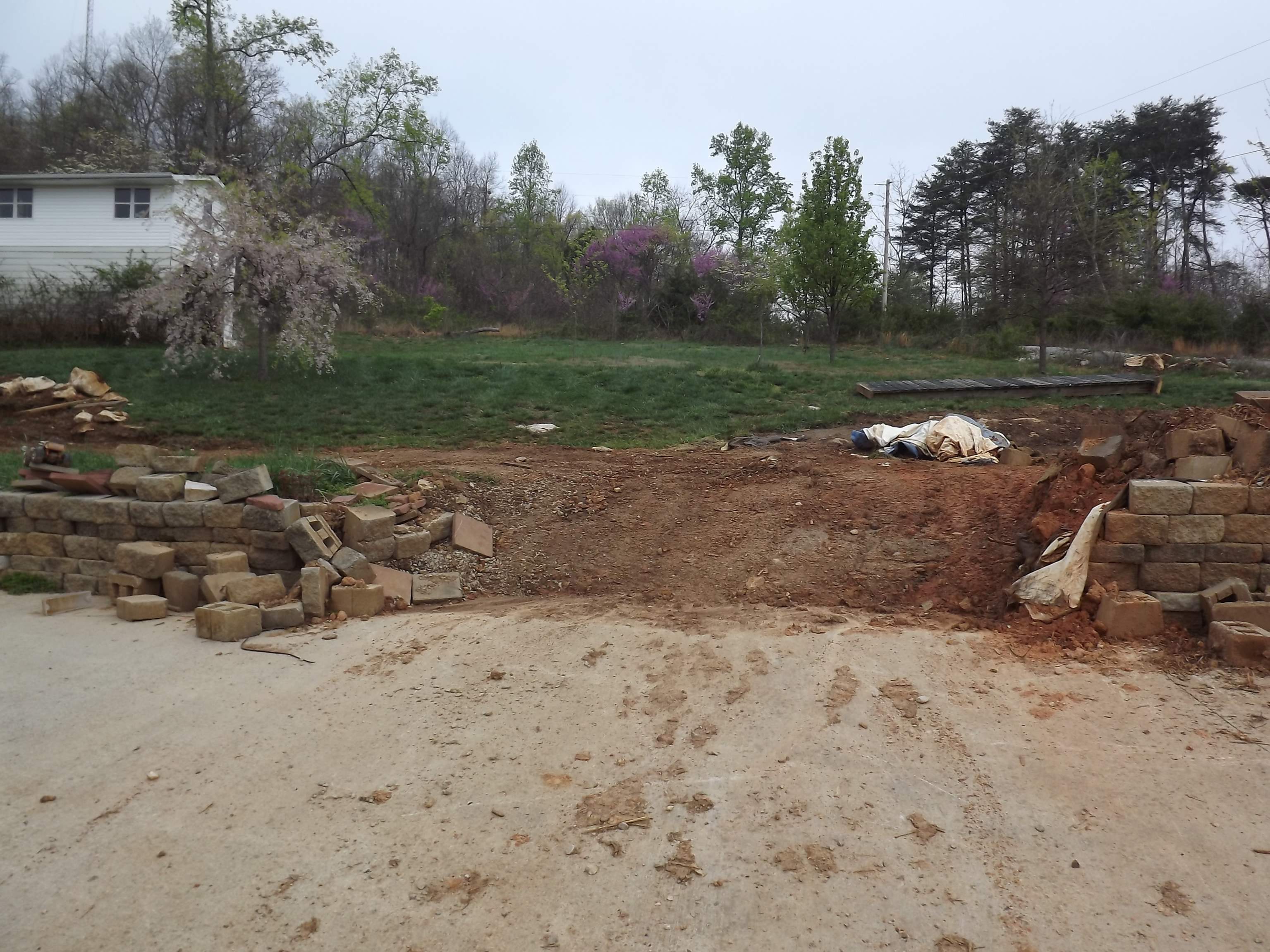

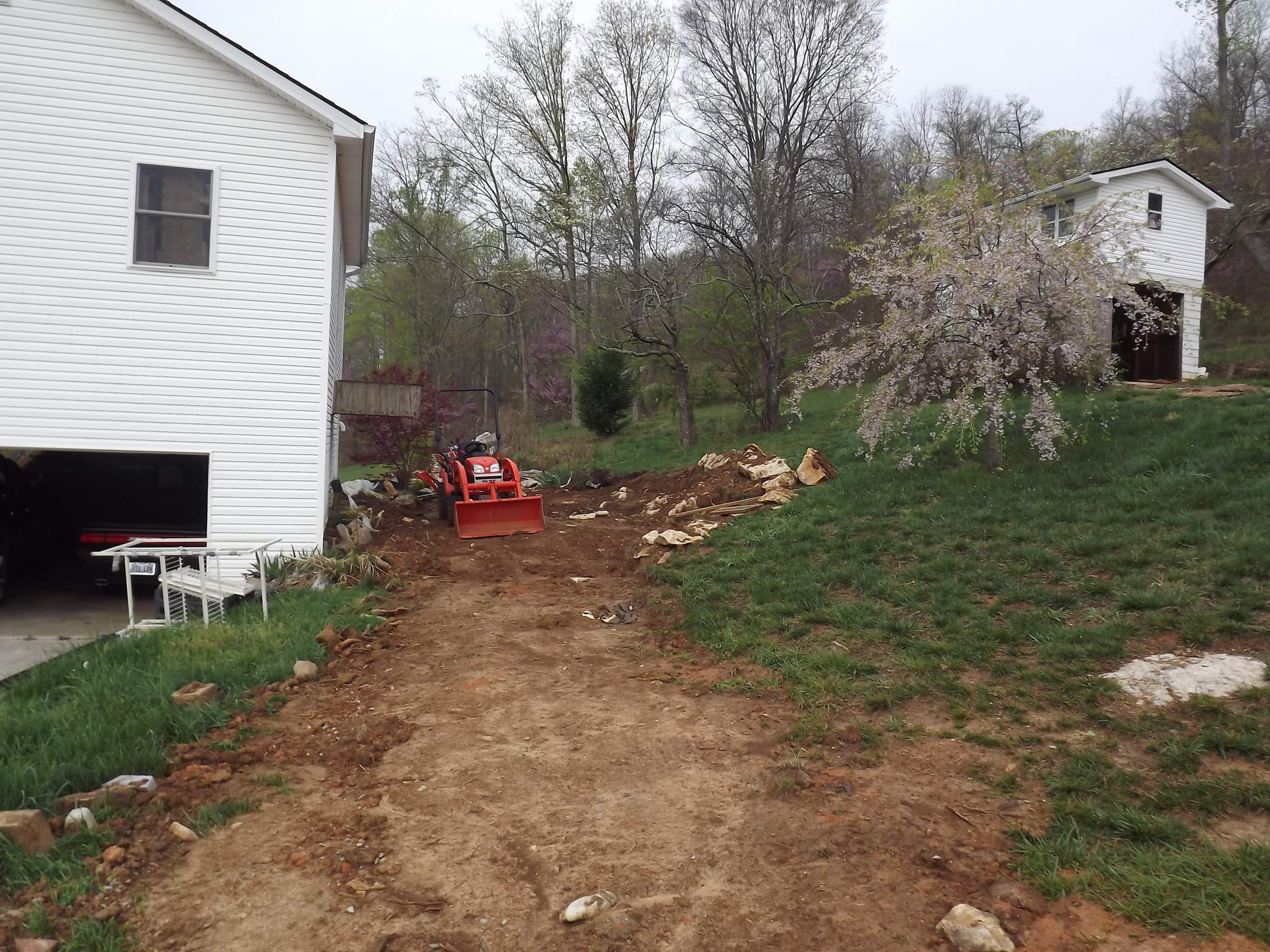

I currently have a BX25 which is a BX2360 with the factory installed FEL and BH. It is an excavating giant, I'm building an additional garage on the side of my current garage but my garage is 4'under ground on the upper side where I'm building the addition. I've had to cut the hillside out to make the 16'x26' flat spot and level out the drive into the new garage space. Lots of near bolders have had to be removed with my BX. I've flattened it and laid in 16 tons of gravel which I had to haul in because the truck bringing the gravel got stuck turning around and had to dump his load on up my hill.
Called a Concrete contractor to come give me labor price to pour the garage and drive. He measured, looked around and gave me the price then we man chatted for awhile.:) He told me Steve Barlow was "offering" to sell him a used B21 and had been for a bit of time and that he was going to go on out to Barlows and buy it. The B21 is a bit bigger with a bit less HP than my BX25. He said that he was so impressed with what my BX25 had done that he wanted the B21 for his work. Asked Steve Barlow Saturday if John A had bought a B21 from him last week and he said he did and that John A had told him how impressed he was with what my BX25 had done. John A has been in the Concrete Contracting business for years from small jobs to Commercial Jobs (Wal Marts, Factorys, etc).
So, to answer your question about excavating with a BX, yes but much better and quicker with the BH. I have done most of mine with just the FEL because that's what I had before I got the BX25 a couple of years ago.
