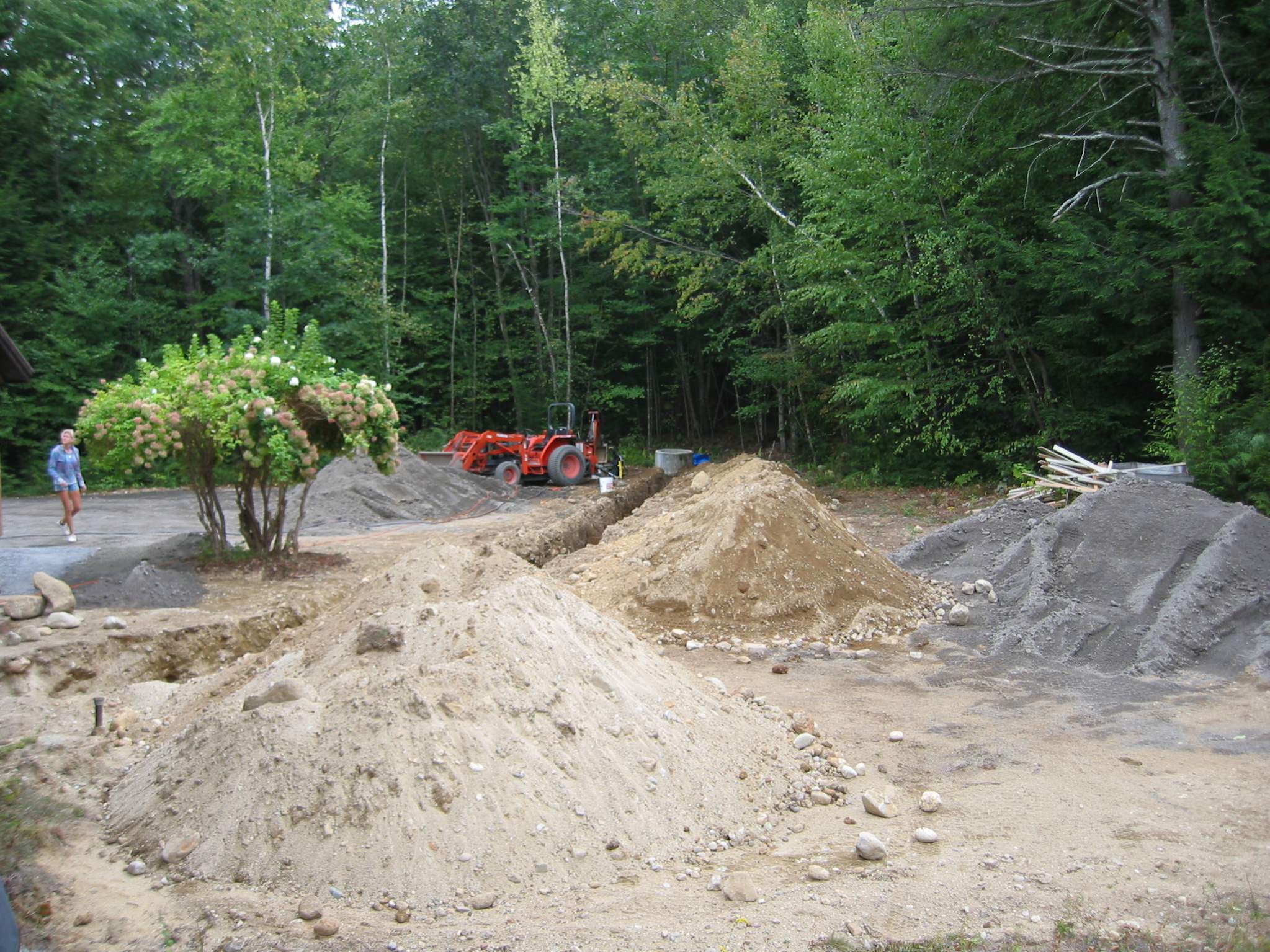

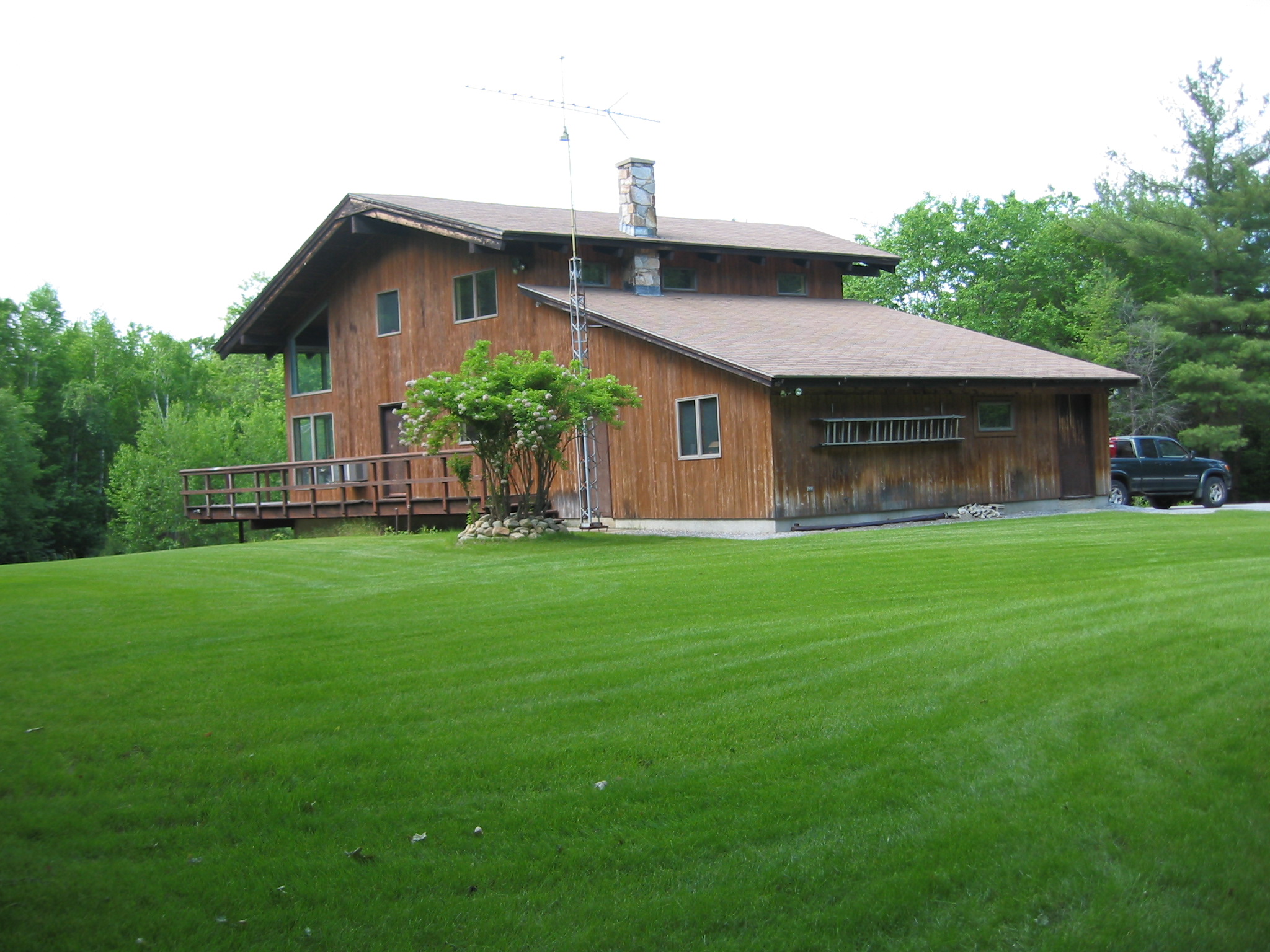

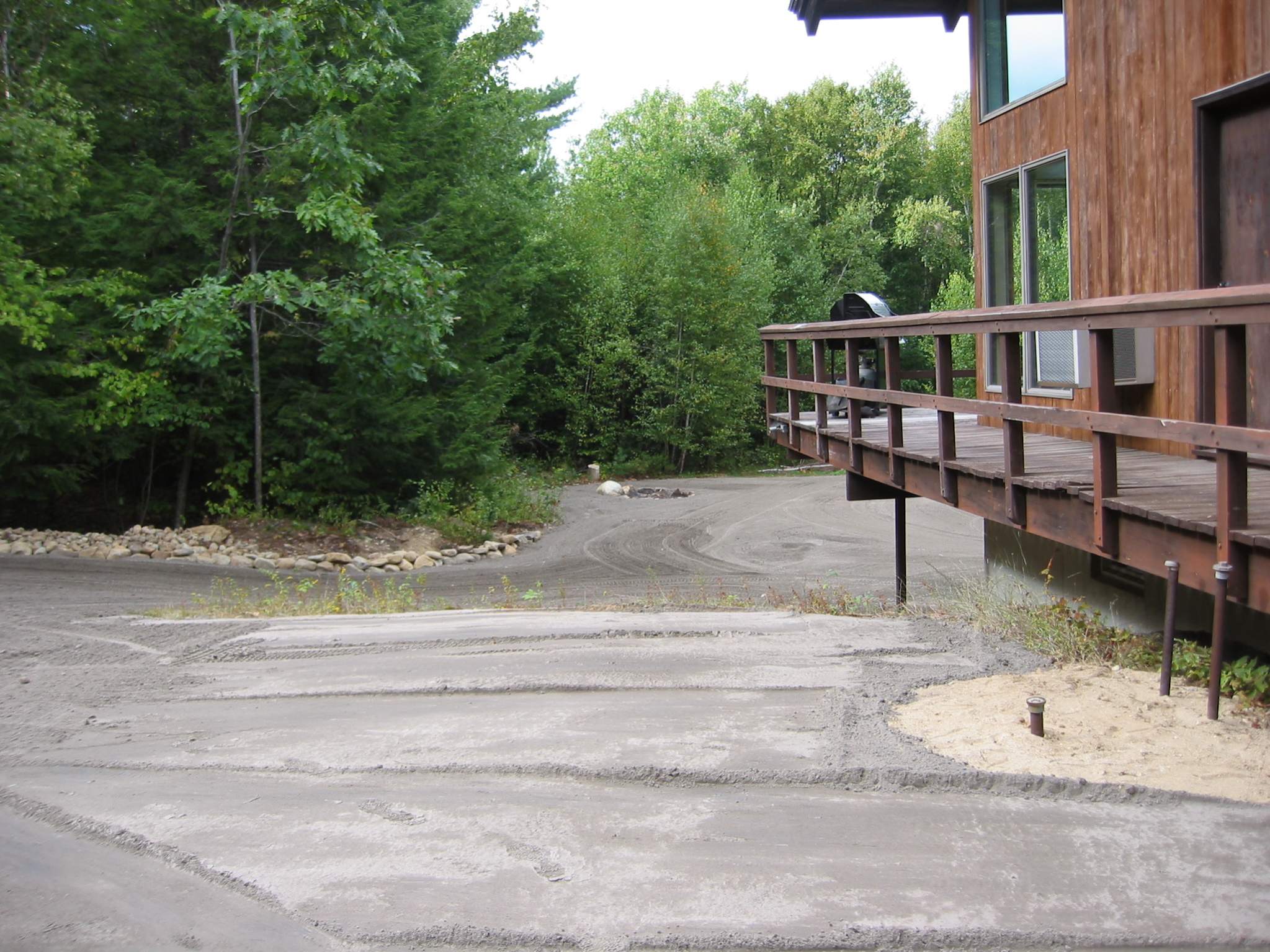

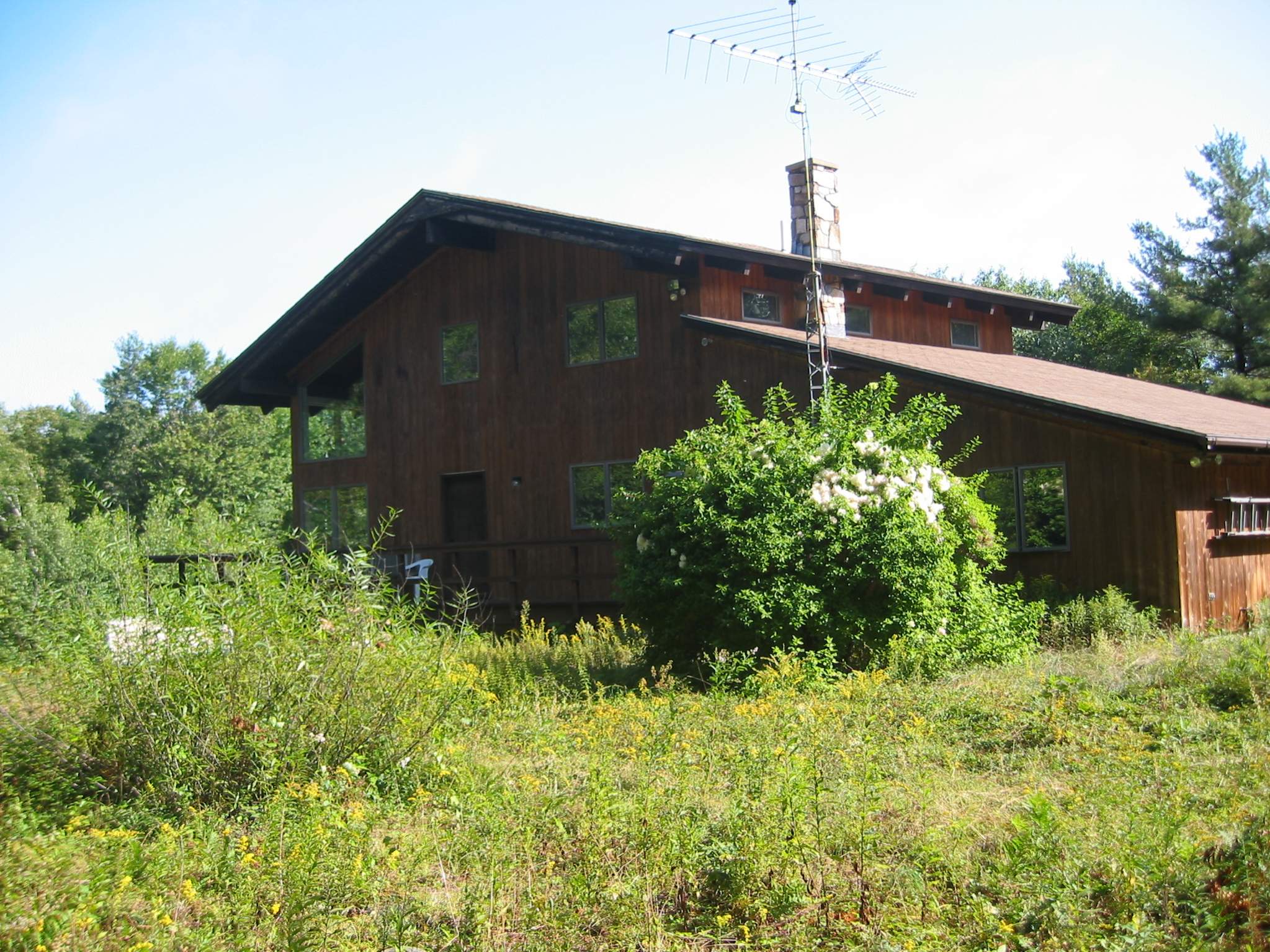

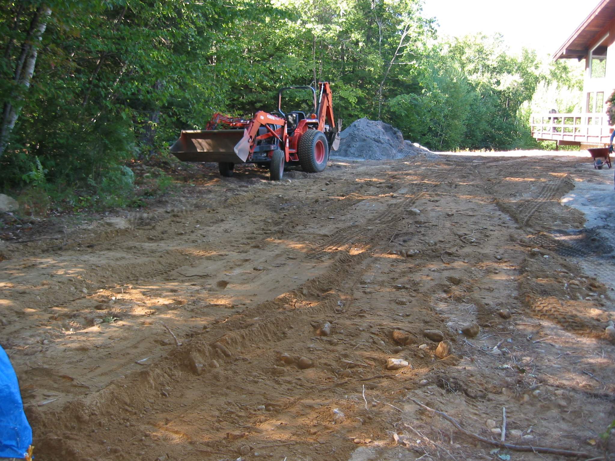

I recently reclaimed some rough areas at my camp using nothing more than my FEL and a york rake - I'll attach a before, during, and after pic for your entertainment. Dirt work was done over the summer (I made a rock pile the size of a pickup truck - also re-ran my well line just to abuse myself), I seeded in the fall, and the finished pic is the following spring (2 months ago).
JayC
PS - notice how cool my L4200 looks?
