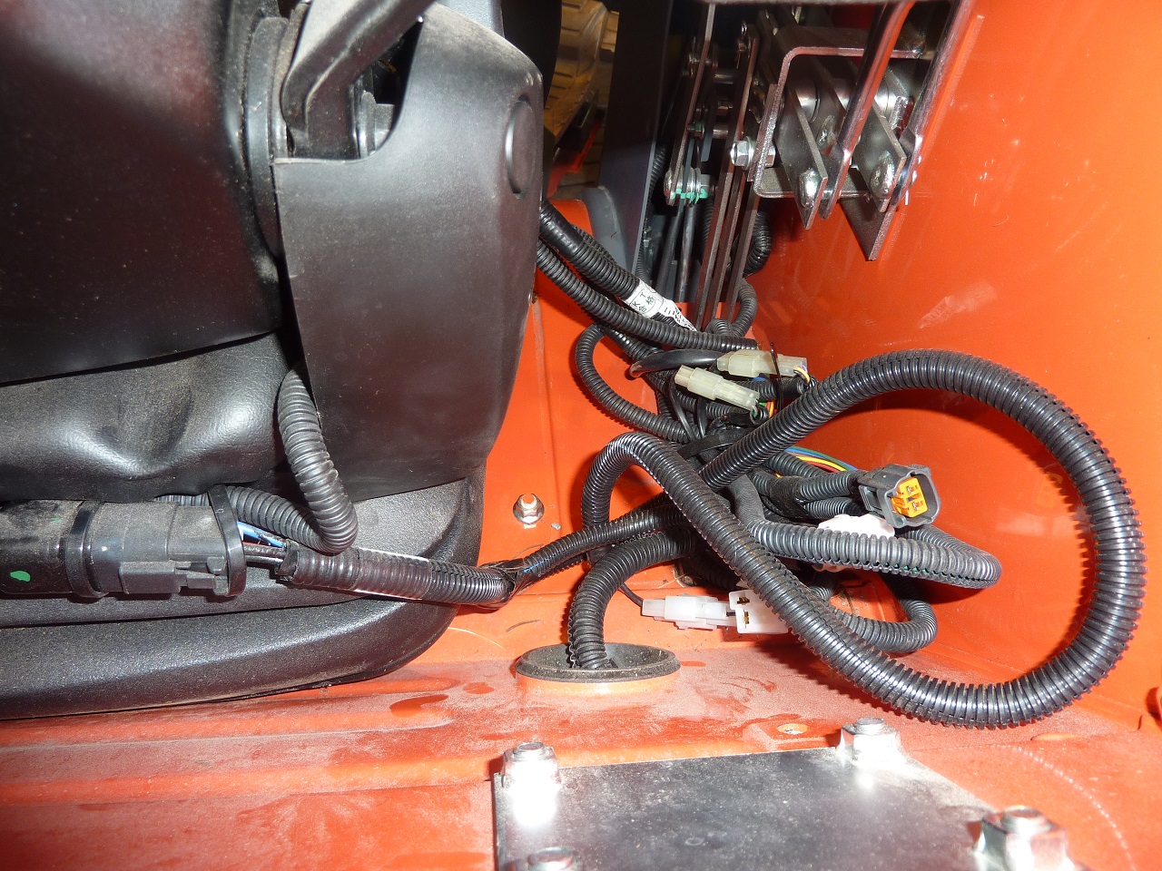

Ok, here is the fix for using stationary implements on a ROPS model L6060 with the OEM (Grammar) air ride seat. It should work for other 60 series and cab model tractors as well. The process took about an hour.
First remove the wiring harness cover below the right fender console. P1060452a.jpg

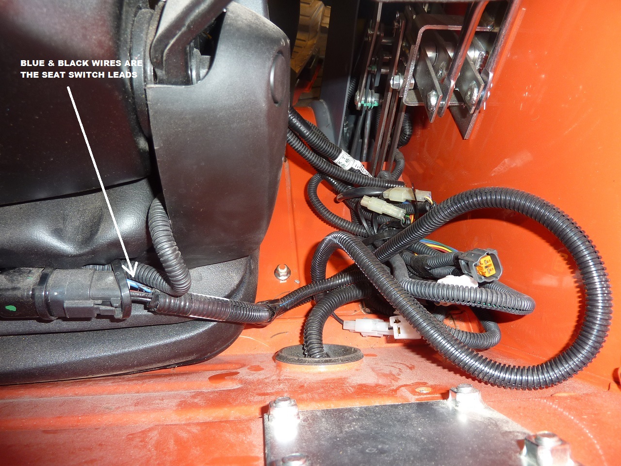

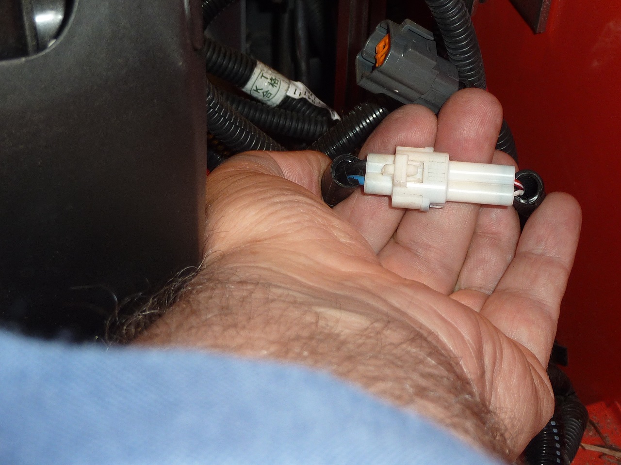

Locate the 2 pin connector with the black and blue wires leading to the seat. P1060453a.jpg

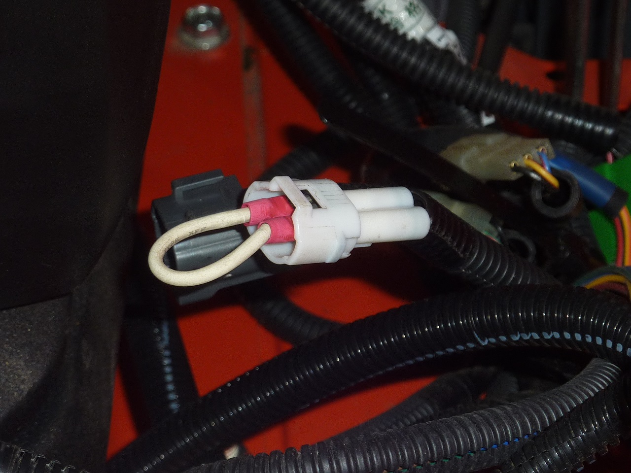

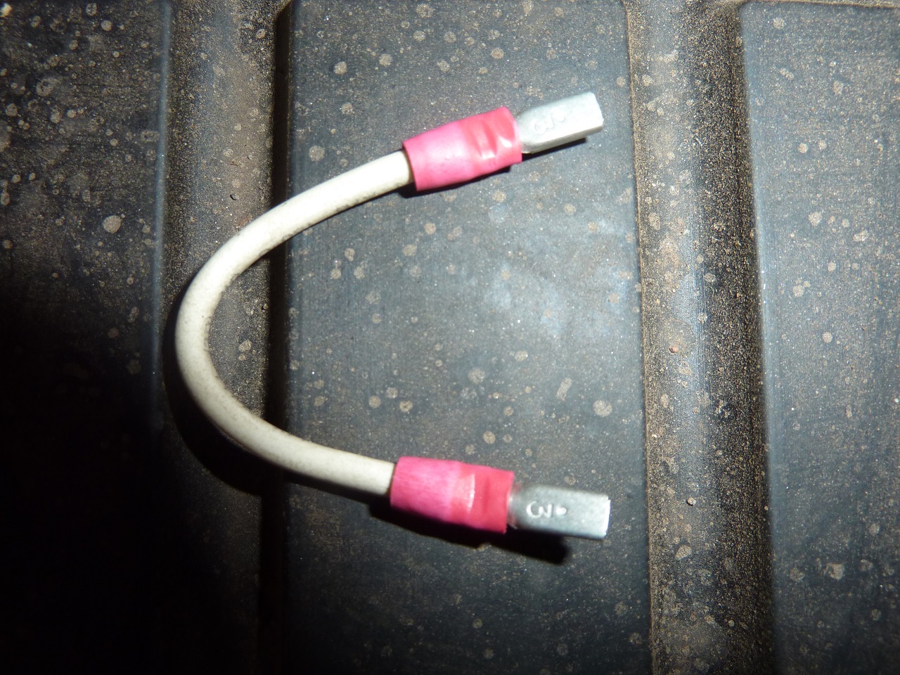

I made one using 2 - #3 female spade connectors.
With a little adjustment, they fit the tractor connector pins snugly. P1060459a.jpg
I chose to do it this way so as not to modify the tractor wiring harness. P1060452b.jpg
Pull the jumper, snap the connector back in place and the tractor is OEM.
If you wish, you can cut open the wiring harness behind the seat.
Short the blue and black wires to bypass the seat switch.
Make sure you use the correct black wire since there are two of them.
