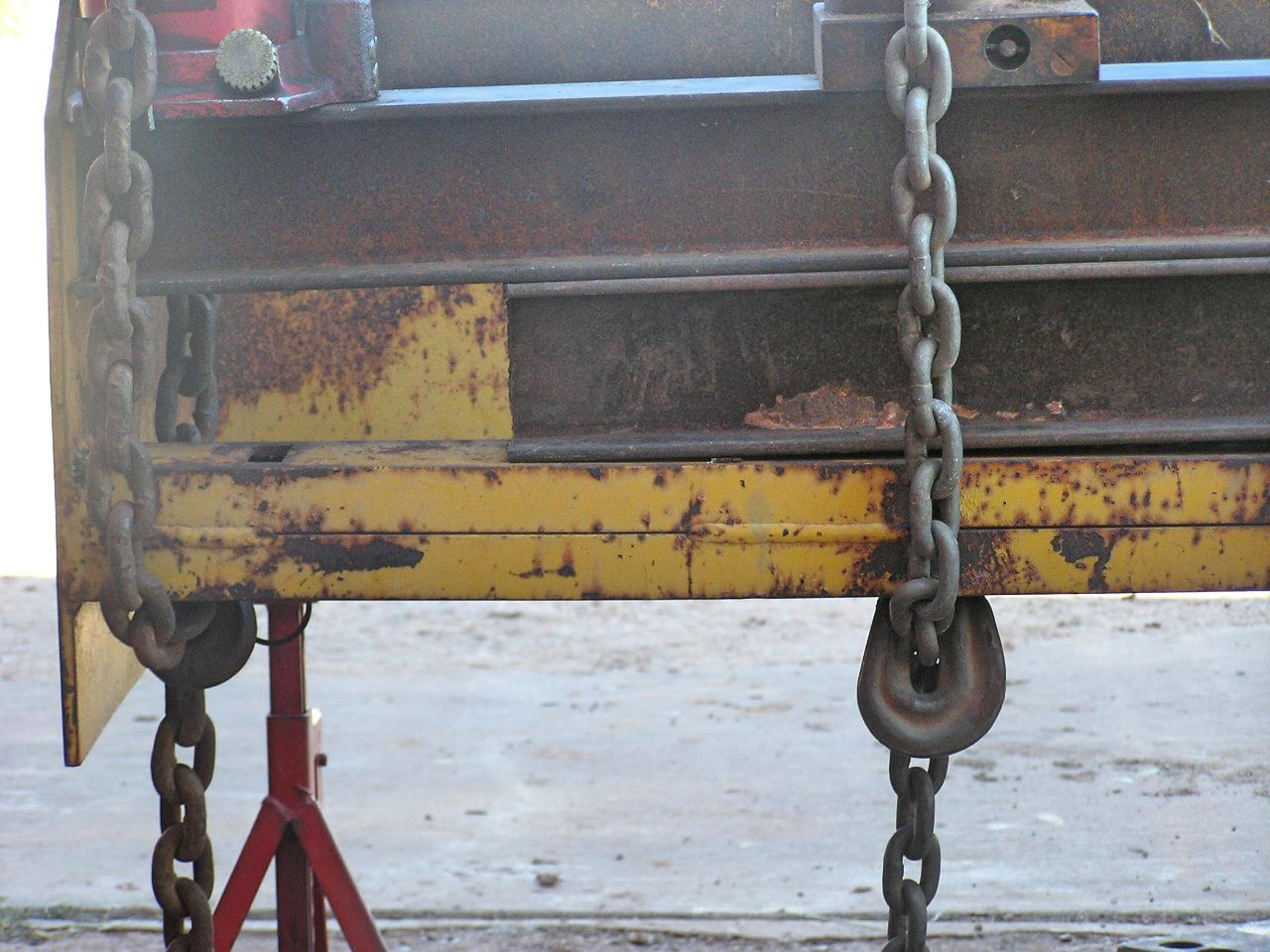

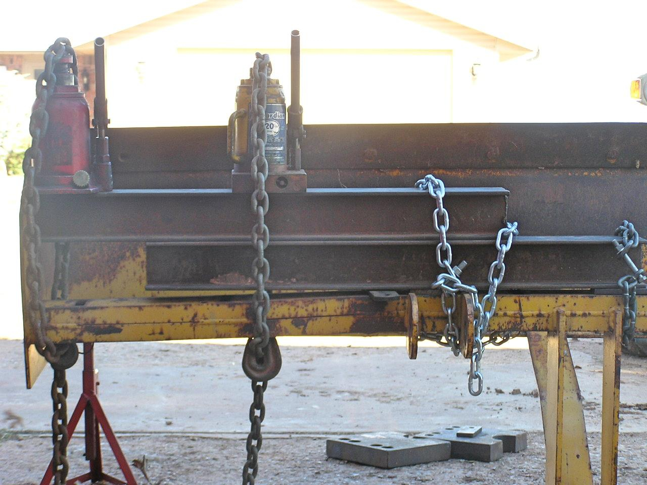

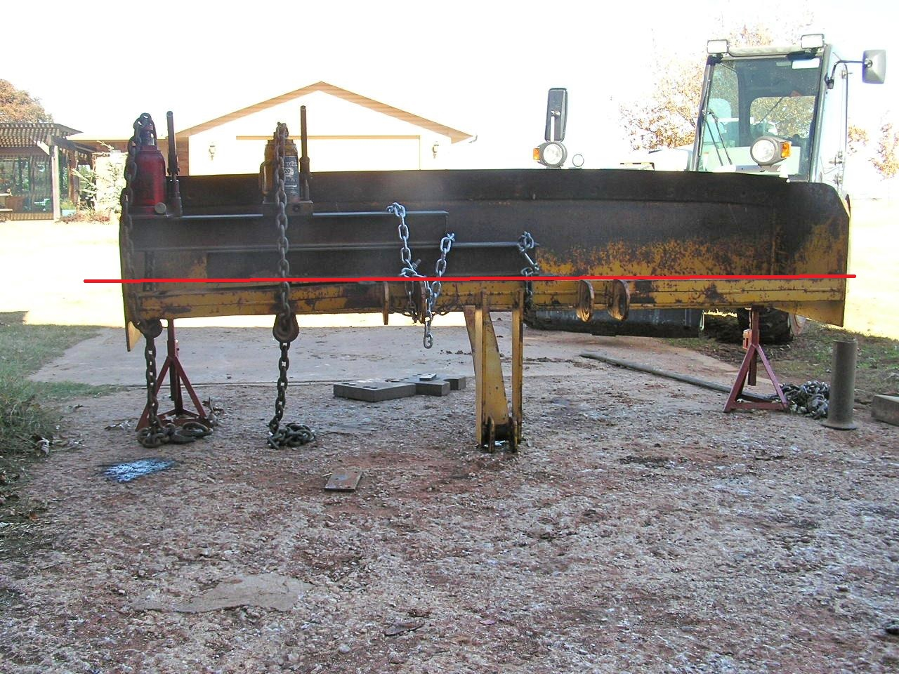

That box blade is pretty well whipped out. Should have hard rodded the lower leading edge before it wore away.
It was like that when I bought it. Paid $350 12 years ago because it was bent:
Straightened it:
