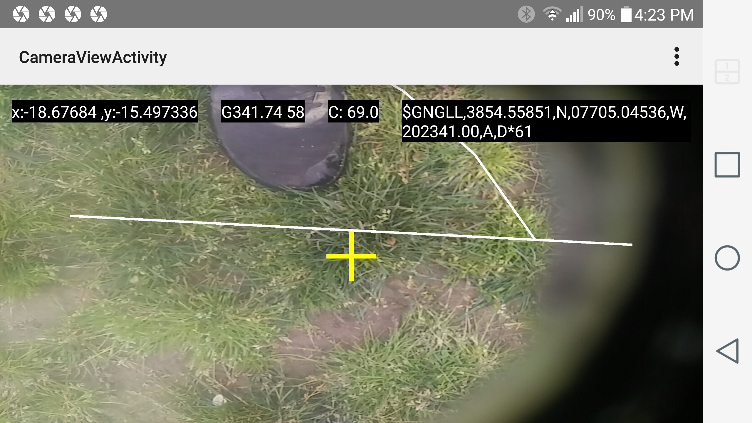

Thanks Dave. I wouldn't dream of using this for boundary surveying or anything where anything real is at stake. That said, I have a 300' tape measure that I use all the time, the idea of being able to draw a line on a map on my computer and then being able to go out and walk that line just seems like it could replace a lot of the things I use that 300' tape for. I could see using it for fencing, planting trees, plowing rows, etc. I doubt I'm getting 1" accuracy with the tape anyway. I built a 96' greenhouse with 25 hoops and I would have loved to get 1" accuracy placing those hoops.
What got me started on this thread was an earlier thread about using laser sensors to set the height of a box blade. There's a lot of possibilities for automated control once you can determine your location relatively accurately. I haven't even thought about what you could do behind the wheel of a tractor. The ultimate project would be some sort of autonomous vehicle, maybe something that mows the fields while I do something else. But that's advanced stuff.
The U-Blox unit will tell me if the solution is fixed, float or autonomous. (I had forgotten the terminology in an earlier post). I change my display base on what it tells me. If I'm getting fixed the current location is marked with the small blue X:
If I'm getting a float solution I mark it with a larger, yellow X:
The idea is the size of the X roughly represents the accuracy. If I'm getting autonomous it's a much bigger red X.
Agree that you can't always get a fix, I spend a lot of time at some sites trying to get that blue X. You need line of sight to the satellites. Generally fields work pretty well.
I appreciate your comments, it is very helpful to hear from someone who knows a lot more than I do about the real-world use of this technology.
