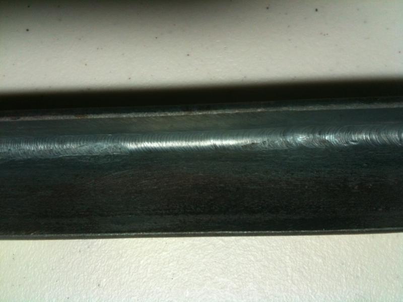

I do not have HF so I am scratch Tig only and thus can not drop off amps/pedal as the piece heats up as you travel along; especially as you approach an edge.
That is tough. Have you tried going half way, stopping, then starting on the other side, meeting in the middle? Restarting on the other side lets the part cool, so you won't be too hot on the edge.
Yes I do that when I remember; but sometimes, no, frequently I forget and weld to the end. Need to build a habit pattern so I always do that.
