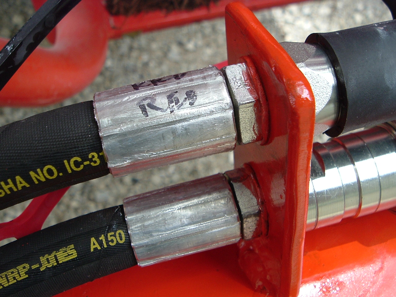

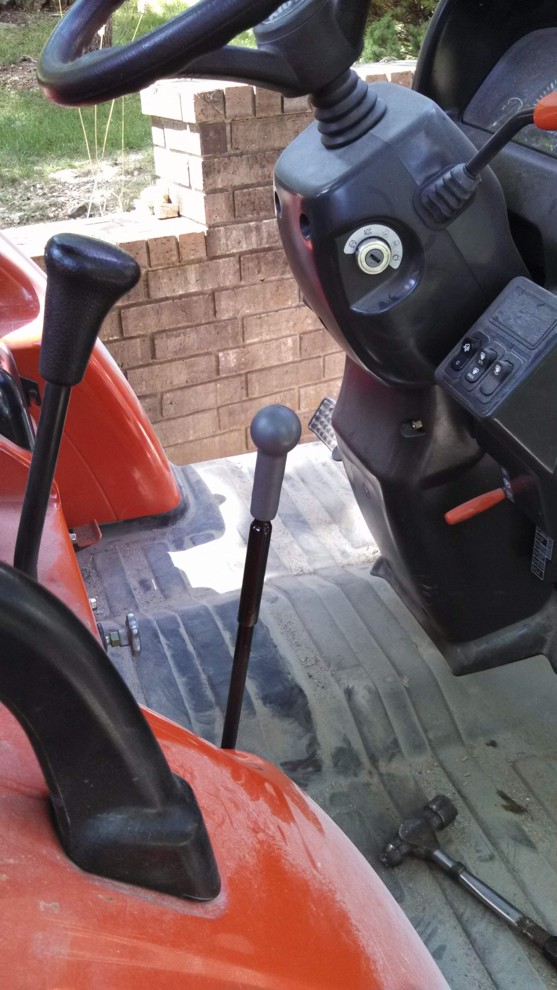

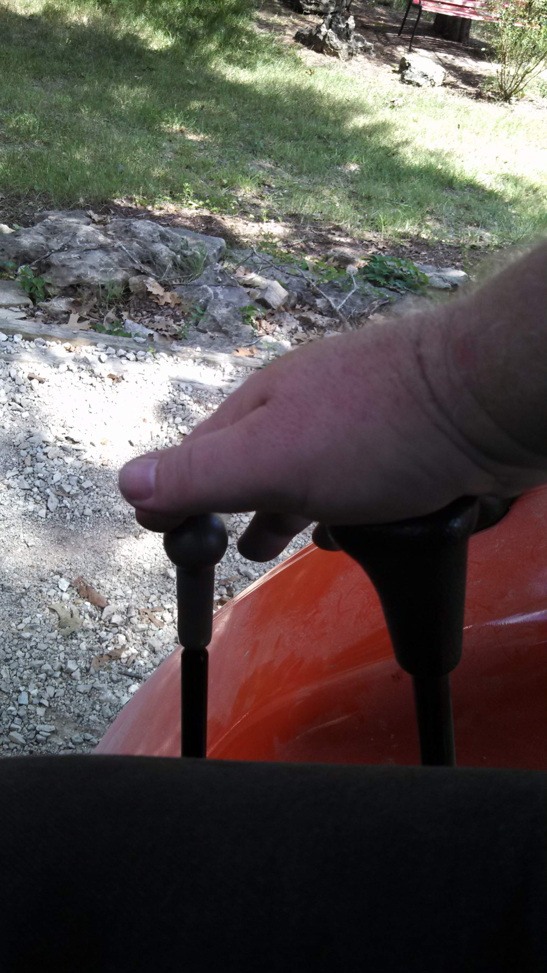

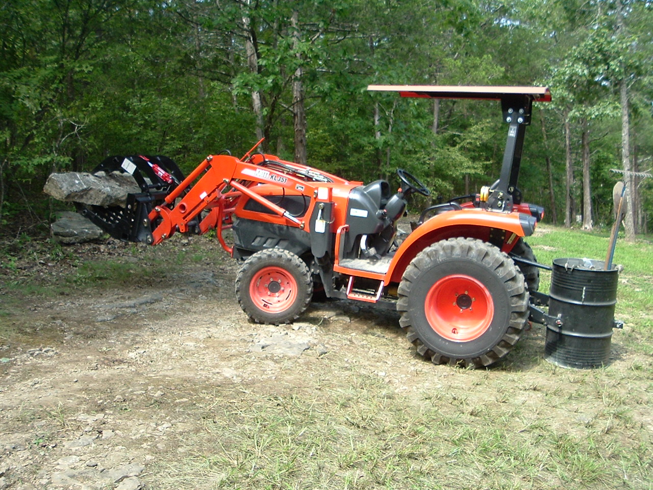

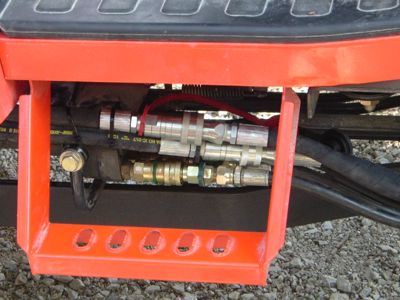

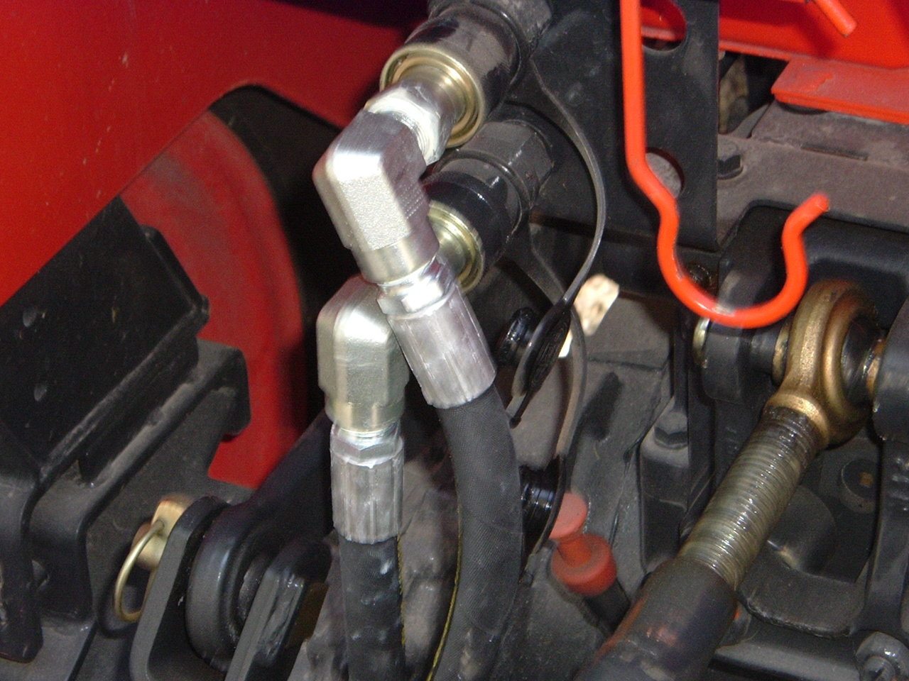

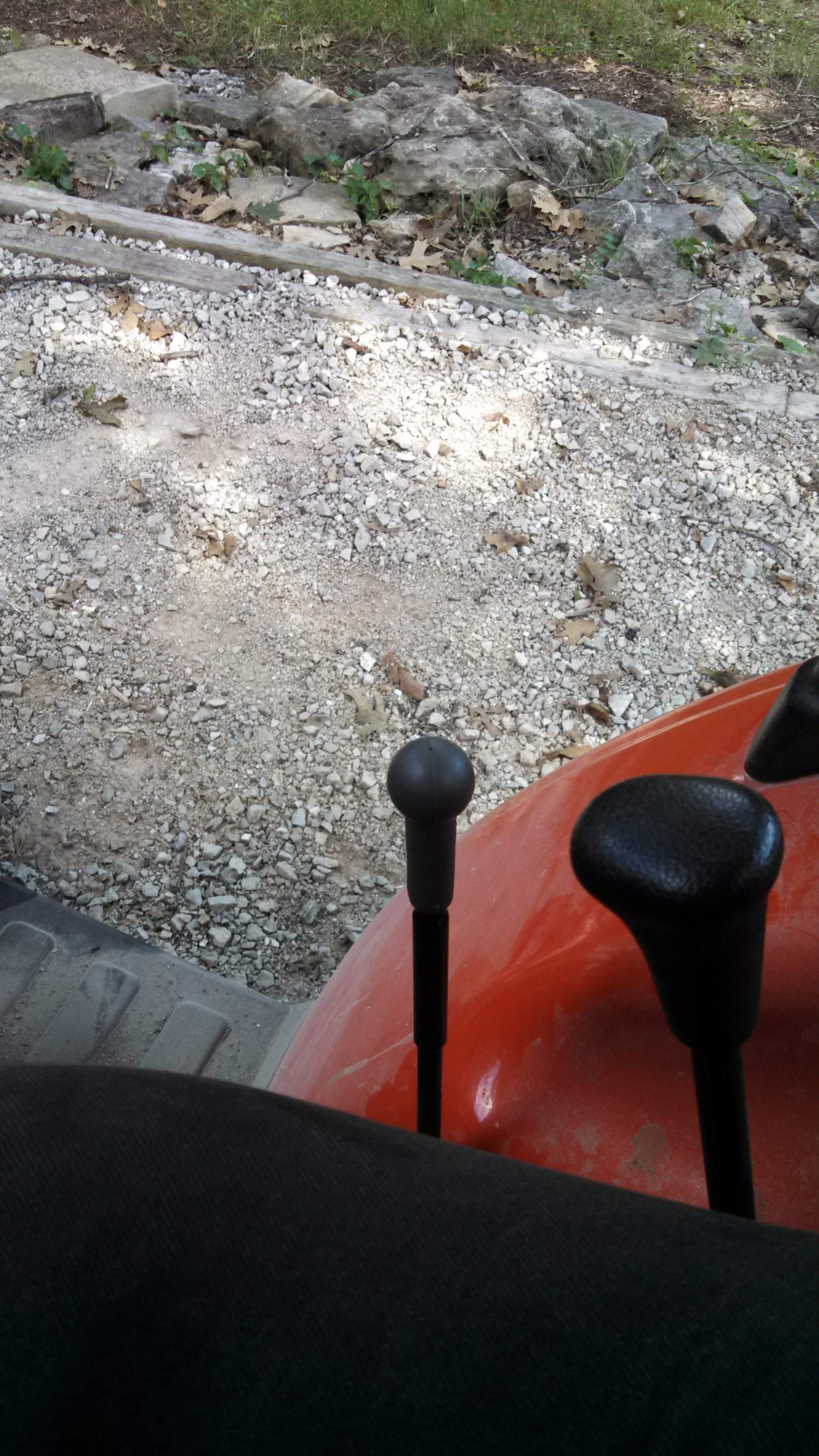

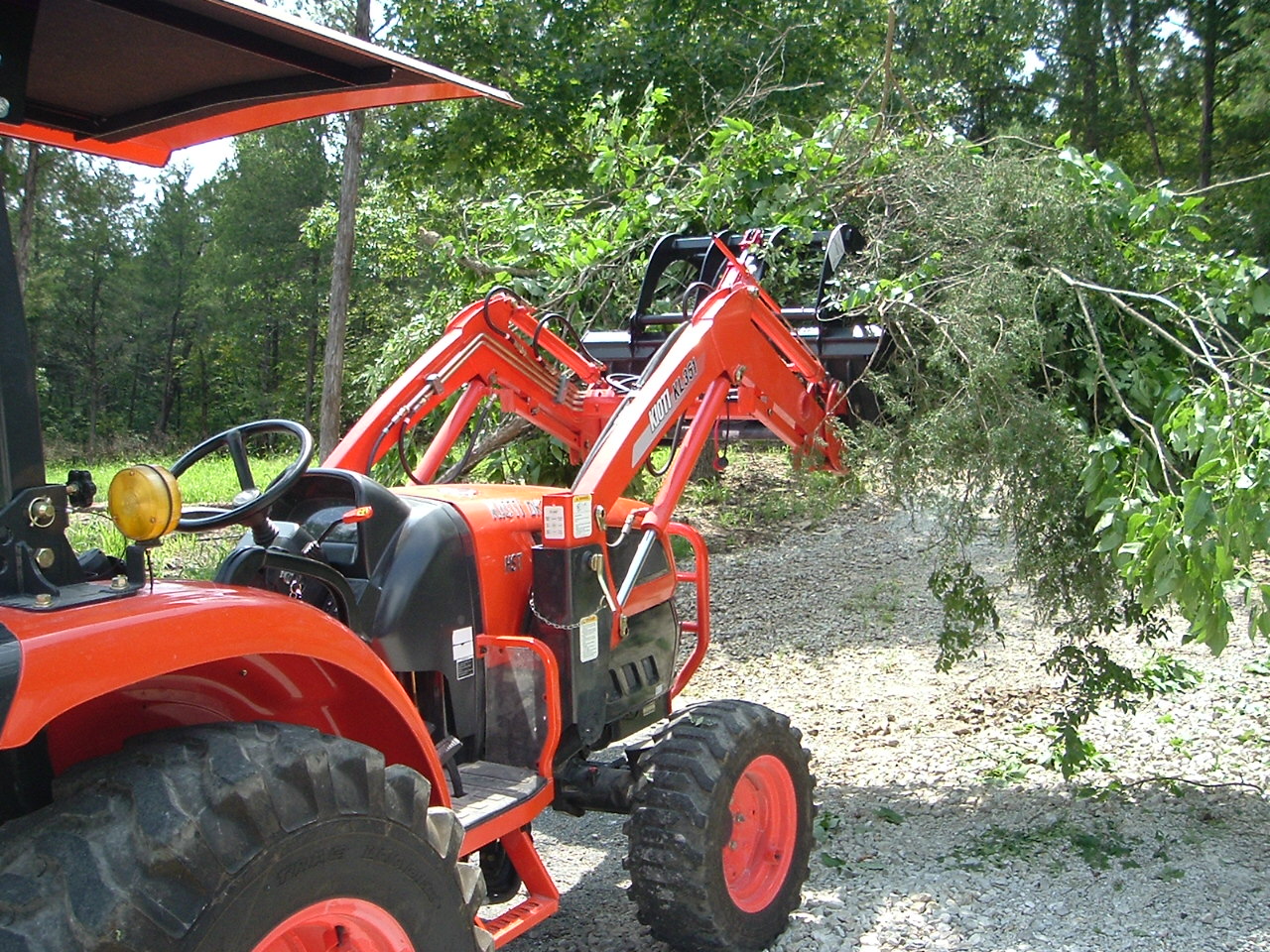

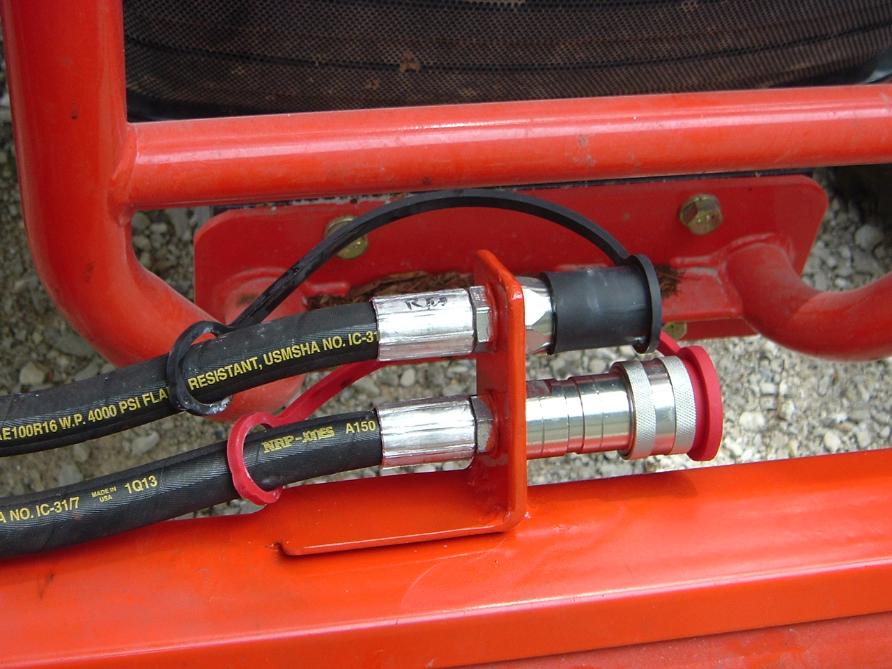

It is how I control my grapple, by running hoses from the rear to the front. The DK series lends itself to this very nicely. I did extend the lever length so that I could keep my hand on the joystick and use my fingers to control the valve for the rear remote. It works very well.
http://www.tractorbynet.com/forums/...-quick-connects-loader-torque.html?highlight=
http://www.tractorbynet.com/forums/...ion-control-valve-lever.html?highlight=remote
installed 2.jpginstalled 1.jpgin use.jpgDSCF0555.JPGDSCF0550.JPGDSCF0527.JPGDSCF0528.JPGDSCF0514.JPGDSCF0512.JPG

As for how to control it, this method gives much better control of the grapple pressure than a 3rd function button. It allows you to "feather" the pressure. Push the valve forward to open the lid, and pull it back to close the lid and apply as much or as little pressure as you desire.

Your lever should be spring loaded to neutral. The more you move the lever away from neutral the greater the hydraulic flow. The more flow, the faster the cylinder will move. So you can control the speed by how far you move the lever.
Some valves will have a detent that the lever will stay in position when in detent. That is until the cylinder reaches system pressure then the lever will "kick" out of detent. With detent, you move the lever into detent, let go of it and (depending on direction moved) your grapple will open or close, and lever will kick out (grapple will remain open or grapple will remain closed). My valve has detent and that's how I use it.
Your valve could also have float. Usually in only one direction of the lever. If you push the lever too far the valve enters float. Not useful with a grapple. Sometimes I accidentally move the valve to float and the grapple stops moving. Just pull the lever out of float.
