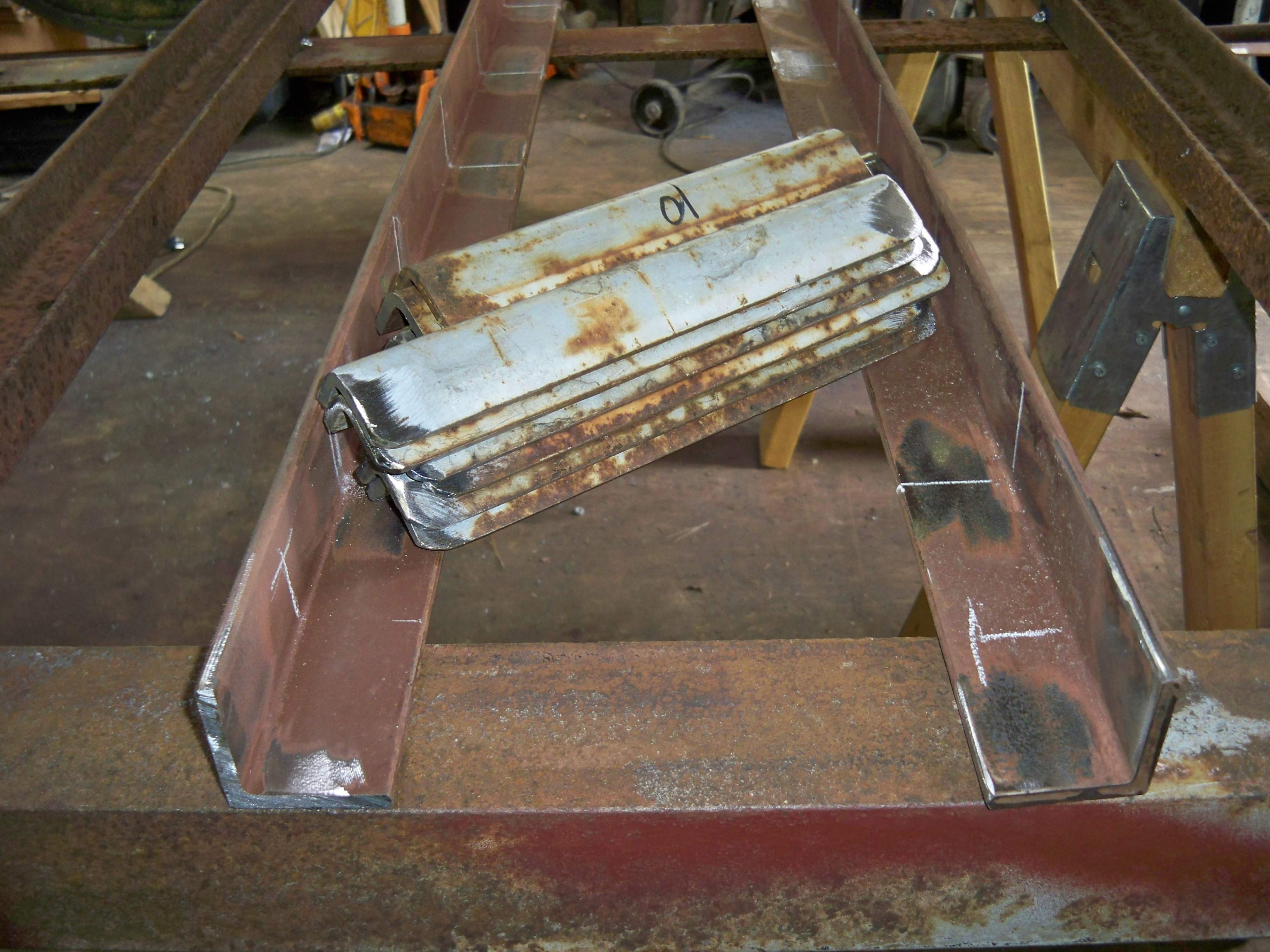

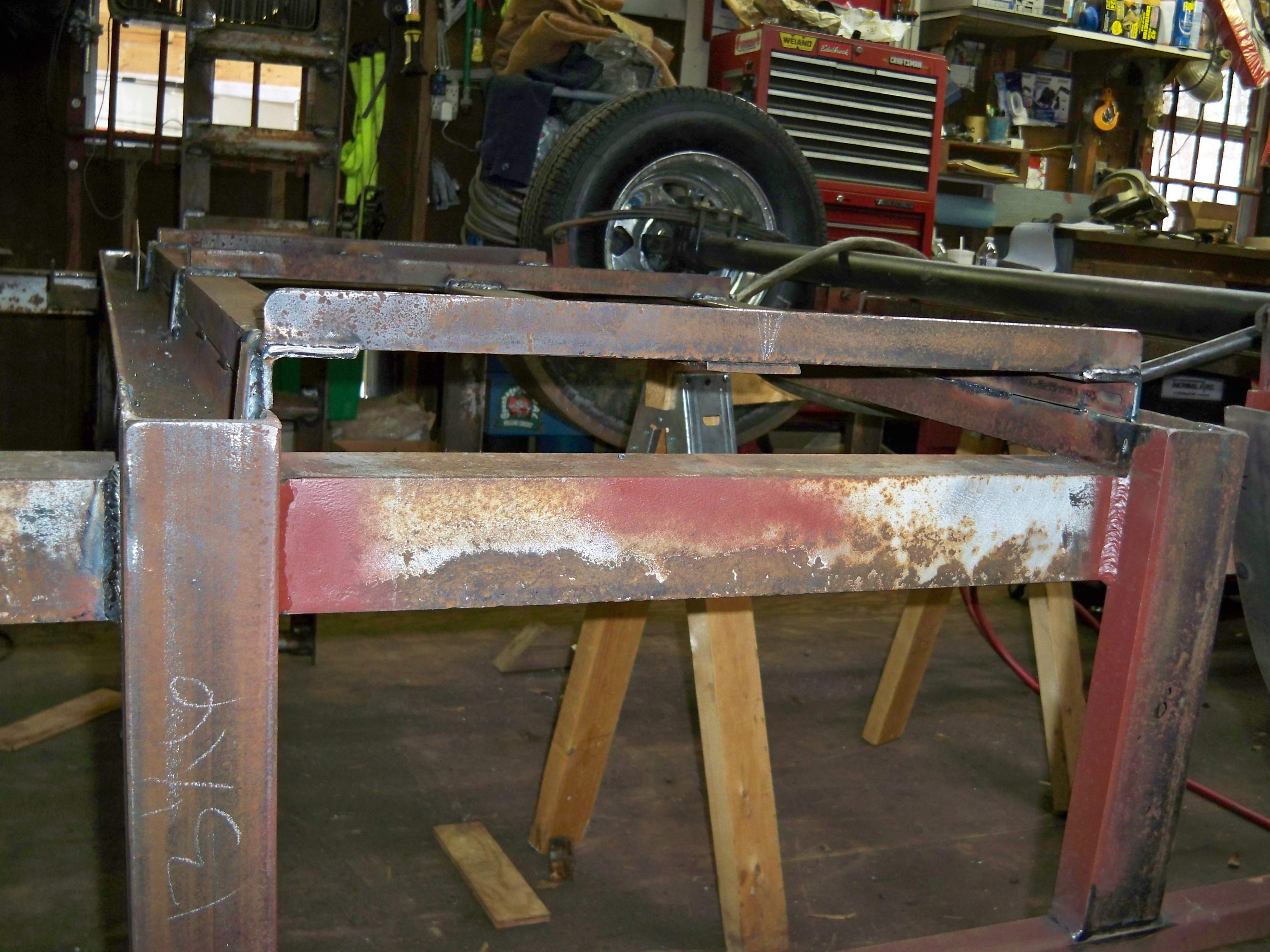

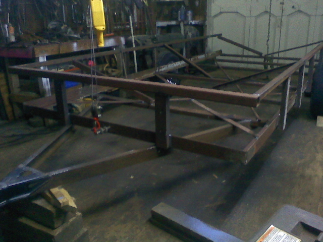

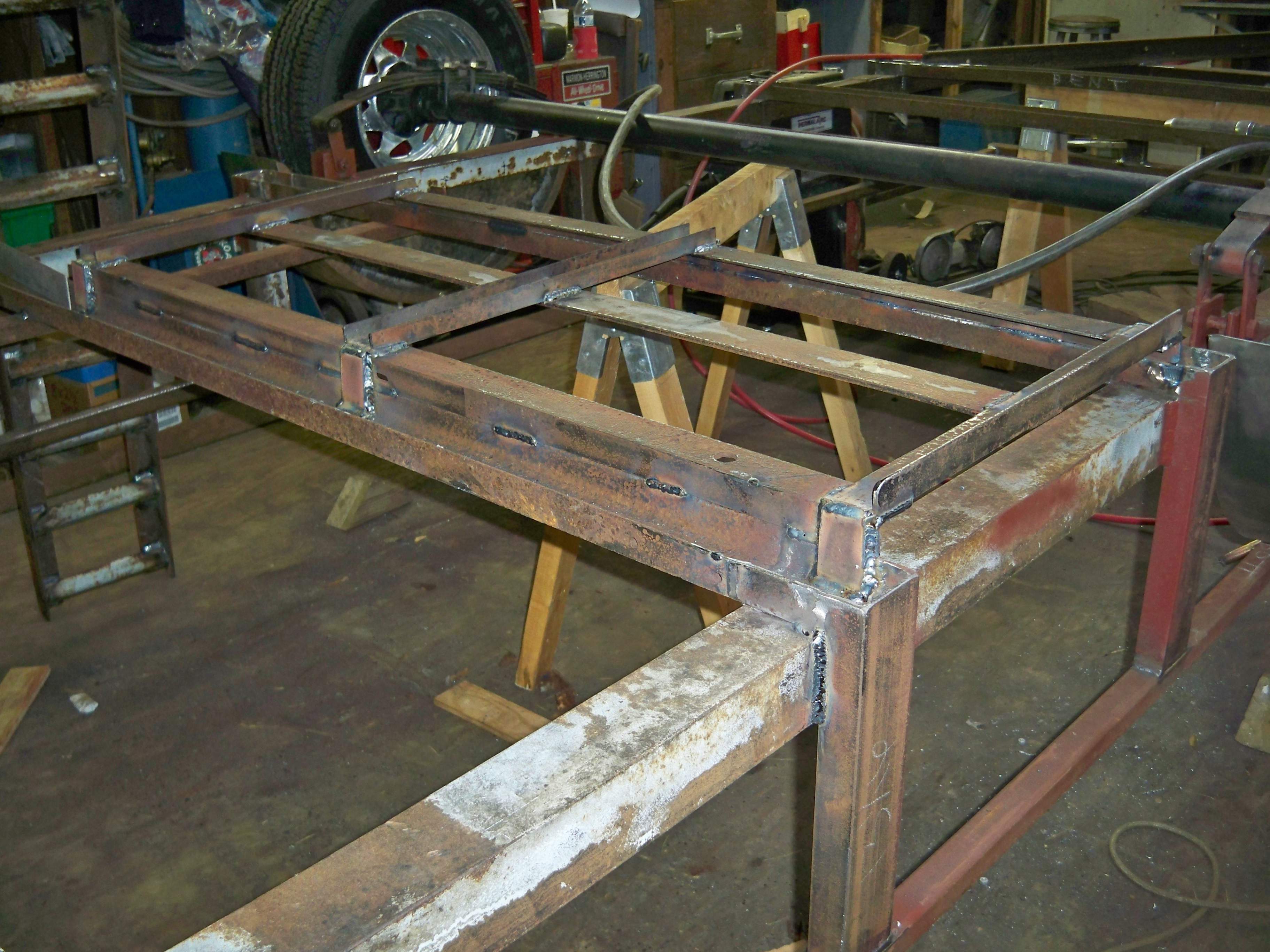

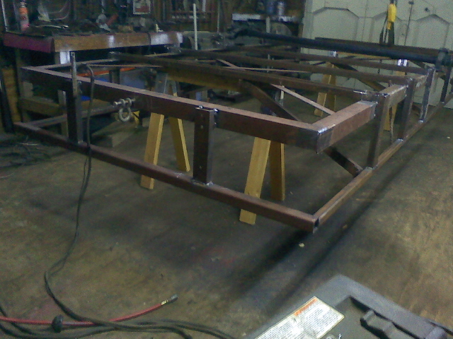

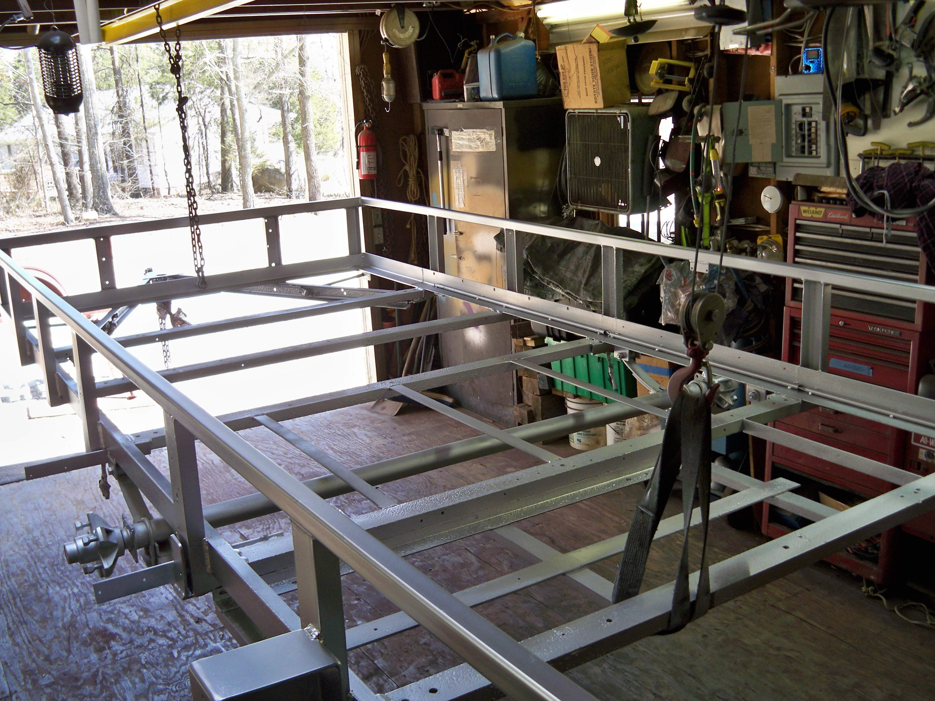

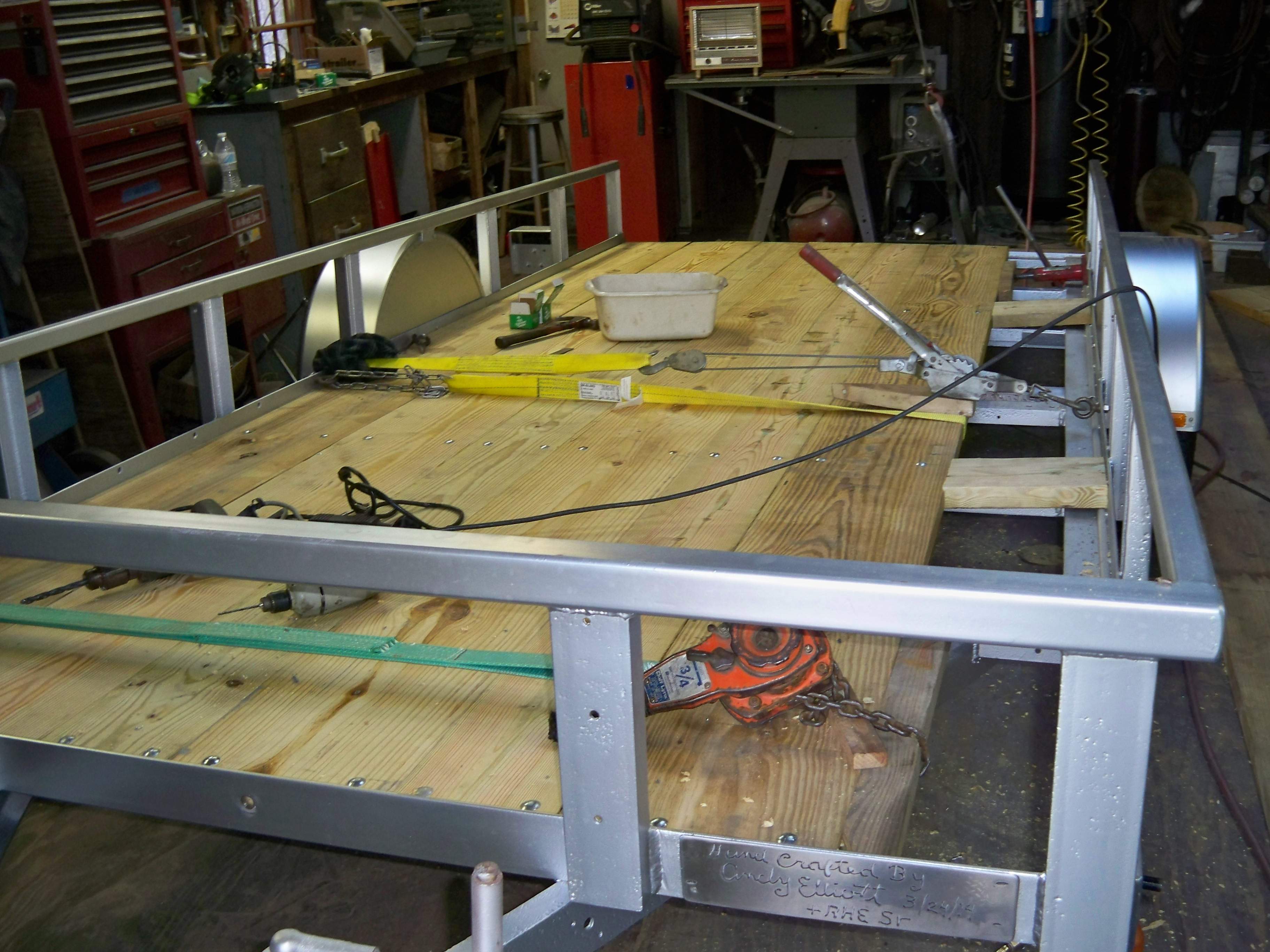

After 30 years of collecting and procrastinating, decided to go ahead and build me a 6 x 14 utility trailer for general use. Most everything I already have and been gatherting scrap steel since before I went to welding school in 1982. Note that this is not cost effective for the price of trailers these days. Some of this iron has been relocated 4 times over the years waiting for this project and others. Had to weld some peices together to get the length I needed.
Made provisions to flip the trailer for fitting and welding:

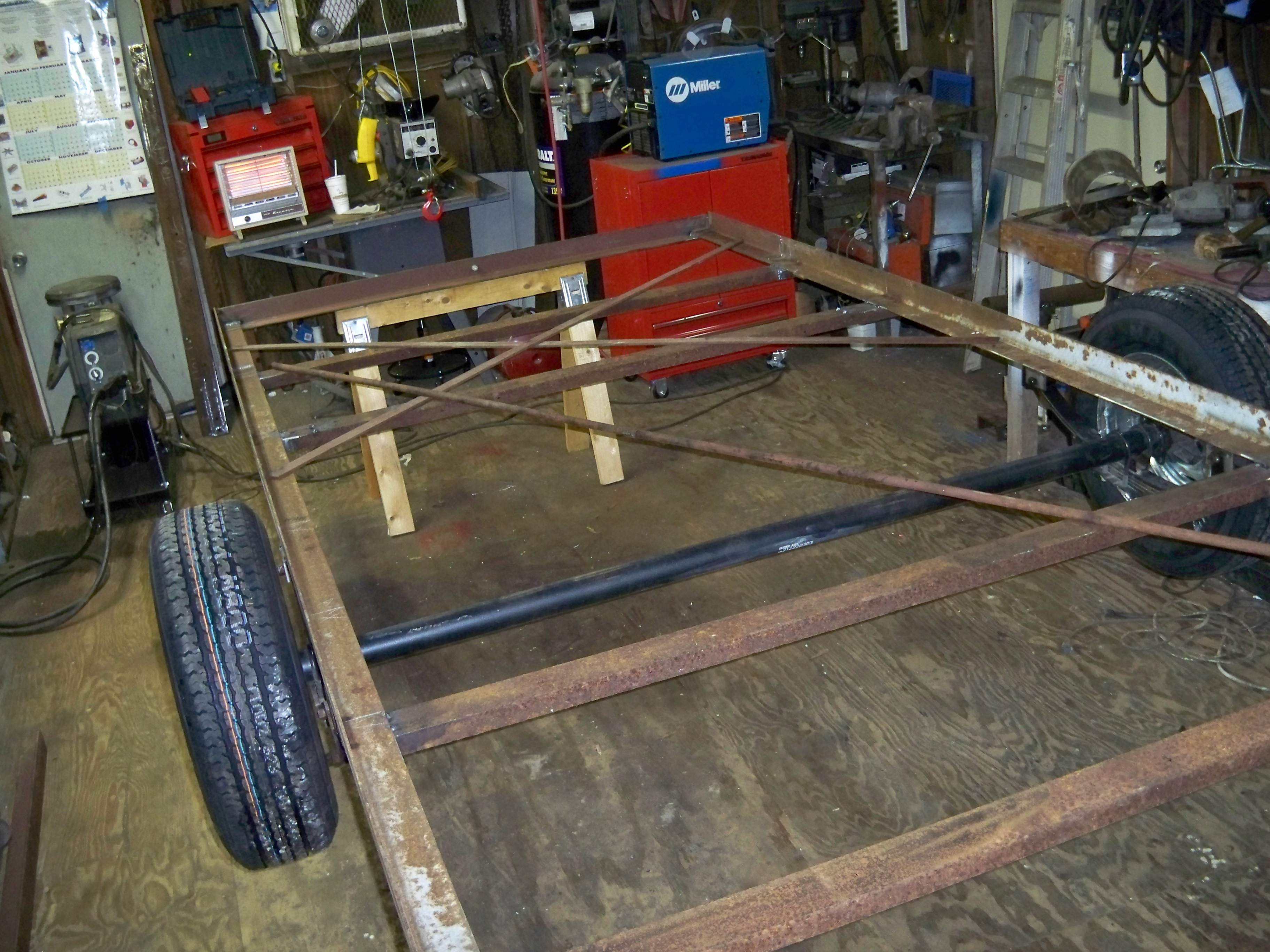

I am not sure you are getting the best strength out of the materials for the cross members with the channel being turned the "weak" way down flat like that. It'll work for sure but you may have wished for something different long term.

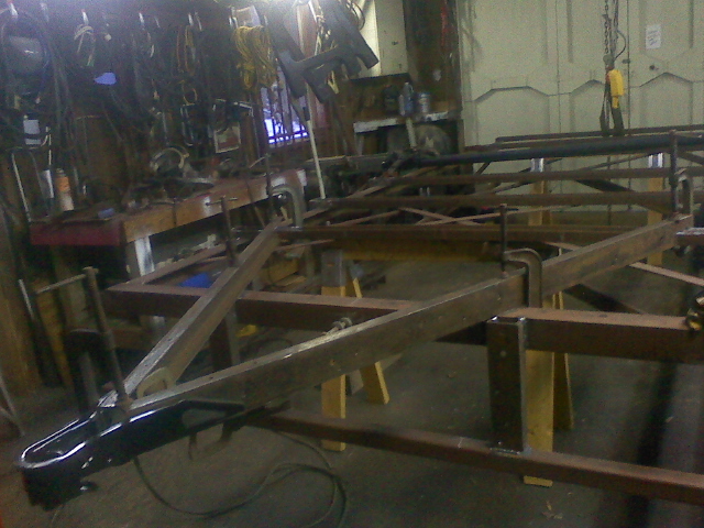

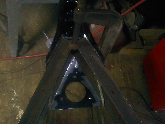

We did a series a while back in the summer on building trailers, from tubing. A frames are hard to get centered exactly and can result in a trailer not pulling right if they are used by themselves without a center tube to tie things in. A combination of both center tube and A frame is the best.
/ Utility Trailer Build - Finally #5
My trailer is much heavier but if I remember, the axles/A frame were triangulated to line everything up so it tracks straight. I did all the welding but the trailer was tacked in a trailer jig for me. I reluctantly had to trade my Trailblazer 55 for the trailer for my skid steer. I got a 14,000 GVW trailer and a couple thousand $$$ to boot. Sadly they rather abused the welder and ended up pulling the engine out to put in a skid steer. I think the welder only needed a new contactor and some fly-by-night repair shop told them it would cost 3 or $4000 to fix. They used the welder for quite a few years and are still using the Miller S-54 deluxe wire feeder on an electric machine in their shop though. I kind of cringe when I see the welder sitting there.

Why angle for the sides then channel for the cross members?
I would agree. The factory made trailer I mimicked used 2x3x3/16 angle for crossmembers, so I fugured my 3" x 4.3# channel layed flat was at least as strong or not stronger than this thin angel iron.
Working out of my steel scrap pile, it was the only thing I had that was any length at all. The angle was only 12' so I still had to piece 2 feet onto each side rail.

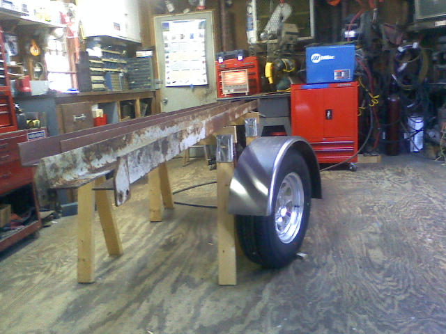

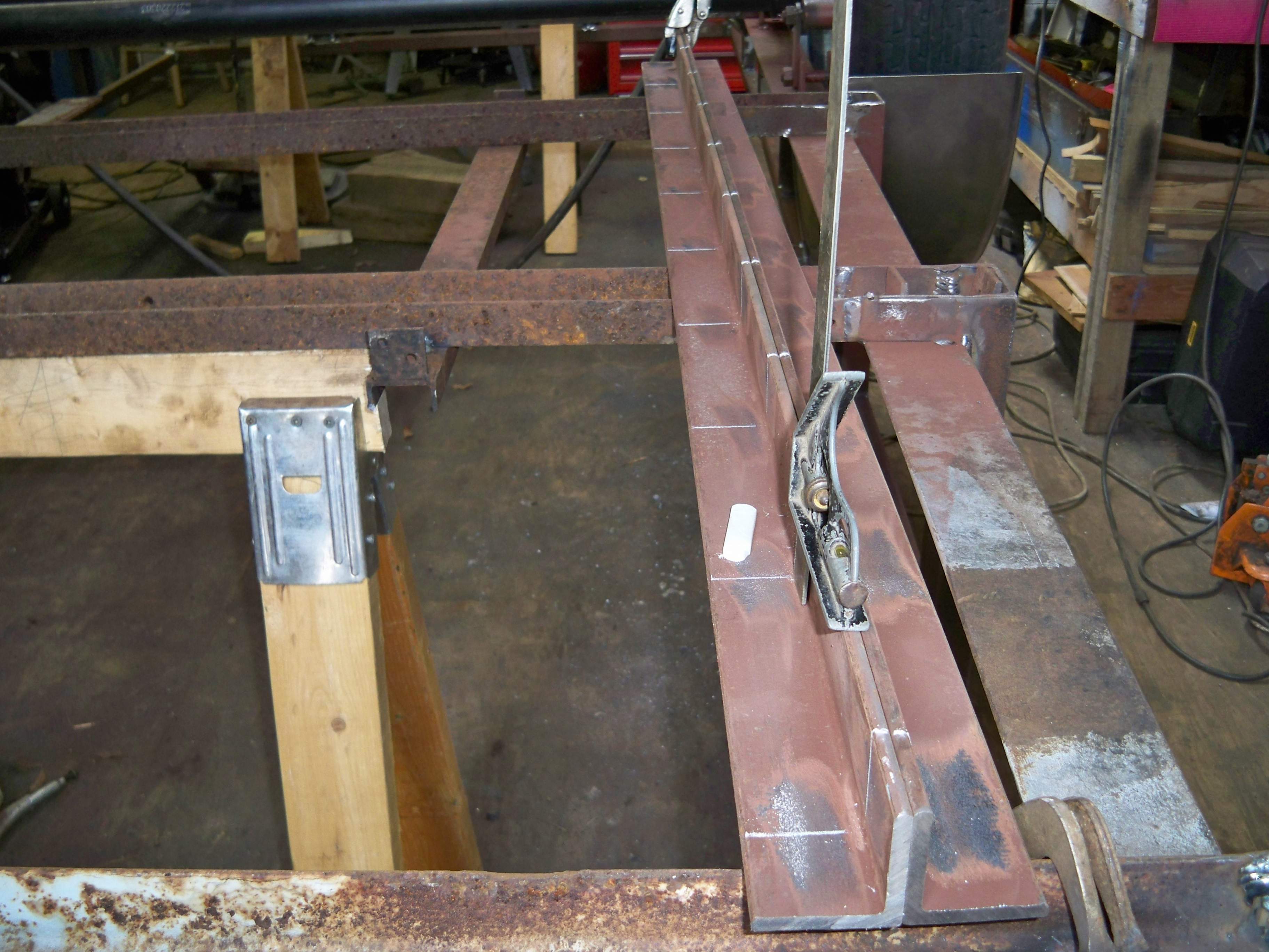

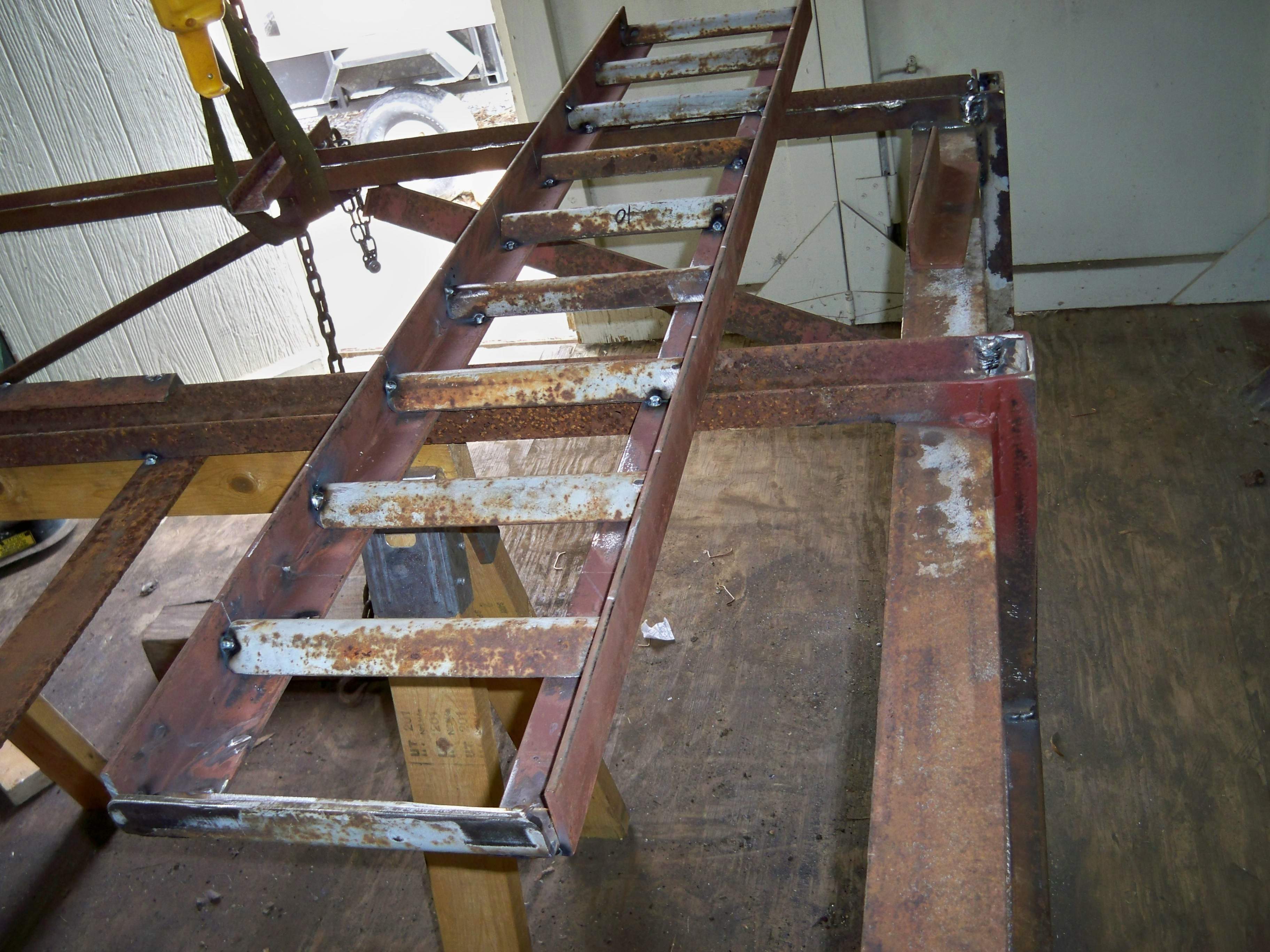

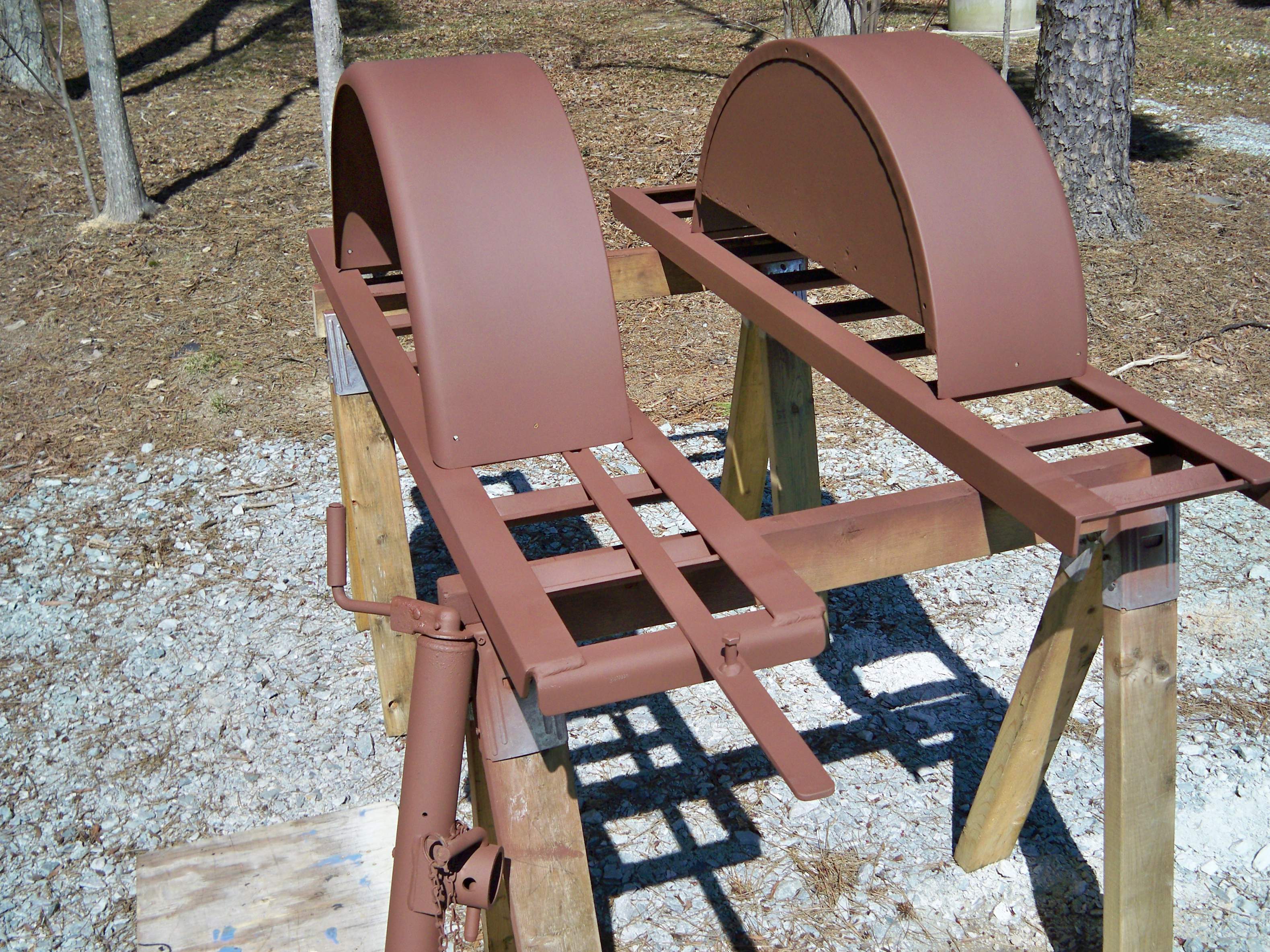

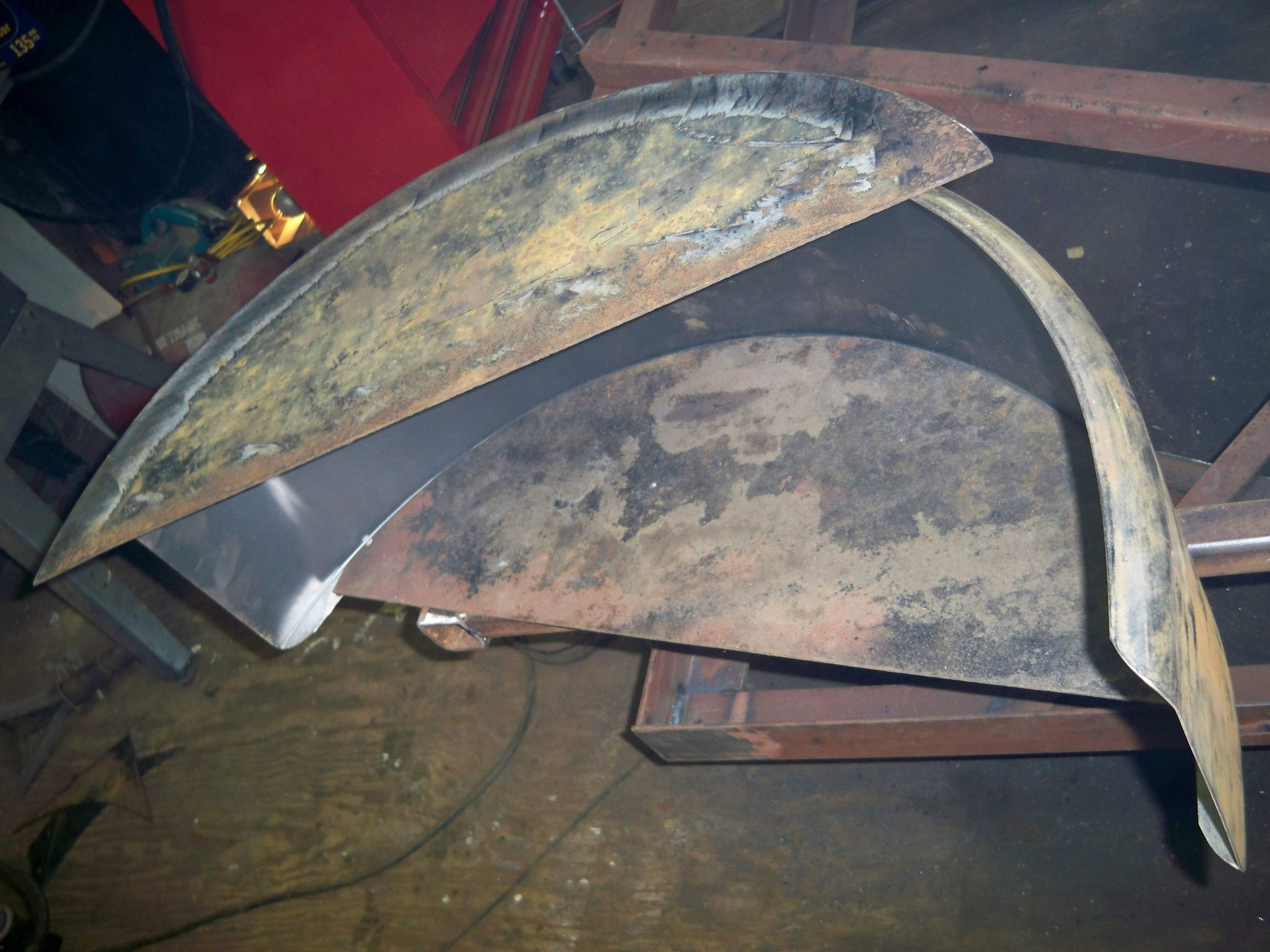

Here are the fenders and the ramps going together. Made a slide in storage bracket behind the axle for the ramps. Ramps are a little heavy, but I used what I had. Also saved $30 by ordering fenders w/o the backs.

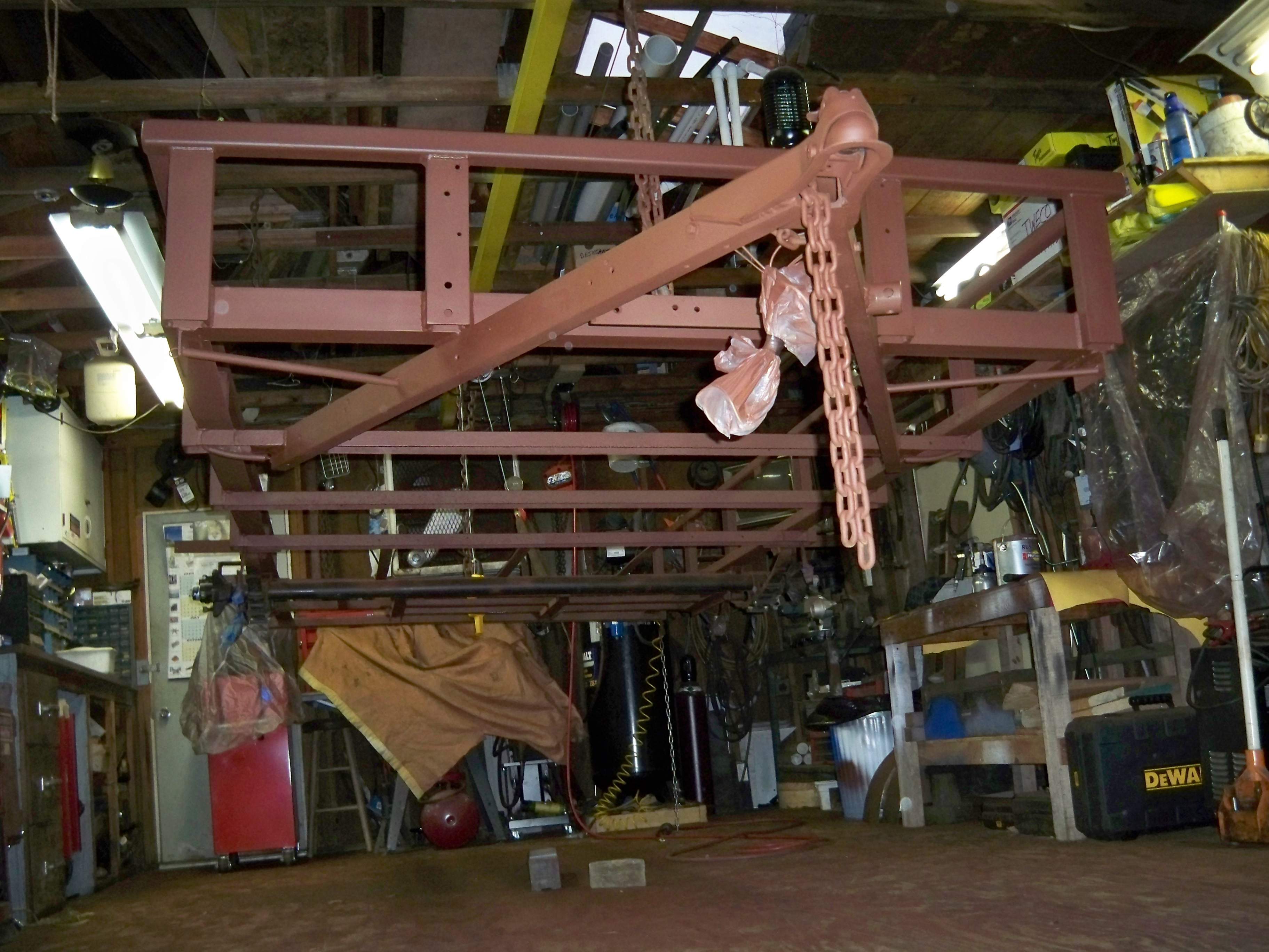

Little bit of a safety issue each time I flip it so this is the last flip. I rolled it out of the shop for the first time down the ramp, and took it for a test drive.

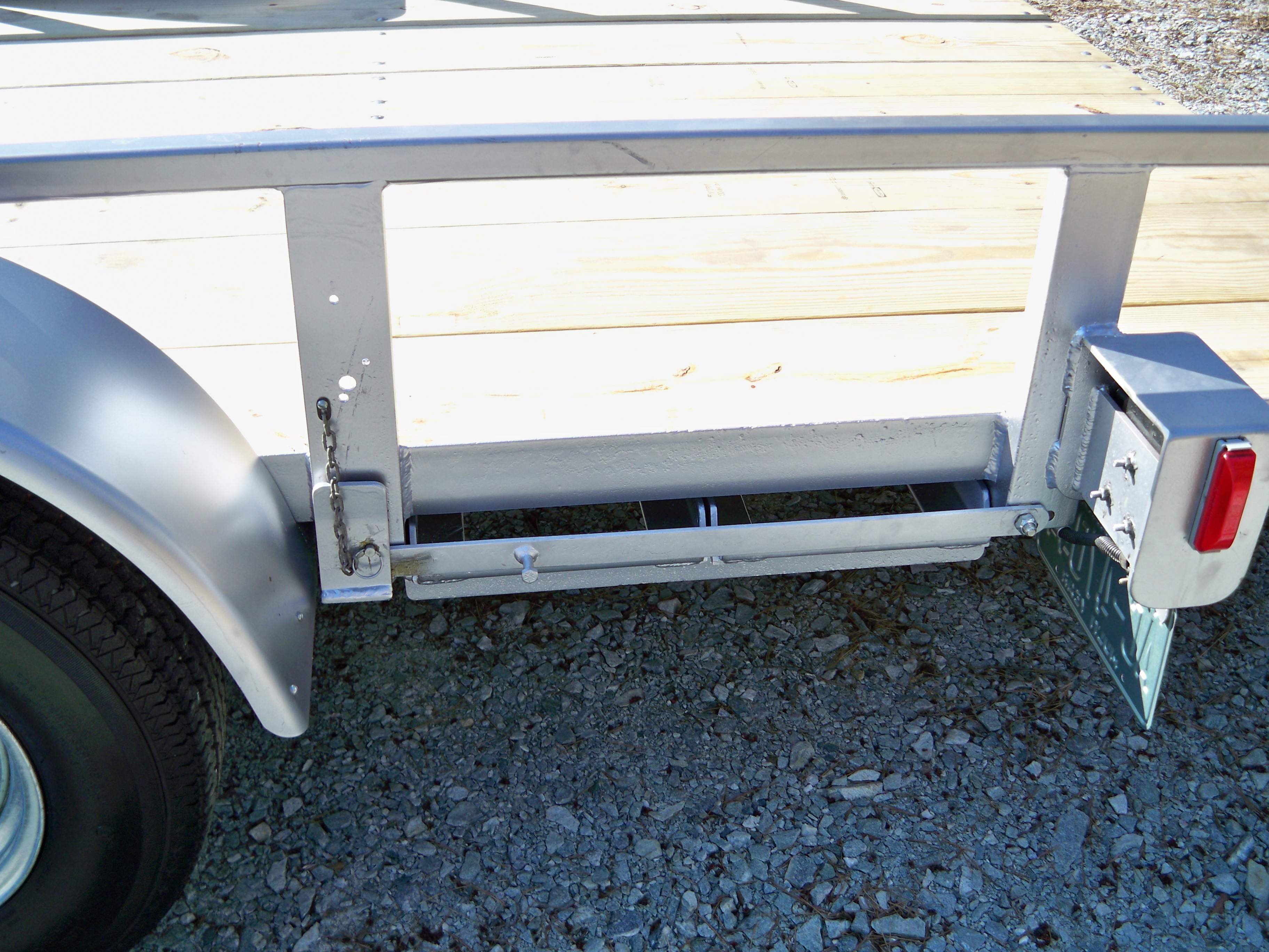

Working on the lights and running conduit, I have several sticks of 5/8 steel tubing not good for much else. Making tail light boxes and fitting up what lights I already have. Installed some of the conduit on top and will notch the wood to fit over it.
Also working on some type of ramp retaining bar, found this piece of stock already made with the holes in it and already the right length. Will hit my tail light though, still in the figuring out phase...

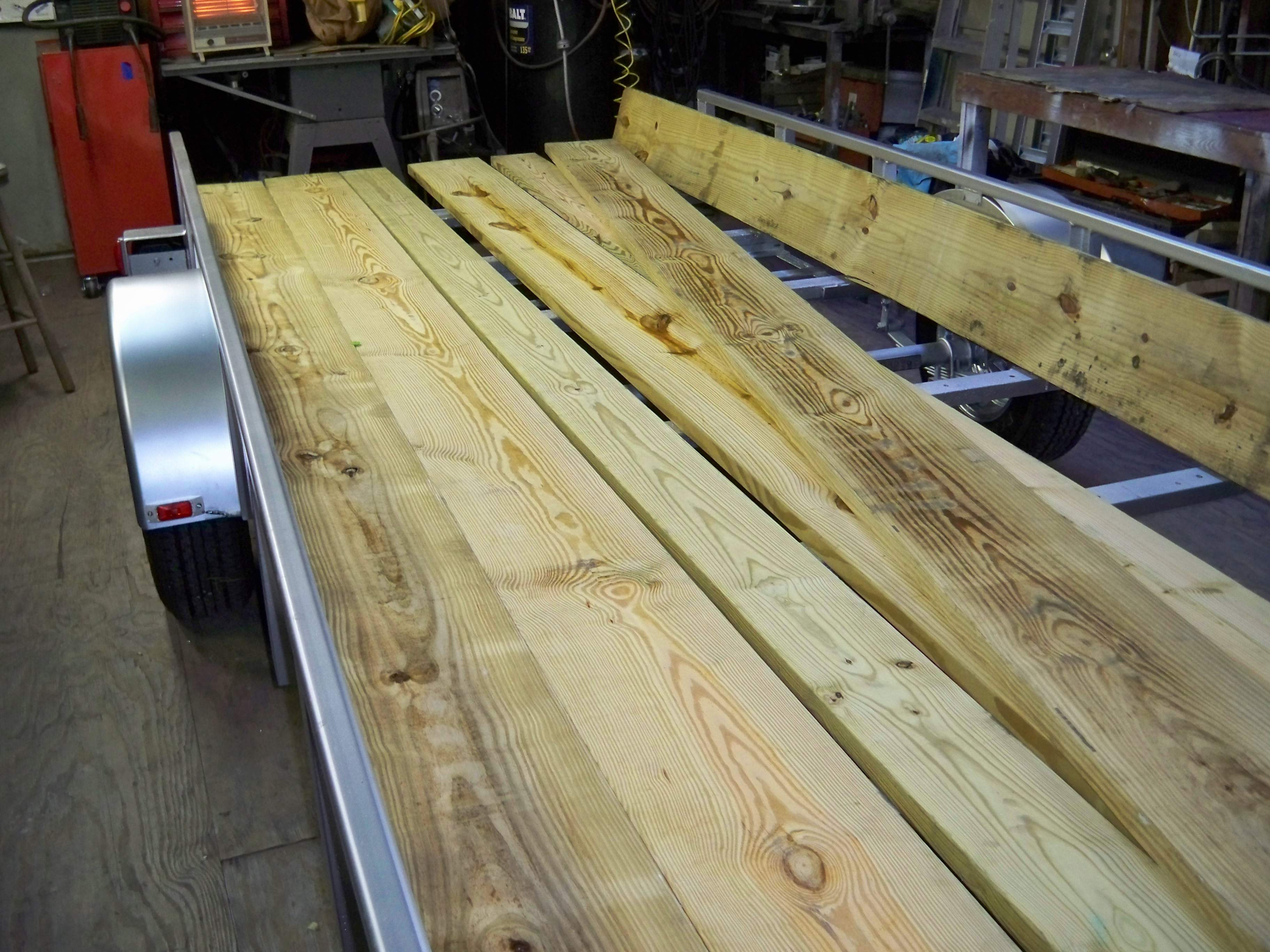

Fenders, wheels, and all lights wired. Sizing up the treated wood floor picking out the best sides and ends, this expense alone was $200 +. Applied pressure to the boards to keep all the gaps really type as this wood will shrink in a few months. Used 56 ea 3/8" carriage bolts, lots of drilling.

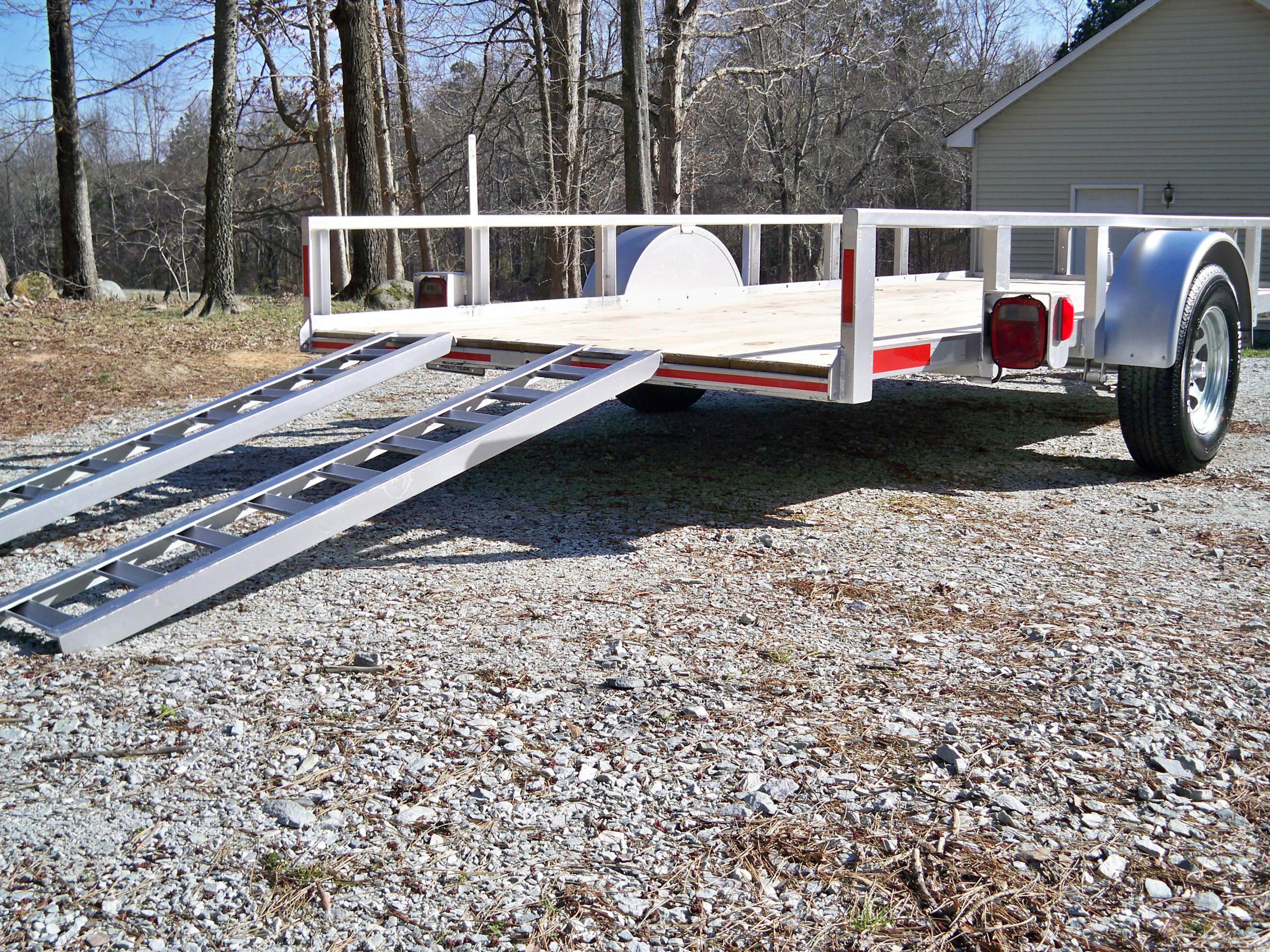

Well I'm calling it finished. I have many many hours in this thing and I'm guessing about 60% costs compared to a new one. I had a lot of the materials already or would have cost even more. Ready for it be finished. Had some of the reflective tape already and ended up buying one more pack from Lowe's. Burned about 15# of .035 mig wire, I imagine a store bought trailer would only use 3 to 5#. I'm happy with it, and tired :thumbsup:
