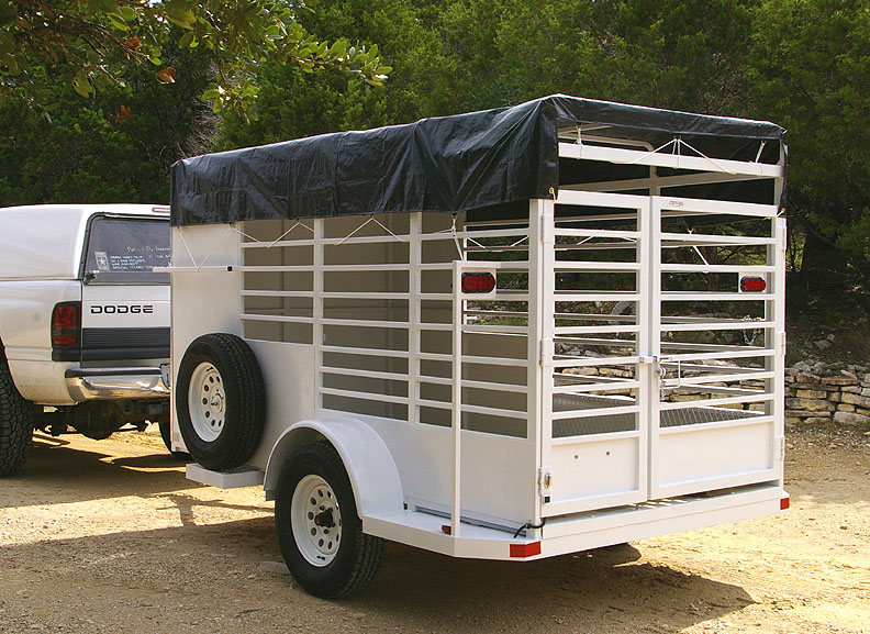

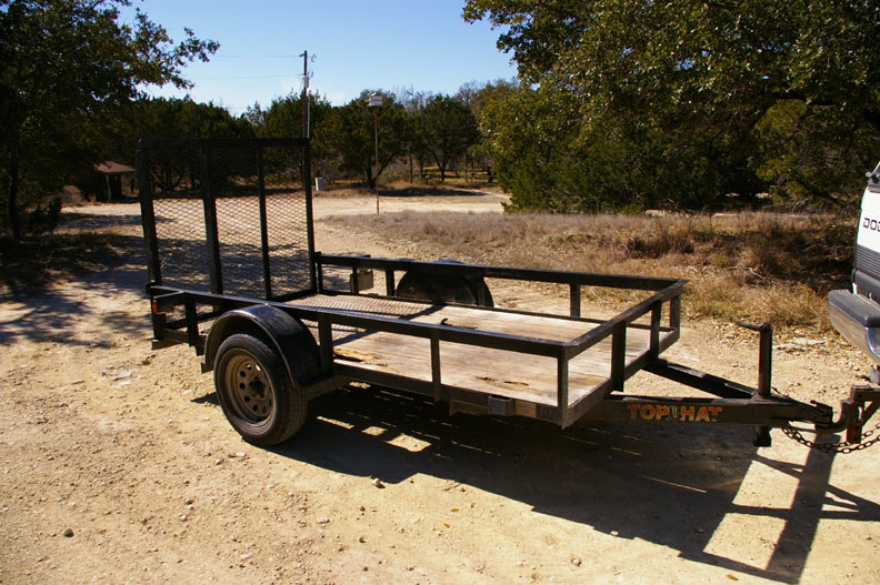

I recently took a well used utility trailer and gave it a new life as a livestock trailer, primarily goats. To date, I have done this to eight utility trailers and sold every one of them within three weeks. Why they are not building these commercially is a mystery? For those who may ask, how does this involve a tractor? Be patient and I will show you how a tractor fits into this. I began this process on 31 January and finished on 29 May 2016. If you follow along you will see how it is done. Enjoy.:) 31Jan16_ 001.jpg29May16_65.jpg

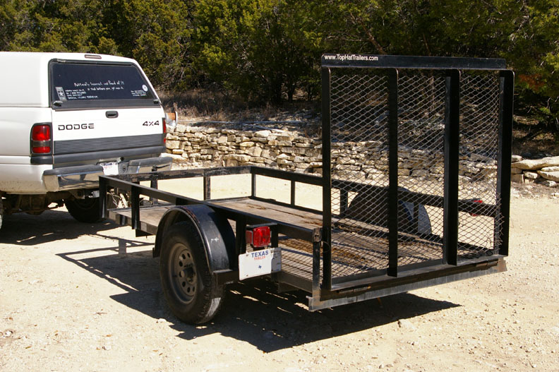

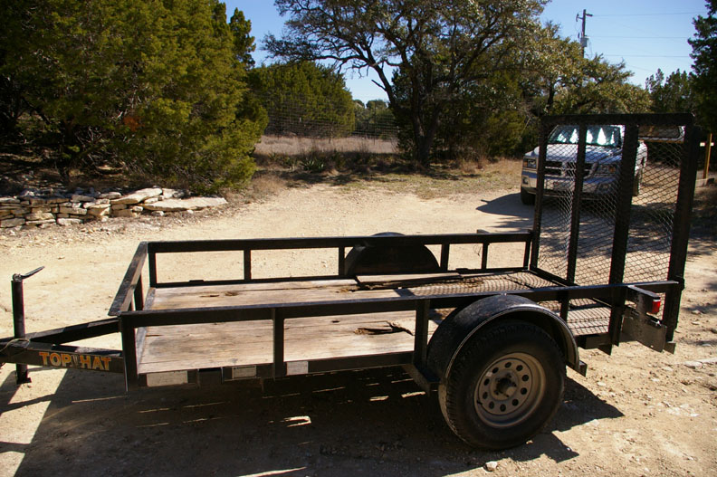

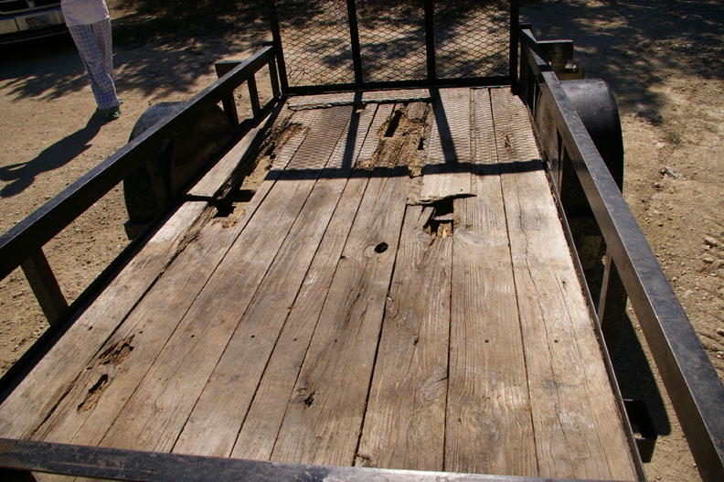

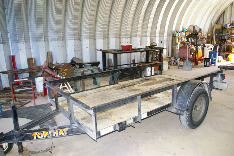

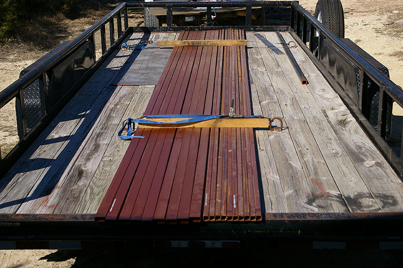

The trailer was in pretty good shape when I picked it up for $400. The tires were shot as was the decking. All of the steel was in good shape. A few dings in the fenders was all I found. Had originally intended to keep the ramp on it but then realized that would limit how and where the trailer could be used. 31Jan16_002.jpg31Jan16_003.jpg31Jan16_004.jpg31Jan16_005.jpg

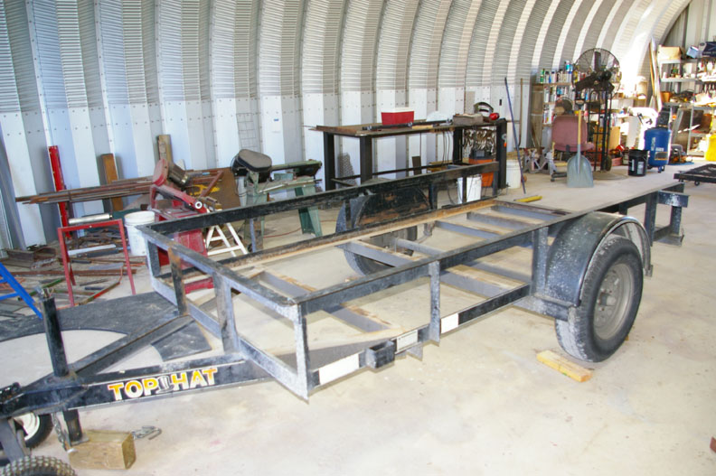

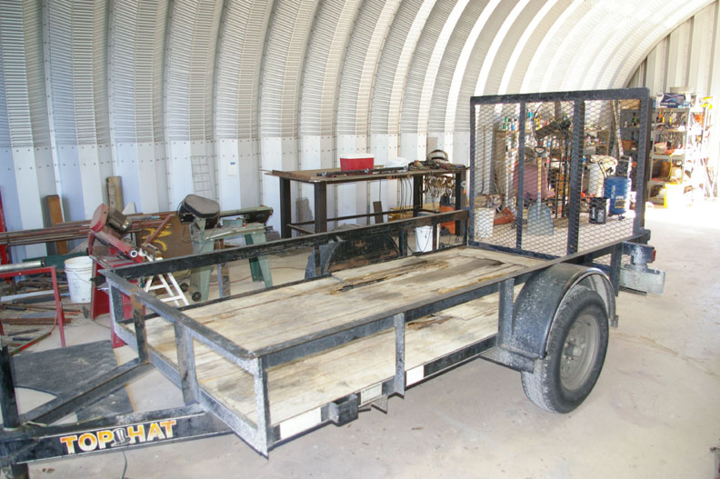

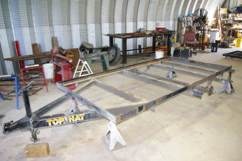

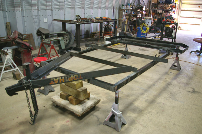

Into the shop to begin the inspection and tear down process.31Jan16_006.jpg Off comes the ramp and the deck.31Jan16_007.jpg31Jan16_008.jpg
/ Utility Trailer Gets a New Purpose
#11
The only bad rust was on the right side near the rear. It appears that water would collect there. No structural damage just some pitting. 2Feb16_011.jpg
Some work with a wire brush and angle grinder then treatment with some Skyco OSPHO and it is ready to go. 2Feb16_012.jpg
Off with the fenders side rails. The fenders will be cleaned up,repaired and reused. Some of that angle will see new use later on. 1Feb16_010.jpg

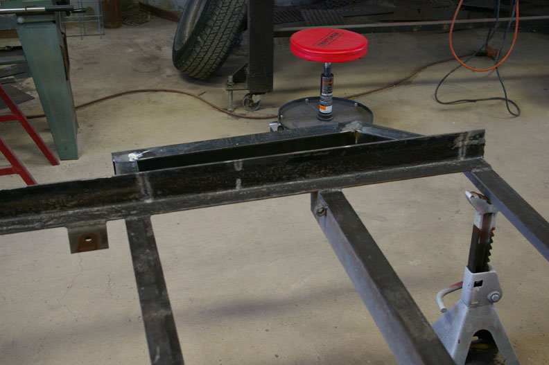

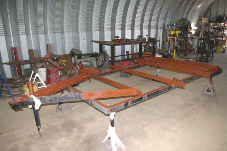

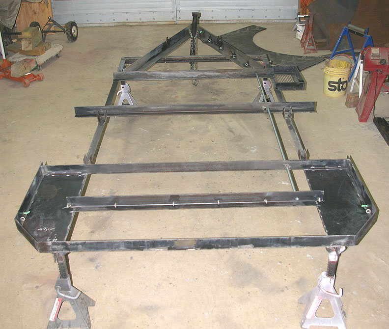

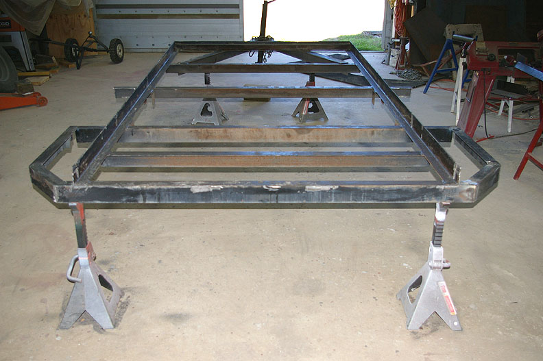

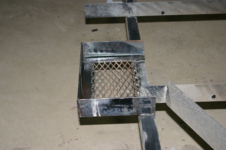

Before turning the frame I added deflectors on each side to help avoid the inevitable broken taillights when backing the trailer around buildings, trees and gateposts. The deflectors are made from the angle steel salvaged from the side rails removed earlier. 2Feb16_014.jpg

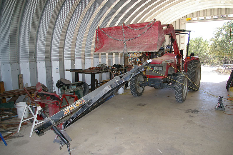

Now for the tractor. :thumbsup: The Mahindra is used to turn the frame upside down for work on the underside. 4Feb16_015.jpg
Once the frame is turned, all surface rust and dirt is removed and the metal is treated with the Skyco OSPHO. 4Feb16_016.jpg
Using more of the side rail angle a spare tire mount base is welded on. 4Feb16_017.jpg

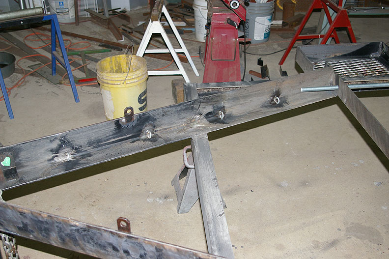

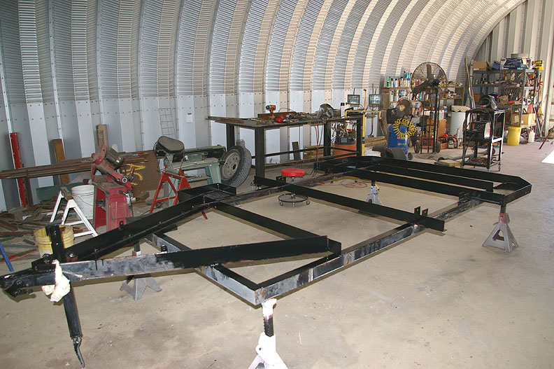

The frame is cleaned up and have welded on eyes to run the wiring through for the lights. Three grounding bolts are welded to the frame. One on the tongue and two at the rear one on each side. 7Feb16_018.jpg
Safety chain hangers, eyes to run the wiring through to the conduit. Goats love to chew on wire. 7Feb16_020.jpg
Finished off with some gloss black Rustoleum paint. Ready to turn back to right side upside. 9Feb16_22.jpg

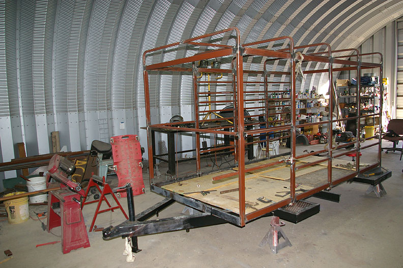

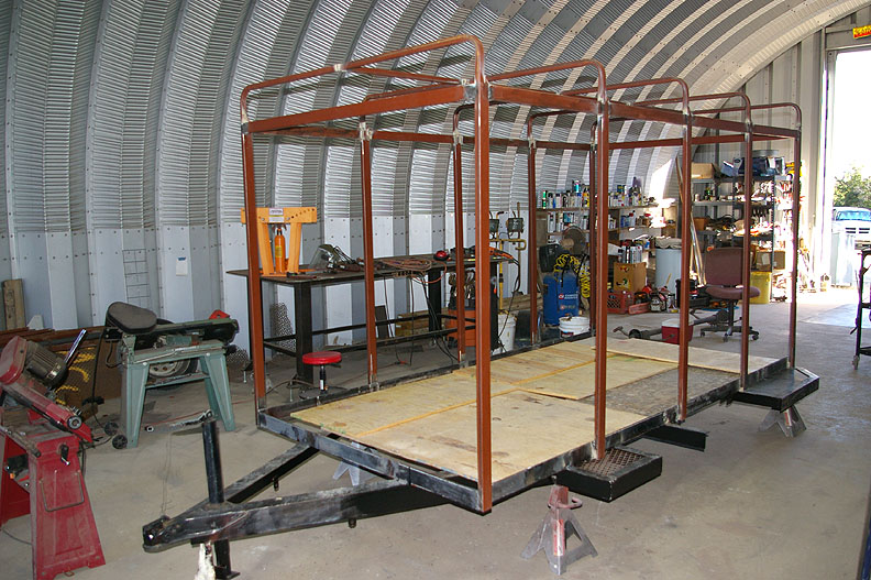

Time to start the build. I used square tubing 14 ga, 1" x 2", 1" x 1" and 16 gauge cold rolled steel sheet. LukesScreenName, the cost for the steel was right at $525. 9Feb16_23.jpg
With some help from the Mahindra :thumbsup: tractor, the frame is flipped back over again. The welding on the top of the rear deflector guards and the spare tire mount was completed and the frame of the enclosure started. 11Feb16_25.jpg

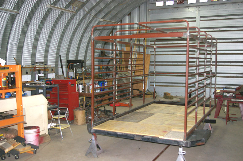

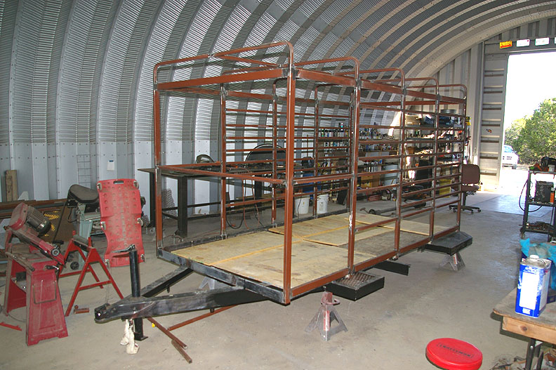

Once the enclosure frame was finished and all of the vertical supports were welded on, it was time for the bows to support the canvas top. 13Feb16_26.jpg

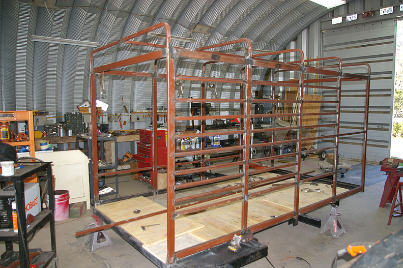

The enclosure area is now ready for the horizontal bars. 16Feb16_26.jpg 16Feb16_27.jpg
The large openings will be covered with sheet metal. The widely spaced horizontal bars to provide weld points on the sheet metal to prevent it from vibrating and added strength so the goats don't bend it out. 16Feb16_27.jpg
All of the horizontal bars are in place and finish welded. 18Feb16_28.jpg 18Feb16_29.jpg

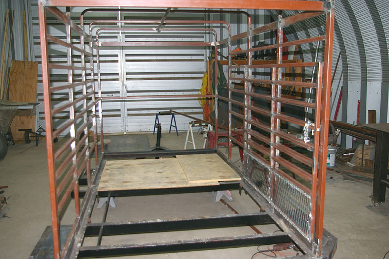

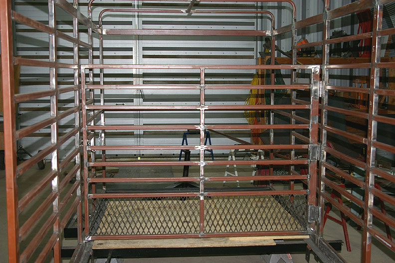

Does it have a middle gate you can close to keep the animals from all shifting to the back of the trailer?
Here you are, Pappy The answer to your question is, Yes. This is how it was done. 23Feb16_34.jpg
It opens and secures to the right side allowing for full use of the 5' X 10' interior space. 23Feb16_35.jpg
The open and closed latches are built so that only one square lock pin is needed. The pin is secured to the gate with a chain. Closed position, 23Feb16_33 gate closed inside latch detail.jpg 23Feb16_31 gate closed latch detail.jpg Open position 23Feb16_30 gate open latch detail.jpg
To prevent damage to the three heavy duty, Stanley weld-on gate hinges caused by goats standing on the gate, a rest was installed to bear the weight of the gate and goat. 23Feb16_32 gate closed foot detail.jpg
