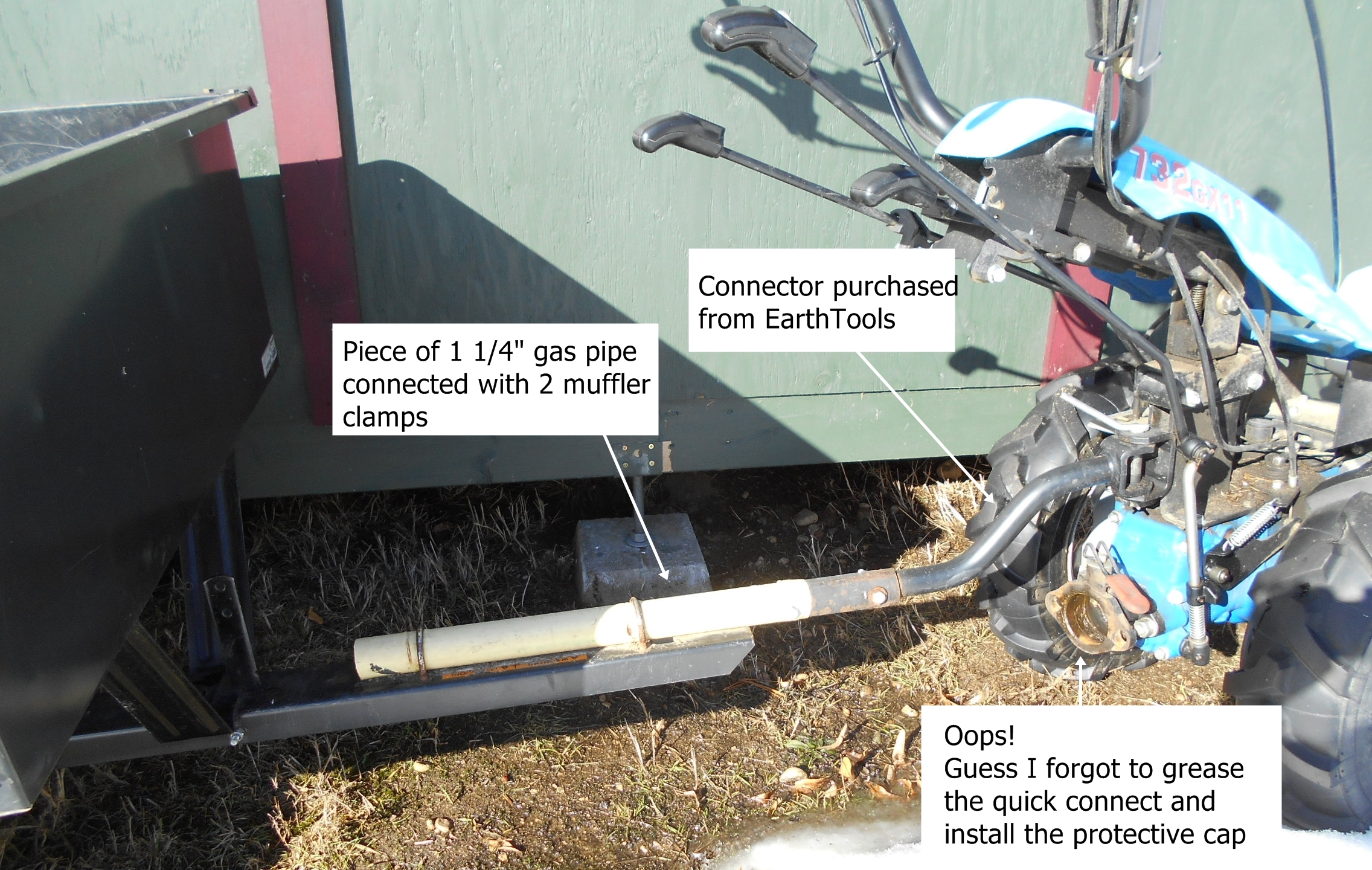

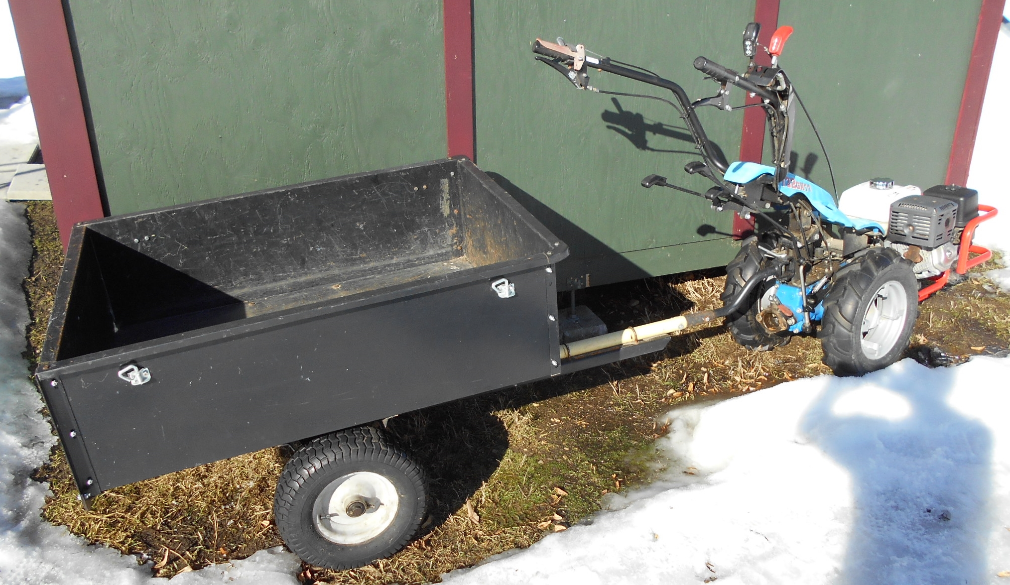

I have been towing an Agri-Fab 10 cu. ft. dump cart with our BCS 732 for about five years. It is attached using the EarthTools tow coupler and a piece of 1 1/4" pipe. I have overloaded it many times causing the wheel bearings made in 'you know where' to fail - replaced them with European made SKF bearings and watching what I load. Our property is mildly hilly and, as I have no extra wheel or engine weights, it struggles to haul firewood uphill - I often have to jump off and push! It flies in 3rd (transport) gear but I keep forgetting that there is no engine braking in that gear!! Anyway, though this trailer is quite small, it works for me.

What sort of 1 1/4" pipe? Heavy water pipe or something more like aluminum conduit? I could maybe bend conduit, but not sure how I'd bend a water pipe?
   / Utility Trailer Question #10
Snow is finally starting to melt today, I'll see if I can take a decent picture of my setup.
The pipe is a piece of black-iron gas line that my neighbor gave me.
   / Utility Trailer Question #11
This is my 'economy' setup.
Hope this helps you?

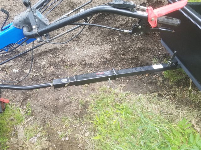

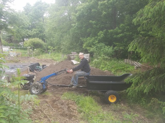

I went on a similar search a few years ago. I found a trailer with the axle biased towards the back of the trailer to put more weight on the BCS wheels for traction. It was a Polar HD1500. Also is a dump trailer and has super nice build quality.
I bought a solid Curt 2" hitch extender and drilled a hole in it to fit the BCS curved trailer adapter. This allows the wheels to articulate independently of the BCS. This same type of adapter will work for a lot of other trailers, anything made of 2" square tube.
Here's my adapter:
Here's my whole setup:
Here's the thread with more info on mine: https://www.tractorbynet.com/forums/2-wheel-tractors/381548-my-new-bcs-trailer-setup.html?highlight=

Nicely done. I have to ask though, is your father just sitting on the edge of the trailer? I would think that would be very uncomfortable. How well does it work on hilly, uneven land? Still worried about tipping over.
   / Utility Trailer Question #16
Yes he's sitting on the edge. It's a 3" wide lip, comparable to the comfort of a bicycle seat. It would be very easy to attach a 2x8 to the lip for a more comfortable seat - there's a good 5 inches of flat just around the corner from the front lip and adding a bench wouldn't be an issue. At times I stand on the coupler for extra weight on the drive wheels - might be nice to add a standing platform to that, maybe attach through where the hitch pin is.
It works great on _dry_ hilly uneven land. I can add more articulation if I please, I would have to mill or grind a slot rather than use the clearance in the pin hole.
On a wet hill with a full load, traction is definitely an issue. I've had to get off and push. Wheel weights or engine weights would help.
It's actually very easy to steer with all that leverage on the handle bars too.
What direction are you worried about it tipping over? Sideways I think you'd have a hard time tipping it unless your load is very top heavy. Center of gravity is really low on both the BCS and the trailer. Tipping like BCS wheels off the ground shouldn't happen with the length of the coupler and the weight of the BCS.
