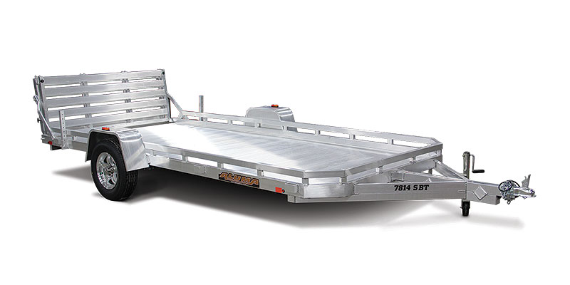

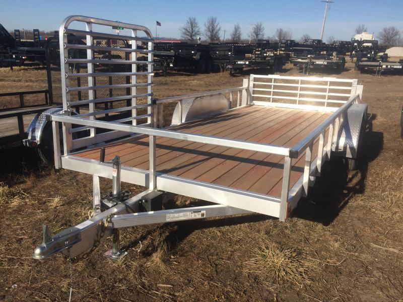

I am in the process of buying a all aluminum utility trailer. I am looking at 6-7' by 12'. I have pretty much settled on a Aluma or a Legend. The Aluma has a all aluminum deck, rail/sides that are bout 6" tall and a bi-fold back ramp/gate. The legend has a full ramp at the back, a wood deck and rail/sides that are about 15" tall. Has having a tailer or shorter side around the trail have any advantage - taller over shorter or shorter over taller? The pictures below show the rail difference.

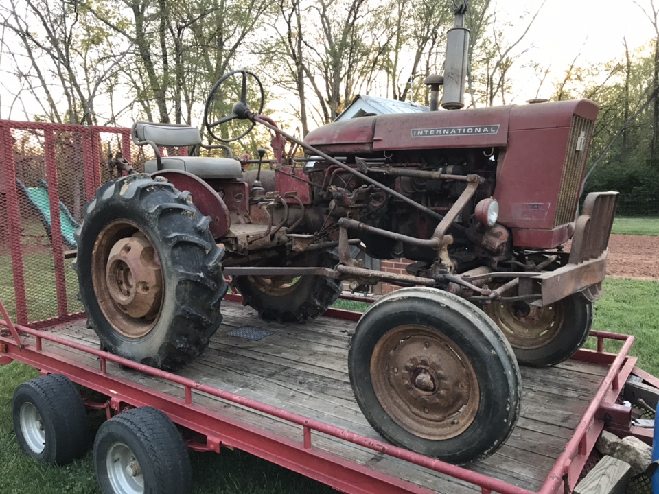

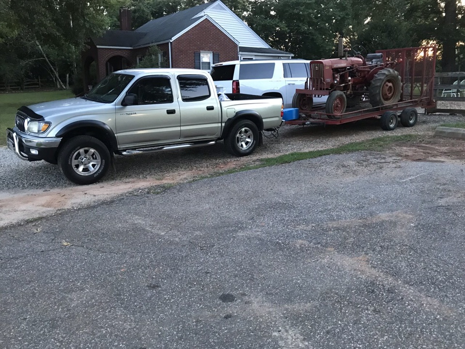

I have a 6’ X 12’ with low sides and absolutely love it. A friend of mine made it in 1981. He was a pipe welder, RIP Wayne.

IMHO,
I would not have a wood deck ever again. I am a maintenance free fan.
I am also not a fan of full tilt up rear ramps as they act like a parachute and reduce tongue weight when empty.
Side rail height to me doesn't matter much as I only use it for tie downs.
I would pick the Aluma I guess. NICE looking trailer too.
   / Utility Trailer - What type of design worked best for you. #5
My preference would be the higher sides and wood deck. Plus the dual axle and higher load capacity for a 12' long trailer. Once you have a trailer like that, you will find more things to haul with it. Or your friends my ask you to. Wood decks last long enough for me and can take a beating in the mean time. Not as slippery when wet and better for cribbing and blocking thing in place. Again, just my personal preference.

I see that you are in NC but your tenderness cause's me to ask if Wayne hung his hat in the Tx panhandle? His creations are treasures.
No he didn't, he lived up the street from my parents in NC as long as I knew him.
