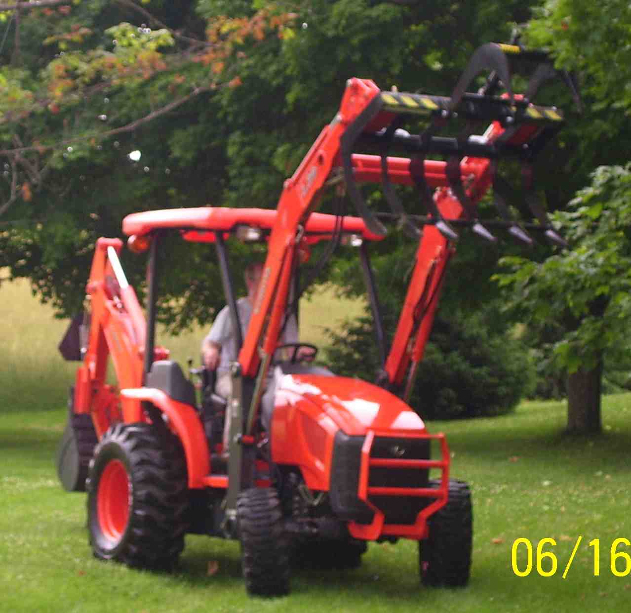

Could you please describe the front forks that are pictured on your tractor: brand and size.

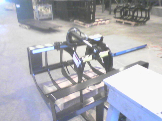

Gardener,
I think you are referring to the grapple bucket. Kinda tough to tell that's what it is in the profile pic. It's a Millonzi 48" Light duty grapple bucket. I got it for $700 ( no shipping - I pick it up - 1 hr drive). Really like it. Have used it quite a bit. Haven't posted any project updates yet (been too busy playin') but I've got plenty of pictures if you'd like to see more. The first included here is at the factor. Took it with my cell to send to the dealer along with pics of the Hyd. Line ends so they knew what couplers they needed. The 2nd pic is the first day testing the controls out. Let me know if you wnat to know more. May want to check out IslandTractor's post.
Very impressive!
I thought that I was looking at a set of front forks. I don't think I'm going to need a grapple. We chip all of our brush and tree limbs after several years of enormous burn piles. I do foresee the need for some forks to replace the FEL on certain occasions.
Thanks for two great pics and the information. Should a grapple become needed, I will definitely re-visit the subject with you. This design looks perfect.
