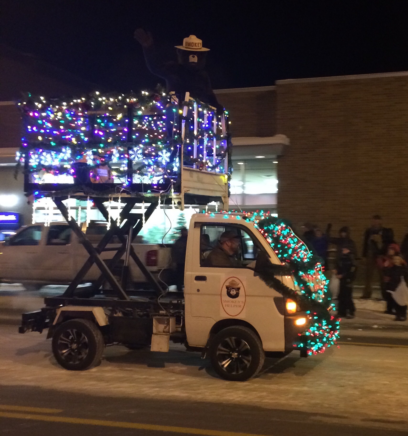

I have one of these, but without the lift, just a regular bed. It's great, I love it. But it's pretty tiny, the whole thing moves when I get in, curb weight is around 1500 lbs. I can't help but think the lift would be unstable with any kind of weight in it.
Mine came with outriggers for the rear. I designed and fabbed square steel bumpers for it with integrated receiver hitch mounts in the ends of the bumpers, to mount trailer toung jacks as outriggers, and also fabbed up a set of OSHA compliant rails for the bed, which mount onto the hinge points for the stock bedsides. You can't really see the bumpers in this photo but the bedsides are on it. Black Friday Parade of Lights a few years back.

That's a beaut! Love the rims.
