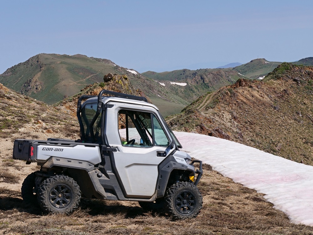

10 psi in all tires on my Can-am Defender...27x9x14 front tires and 27x11x14 rears.

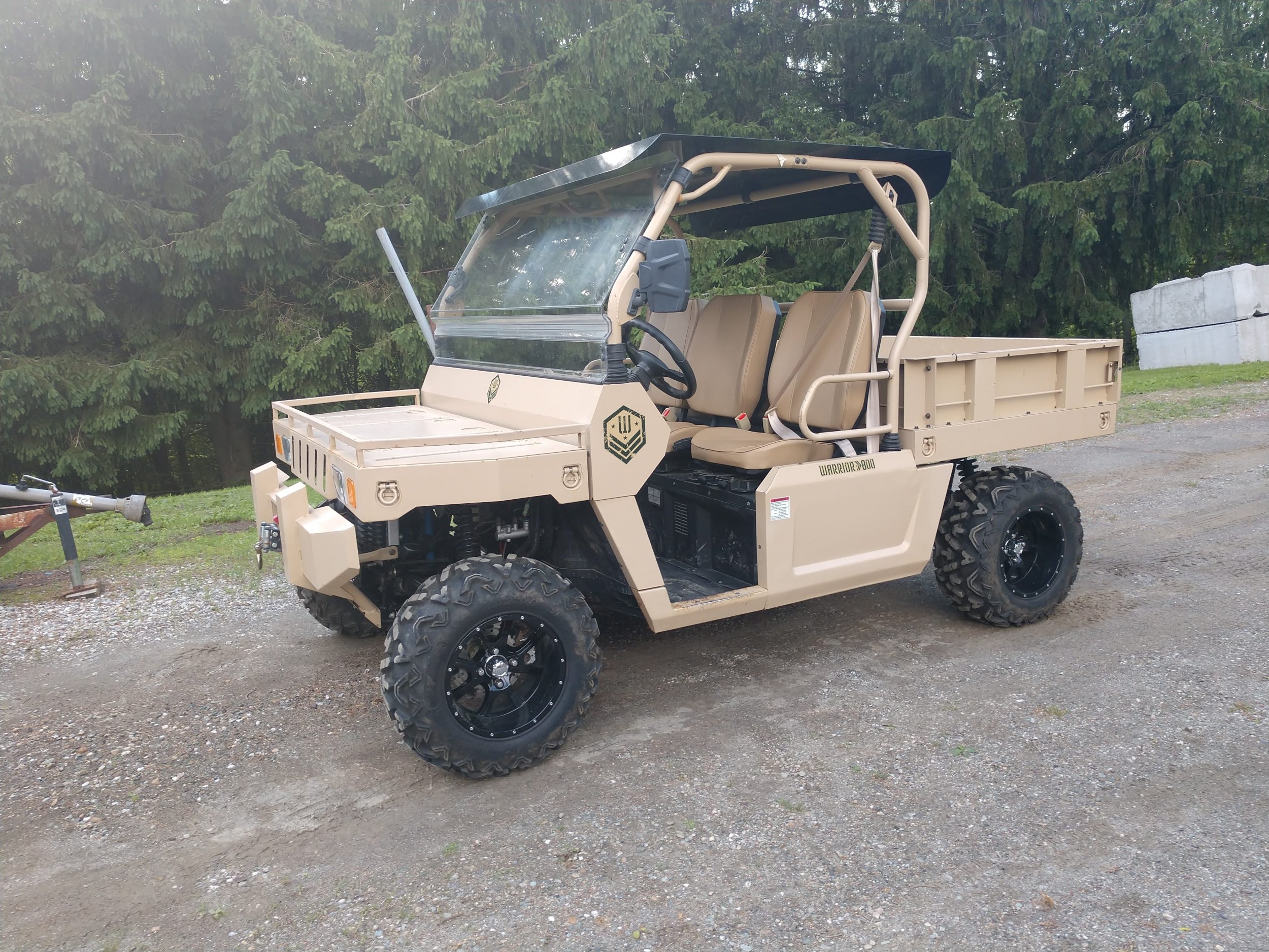

I run my Warrior 800 at 12 PSI,
I almost never run any of my tires at the tires max pressure, that pressure is for when the tire is loaded to it's maximum capacity.
