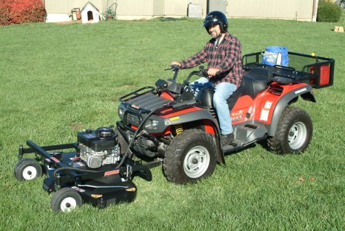

Are there any front mount mowers that can be mounted to a ranger?
I have some idea's to fabricate a mount system if there aren't any available.
Aside from this guy being way to cool wearing a helmet mowing the lawn, I like this setup, but on a utv.
/ UTV vs boxblade and mower #11
Bobcat has their small utv that has the front hitch system. It is also available on the ClubCar version and maybe on the Husqvarna version also since they are all basically the same machine. I think there was a mower option for that UTV and it was priced close to the Ranger.
