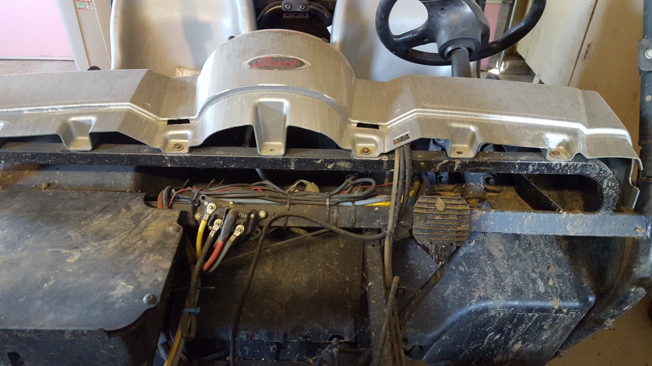

Anyone familiar with mounting 12 volt winches? I have a (12)Yamaha Rhino, and a Warn 3# winch, with very few instructions if any. Trying to find out where to mount the contactor and how to wire it. Form the small black and white pic. looks like it's mounted near the brake cylinder.

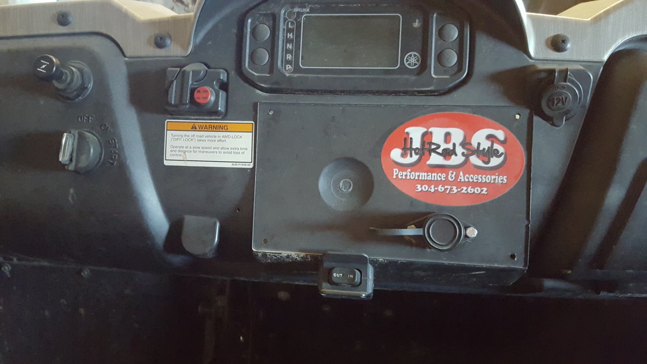

Now the hard part, where dose the contacter go, the small fuzzy pic that came with it was no help. The first thing to do is find the battery, find the cables that go from the battery to the contacter, usually those cables are 1-2' long, and that tell's where/how far away the contacter goes from the battery. The guy at the ATV place I called said he mounts it to the plastic battery case, just be careful not to drill to far, but didn't really like that idea and the bolts that came with the contacter was square U bolts so that would not work, I decided to mount it on the frame on top of the Vertical Post<sticks up 1/4" above frame, and that 1/4" V P keeps the light cable from being squish squash. Most of the frames have cable already tied on them, dont like moving existing cable either.
The next hard part was, where dose the switch wire into? The guy I called said he uses the hot wire from the ACC. socket, formally knowed 50 years ago as the cigarette lighter socket. The (switch plug in socket) instruction said to drill 7/8" and 2> 1/4'' hole's below the warning sign, that sounded good and there was plenty of room behind the dash.
Tip, a right angle Dewalt drill adapter came in handy for this and I drilled 2> 3/16 holes so the 2 small bolts would fit snug and stay there while I get those 2 small nuts on behind the dash, and after the 7/8 hole is drilled, I temporally set the socket in, then I took a 1/4 drill bit by hand and scored the mark where to drill the 3/16 holes, it's all down hill from there, this 8 hr. job I could do now do again in 2 or 3 hours, guess that's called a learning curve.

This winch kit didn't come with a winch control holder, somewhat easy to make, very difficult to install, used two washer head wood screws, from behind. One slight miss-calculation, had all kinds of room for the sifter, didn't think to put it in gear before I screwed it in place, use the Rhino today, put it gear, ended up with about 2- 3 in. clearance. I'll go with that, sick of working on something that should of already came with a holder.
