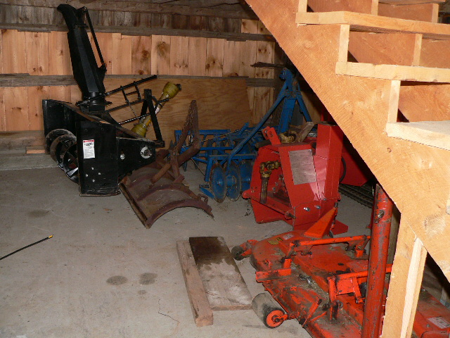

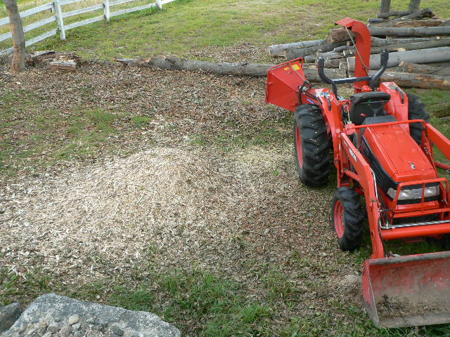

I have one with the hydraulic driven feed and it is awesome. I run it off my 3710 and it will take 8 inch logs. I think the biggest I have ever put through it was some 6 inch beech (blow downs, before I was heating with wood).
Your machine will run a 150. You will need to temper the feed so you don't over load the chipper as 25 HP is not strong enough to power through heavy stuff. The beauty of this is it trains you to pay attention to tractor engine speed and work with the machine rather than doing something stupid.
I have run the chipper off of both tractors, a Hesston 100 - 90 (which will twist that chipper into a pretzel before stalling the engine), and my 3710 which is a much better match for it as the prox 35 PTO HP will not overpower it.
You paid a VERY low price for the unit...... it is worth twice that.
