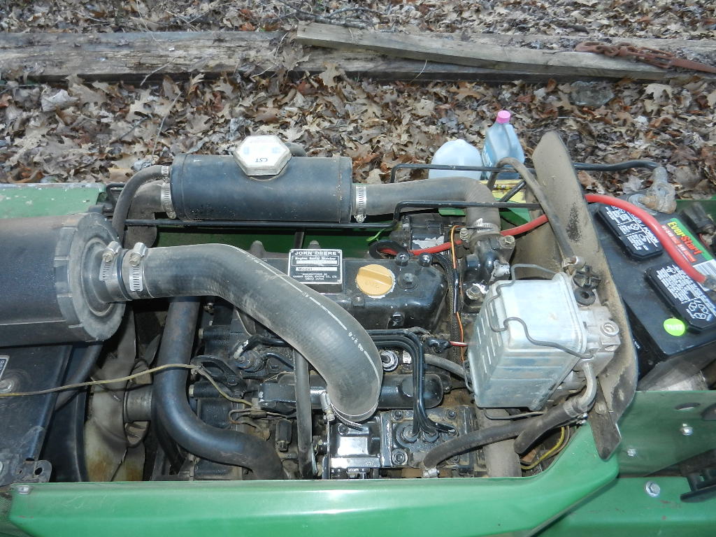

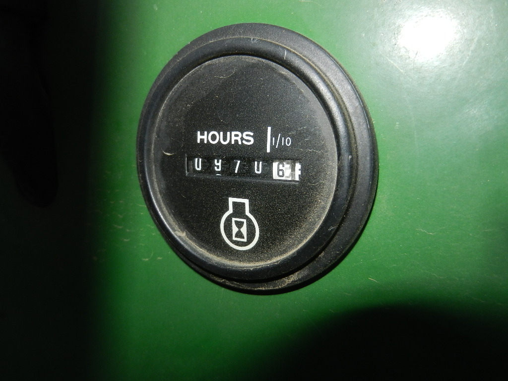

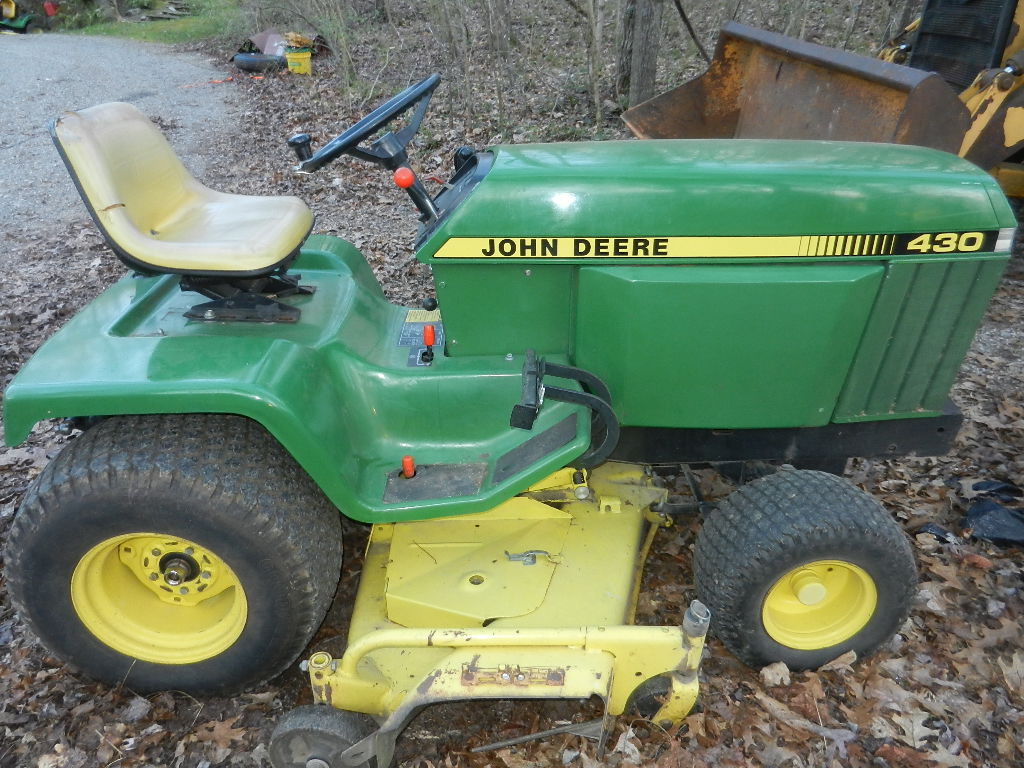

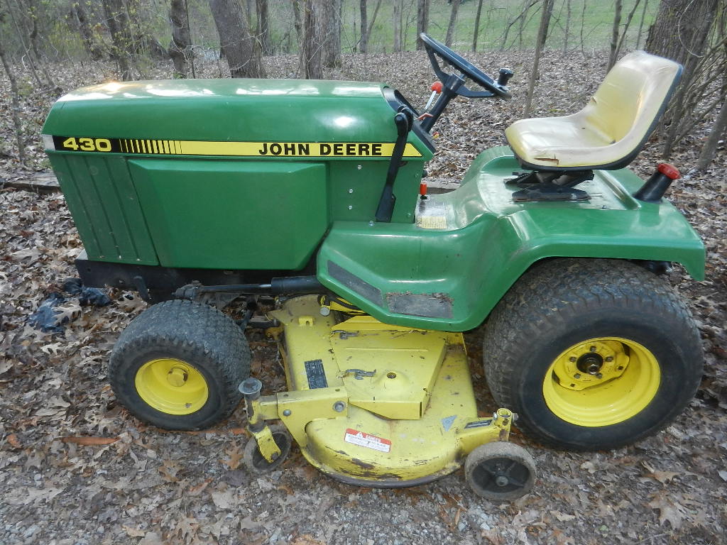

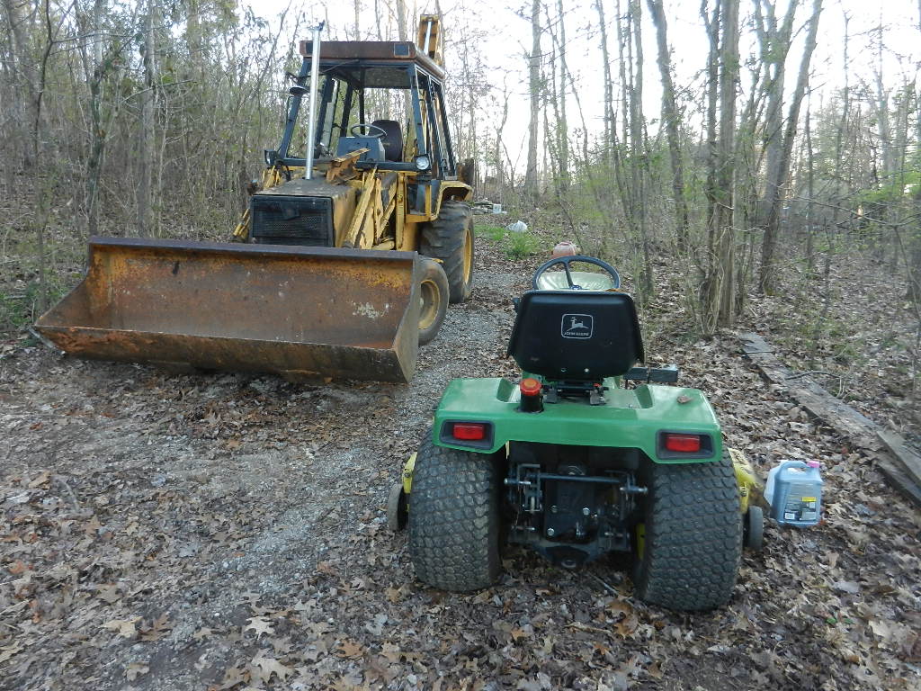

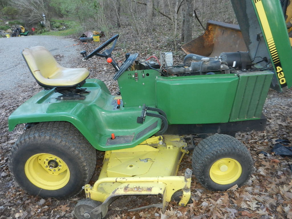

Here ya go!!
Given where it's parked, I thought I'd include my backhoe for some scale. I could do that without moving anything. My other tractor (IH 1066 is parked such that it can't be included in the picture. I told my wife's cousin (lives next door) we should line up the various items in the field and have a fleet photo.
(for riding machines, he's got a JD Gator, IH 444 and I have the above items)
