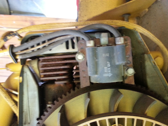

Could it be the ignition coil? How do I test this?
   / vermeer 206 stump grinder #13
coil will not affect it turning over, only affect the firing of the sparkplugs
