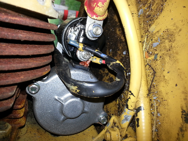

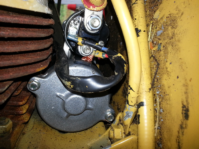

I have a pic of solenoid and starter but tbn android app keeps crashing when adding it. Will try from Pc in a bit.anyway When testing between the battery wire on the solenoid to the ground I get 12.4 but pos on either of the other two wires (blue and red) on the solenoid there is no reading.

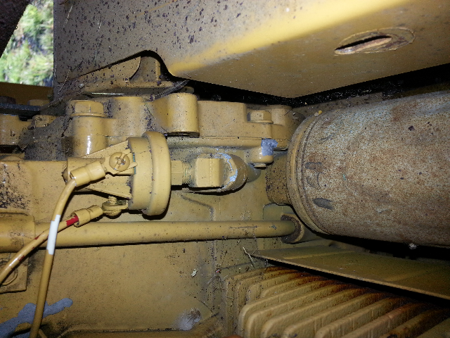

The yellow painted thing you show in this single pic looks like it could be the oil switch I asked about. I can't tell where it's located from the switch, but if you connect those two wires together, if you can get them removed from the 'oil pressure switch' what happens to the key switch, (ignition circuit)?

The yellow painted thing you show in this single pic looks like it could be the oil switch I asked about. I can't tell where it's located from the switch, but if you connect those two wires *together, ( *red and white wires) if you can get them removed from the 'oil pressure switch' what happens to the key switch, (ignition circuit)?
I'm hoping that the round yellow thing is the oil pressure switch and it is not functioning, or because the wires are painted it could have a bad connection. Either way, if you connect red and white together, even under the same screw on the switch it hopefully will complete the circuit and allow you to use the key switch to turn the engine over....
Just use some sandpaper to clean the wire terminal ends so they are nice and shiny with no paint.
   / vermeer 206 stump grinder #40
this is located on the front of the engine just above the oil filter so it could very well be the oil pressure switch odd though that it connects to the hour meter. It looks like paint was sprayed at the end of assembly after they installed all the wiring. i'll try connecting the two wires together tomorrow. thanks!
