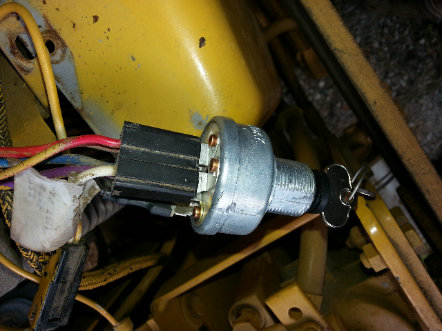

Are you saying you are testing just the female connector that the ignition switch connects into, or is it a male wiring connector that plugs into the switch? I'm not clear which you have.
A pic would be helpful if possible.

The diagram in that pdf link is accurate only addition is a wire between the battery ground and the kill switch ground. The kill switch is on the far left in the picture labeled "shutdown". Also attavhed picture of the switch and harness. Tested between pos on battery and the white wire on the harness I only get .4 volts. I expexted this would read 12.4? Am I wrong?

When I flip the kill switch to KILL I get a 12.4 reading between the pos on battery to the white wire at the ignition spade.
So what do you get if you plug the ignition switch back into the harness, AFTER turning the kill switch off and then to 'kill' once you've connected the harness back up?
   / vermeer 206 stump grinder #30
After thati get 12.4.
If I turn the kill switch to ON
then I get 1.4
This is while the ignition switch is switched to "RUN"
