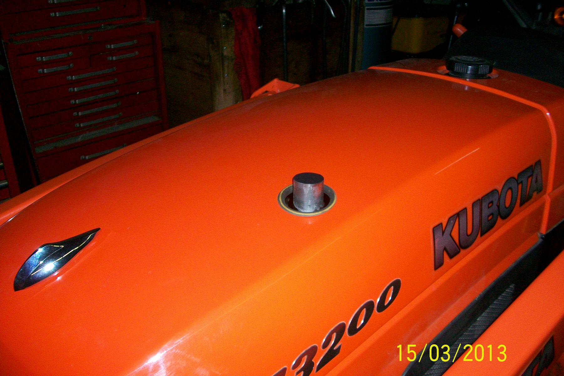

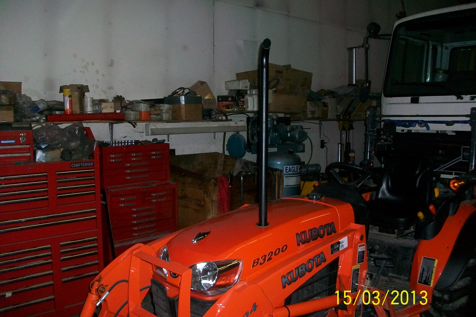

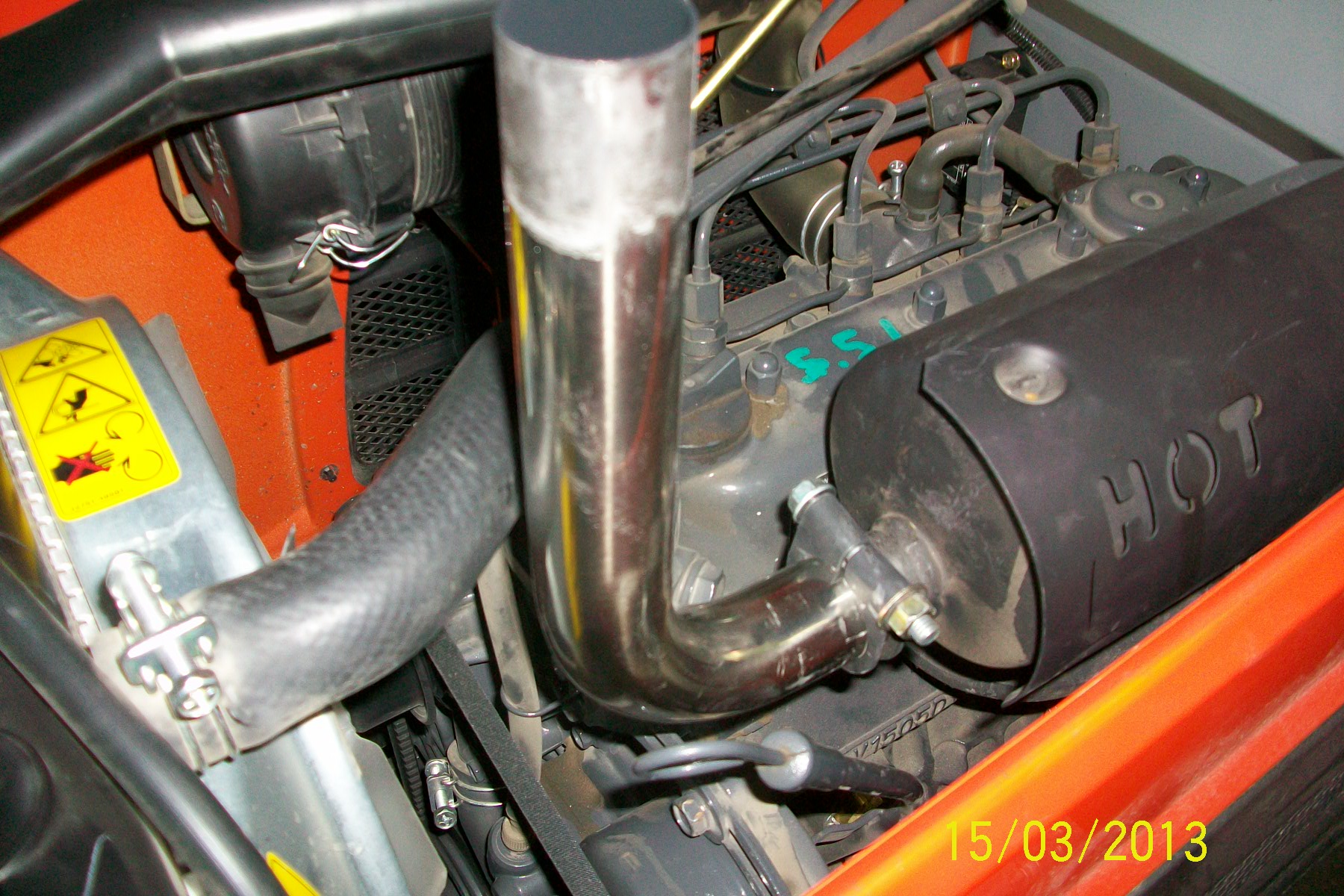

Anybody do a vertical exhaust on their B? I did to my B3200. I got tired of soot on everything. I got a short bend 90 and went straight up from the outlet of the muffler. It did involve cutting a hole in the hood but I must say once i got over that I am very pleased. It involves pulling the stack off to open the hood but that is a 2 second job because it is a slip fit. I will post pics in the next day or 2 if anyone is interested.
Yes, post more info or pics. I converted a compact Ford years ago and added a slip joint on the pipe so I could open the hood. My original purpose was to add an air filter pre-cleaner and it worked great.

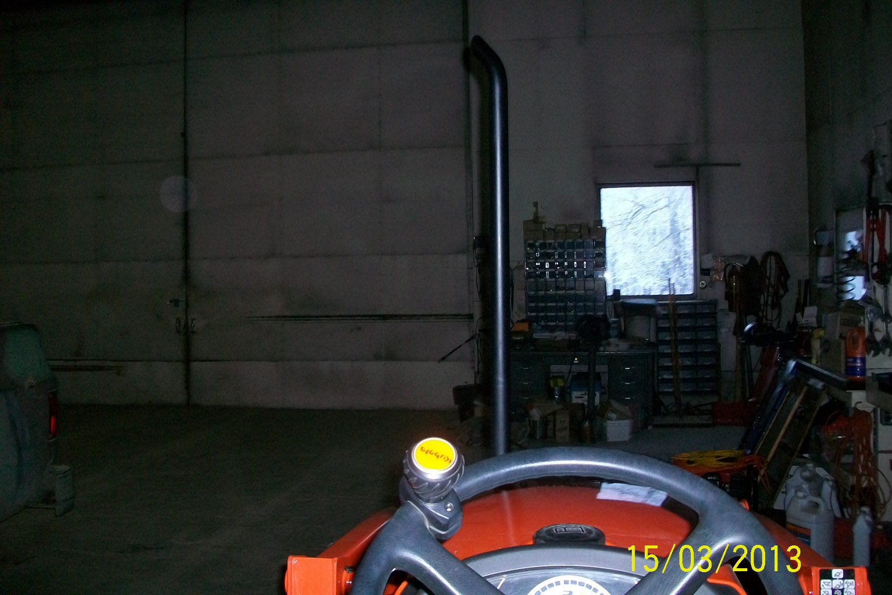

101_1124.JPGHere some pictures. They did not turn out so well but you get the idea.101_1121.JPG101_1122.JPG101_1123.JPG

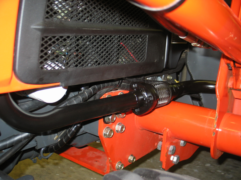

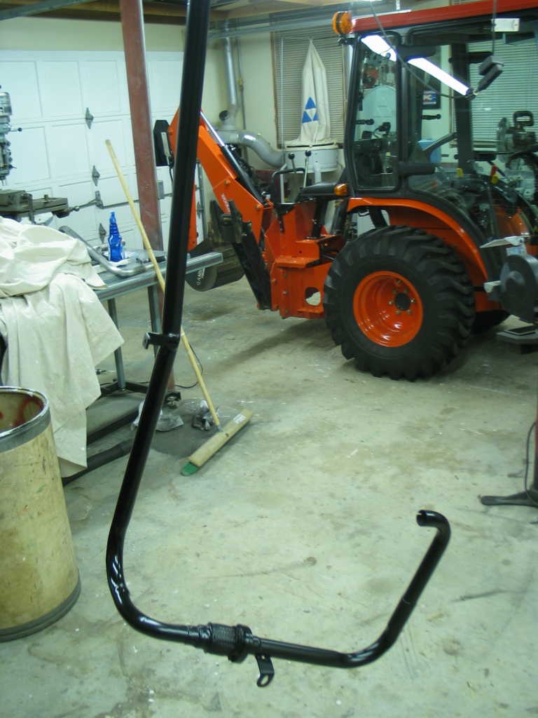

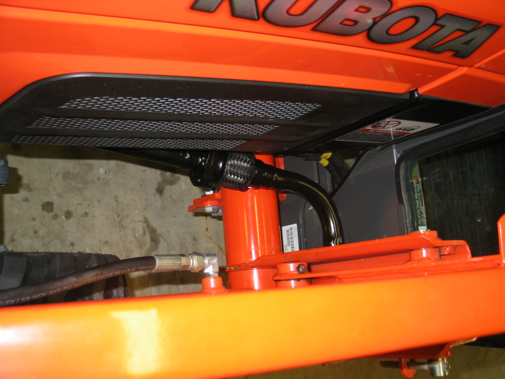

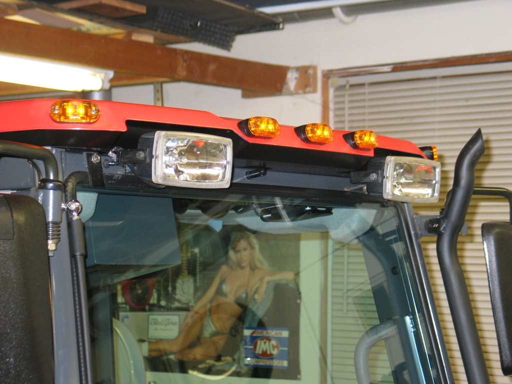

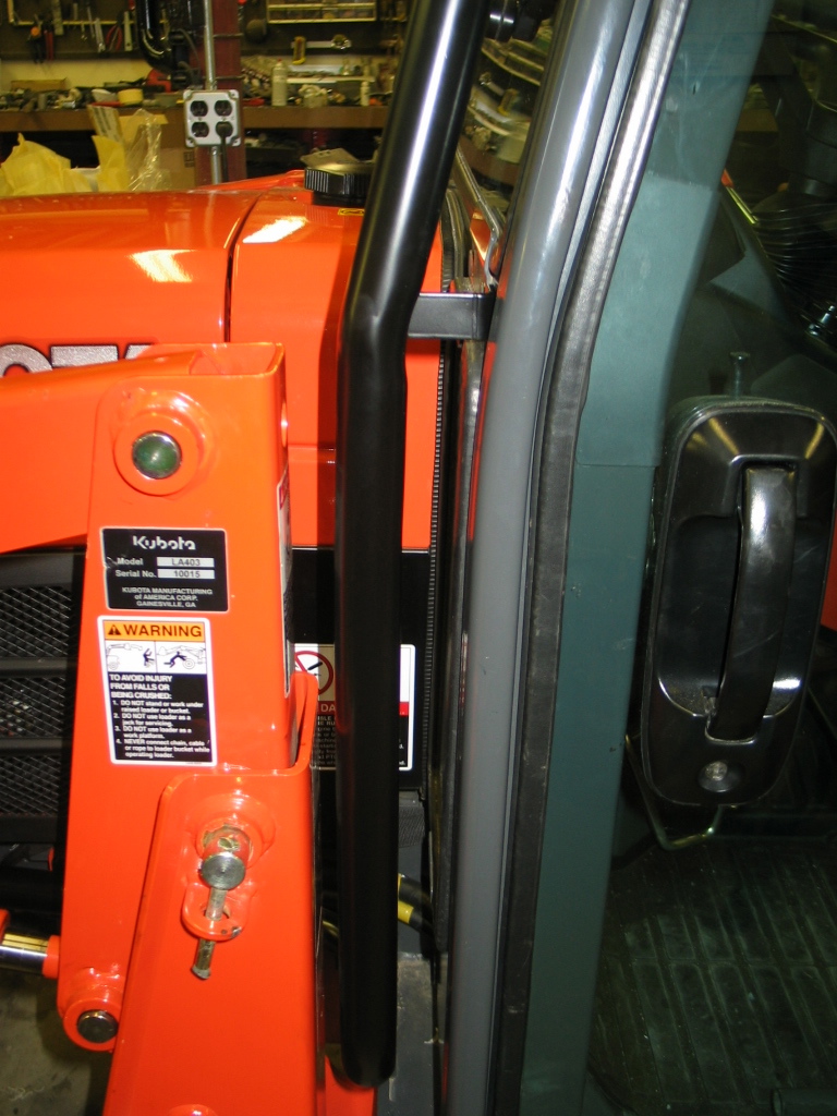

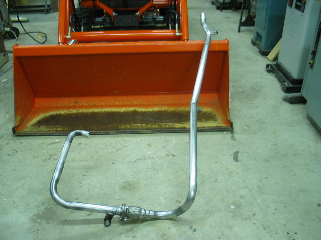

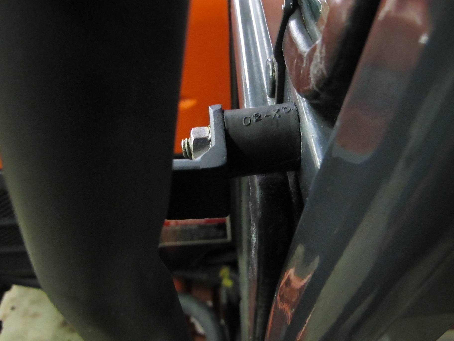

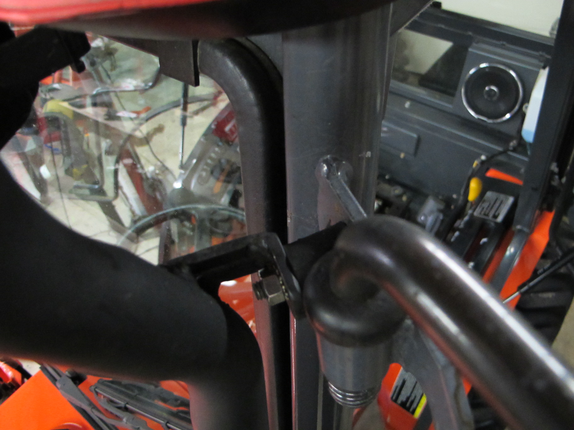

I made one for my B3030, it follows the cab frame. Works great.

Both look very nice!

<img src="http://www.tractorbynet.com/forums/attachment.php?attachmentid=308277"/>Here some pictures. They did not turn out so well but you get the idea.<img src="http://www.tractorbynet.com/forums/attachment.php?attachmentid=308271"/><img src="http://www.tractorbynet.com/forums/attachment.php?attachmentid=308272"/><img src="http://www.tractorbynet.com/forums/attachment.php?attachmentid=308273"/>
Hey kuboman did you do anything to insulate the radiator hose? From the pics it looks like its touching the exhaust pipe.

Very impressive installations. Both fine jobs.
