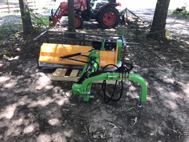

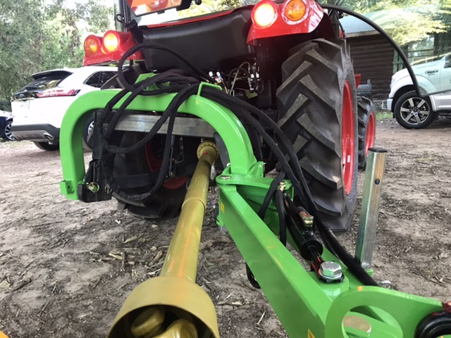

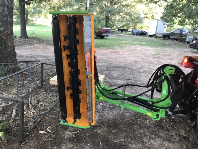

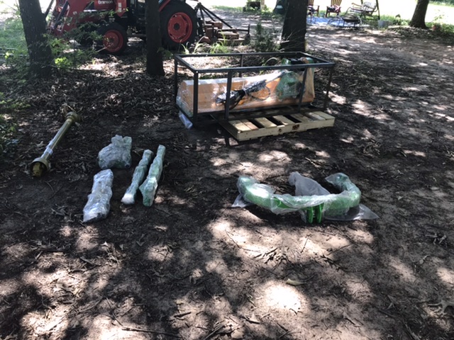

I wanted to update this thread so anyone looking at this mower will have a reference.
The mower arrived in good shape. It was packaged well.
1. The claim that it fits most quick hitches is not entirely accurate. The spacing is fine but it hits the swing arm nut on my SpeedCo. Also the PTO shaft could hit the top of the QH if set too low. I am about 90% sure I will not use the QH for this mower.
2. Overall construction seems to be good. Welds are fine and overall the framework is designed well.
3. The PTO shaft is not the best quality. The push release button popped off just connecting it once.
4. The appearance is not bad although time will tell the quality of paint used.
5. One of the support legs can not be pinned in the up position. Both legs are identical and the manual states one should be longer. Most likely this was just a mistake and they probably will make send the correct one.
6. The manual is not very accurate on several fronts but overall was helpful.
7. Routing the hoses to where they will not interfere or drag the ground
will be challenging. Still working on that.
I have not mowed or engaged the drum yet but did check the offset and full range of the tilt. At this point I would say it is worth the price but it definitely definitely has some room for improvements. That being said, I am satisfied with my purchase and feel it will meet my needs.
