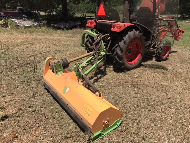

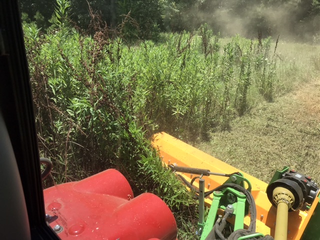

Here is some pictures of the first day I used it.
   / Victory Ditch Bank Flail or Bush Hog 216 Rotary Mower? #17
Hello K5lwq,
You can better manage the hoses by using large loom clamps. Any good hardware store will have them in stock.
You will need to drill into the three point hitch frame steel on the mower frame to mount the loom clamps in place. Its better to do it this way rather than routing the hoses through some steel tubing welded to the frame.
About the middle picture image; can you tell me why the lower links of your mules three point hitch are not level??? Are you simply letting the draft control sink to follw the ground more closely??
I have since found a more happy medium for the level of the lower links. When you side shift it lifts the one side up a bit. When the mower follows the tractor it is level. Where I have it now it is not as bad as that picture but certainly not perfectly level.
I am getting a very level cut where it is now so I don't see much issue with the swing. Not sure anything can be done to minimize change unless I wanted to adjust for when I want the mower to the side and readjust when I wanted the mower behind me. Without adding more remotes and a tilt cylinder, I would have to do this manually. Do you foresee a problem that I am not considering?
   / Victory Ditch Bank Flail or Bush Hog 216 Rotary Mower? #20
If you have 2 levers for the draft control I would take the left lever and lower it all the way to level the lower links to make sure it comes back to center.
The way the three point hitch it is set up now you essentially are burying the toe of the mold board plow for a deep suck. These mowers work well with both the lower links level when mowing.
