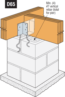

The only thing that I have seen that I'm not wild about is the way they made columns to support the girders. Column stacked blocks lack lateral strength, and I couldn't see any way that the girder was attached to the pilasters. There may be fasteners that I can't see, though.
Are the pilasters filled with concrete and rebar?

They are filled with concrete, no rebar. They are not connected to the girders. The continuous foundation has rebar running uderneath. My old house had individual piers, block not filled and no rebar. There was terrible shrink swell but my home was not affected. I don't see how they could move now that they are locked in place? County gave it a thumbs up, but that is not much of an endorsement.😊

I've never seen main beams attached to the columns at least here in VA -- they always just sit on top. So that seems normal to me. I believe that the block stacking arrangement is based on the height required and the footing area required. In our home, some are single stacked like shown here, while others are stacked double wide for the bottom 2/3 and single wide for the top 1/3. You are right rtimgray that there is no real lateral (buckling) strength, so it would seem there isn't a buckling concern.

hcallaway - as long as you're satisfied, that's all that matters. The only time it would really matter is if the building were to be subjected to severe lateral forces like in an earthquake or hurricane-force winds. Basically, without reinforcements and connections, as soon as there is any sideways force, the column is likely to topple and leave the girder unsupported. If the column is connected to girder, if it is subject to lateral forces, then the whole thing should (theoretically) move together.
If the area that you're building in isn't subject to earthquake or hurricanes, then I wouldn't worry about it. Again, what I'm used to in this area is double wide interlock pillasters. The footings have J-rebars that go from it to the top course, and the top has a sill plate anchored just like the perimeter sill. Then there is usually a metal bracket to connect the sill to the girder. In the end, it makes a stronger support and more integrated structure; however, if it is never subject to such forces, it's just a waste of money!

I'm sure that you're foundation is fine. After all, it doesn't matter one bit what a knucklehead on the internet thinks compared to the engineers/designers/inspectors (and I promise, I'm saying all of that seriously, not sarcastically). All of the information that you give leads me to believe that there is no need for consideration of lateral loading in the area that the house is being constructed, as all of it pertains to compressive strength, and I'm sure that the engineers/designers/inspectors know what the prevalent conditions are.
Just out of curiosity, I searched for "girder to pier connection", and this was the third image result. For clarity's sake, this is what I was talking about and have used similar means in the past. I looked at the Simpson Strongtie website under masonry connectors and they show a range of products. Again, the use of this type of material is this situation is obviously unnecessary, but I thought I would post it for anybody who was following the thread and was curious about what I was talking about.

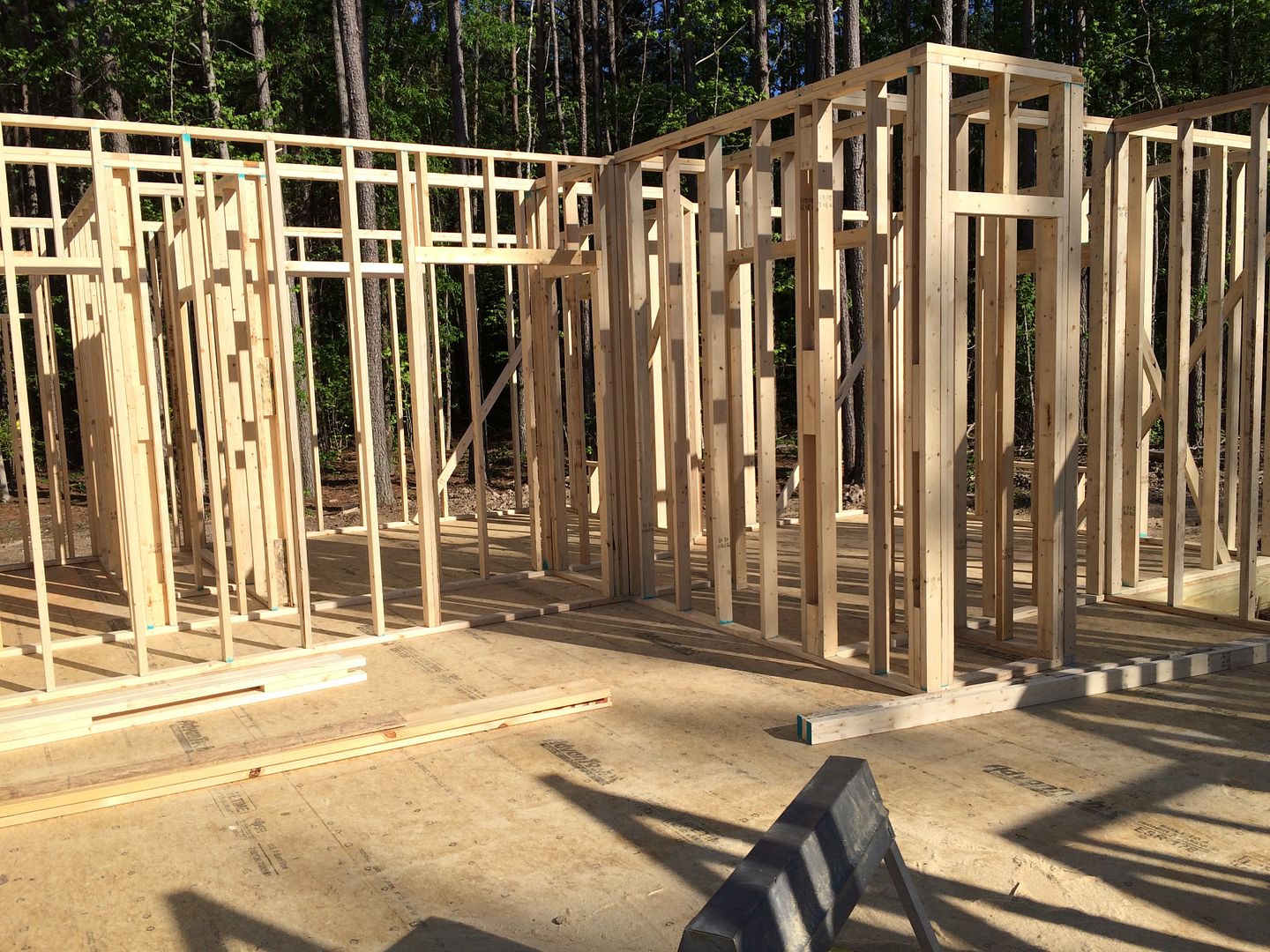

The framing has started. Trusses will be up next week.
