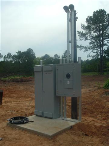

Eddie in your first post you said you have 1200 amp service. Are you sure? Man that is a bunch. If you are already feeding 600 off you may want to make sure. You don't want to melt the meter like I did last week on 320 amps.
Now as far as running power that far I am thinking I would let the power company handle it.
   / Voltage Drop for 750 feet advice needed
#33
Old picture, but this is my meter and 1,200 amp breaker box
Eddie

[As a side note: Something seems out of whack. In the picture there's 2 risers with weatherheads, presumably for the service drop from the pole. You would need 2 sets of 1000MCM conductors to equal 1200amps.-Not going to happen. I suppose it's possible they used 4 sets of 300MCM, with 2 sets going to each conduit?]
More importantly, did they give you a "single phase" 120/240V or a 3 phase 120/208V service? At 1200 amps, it's would be much more likely they gave you a "three phase" 120/208V service. This makes a huge difference when calculating how much power you're sending down the line.

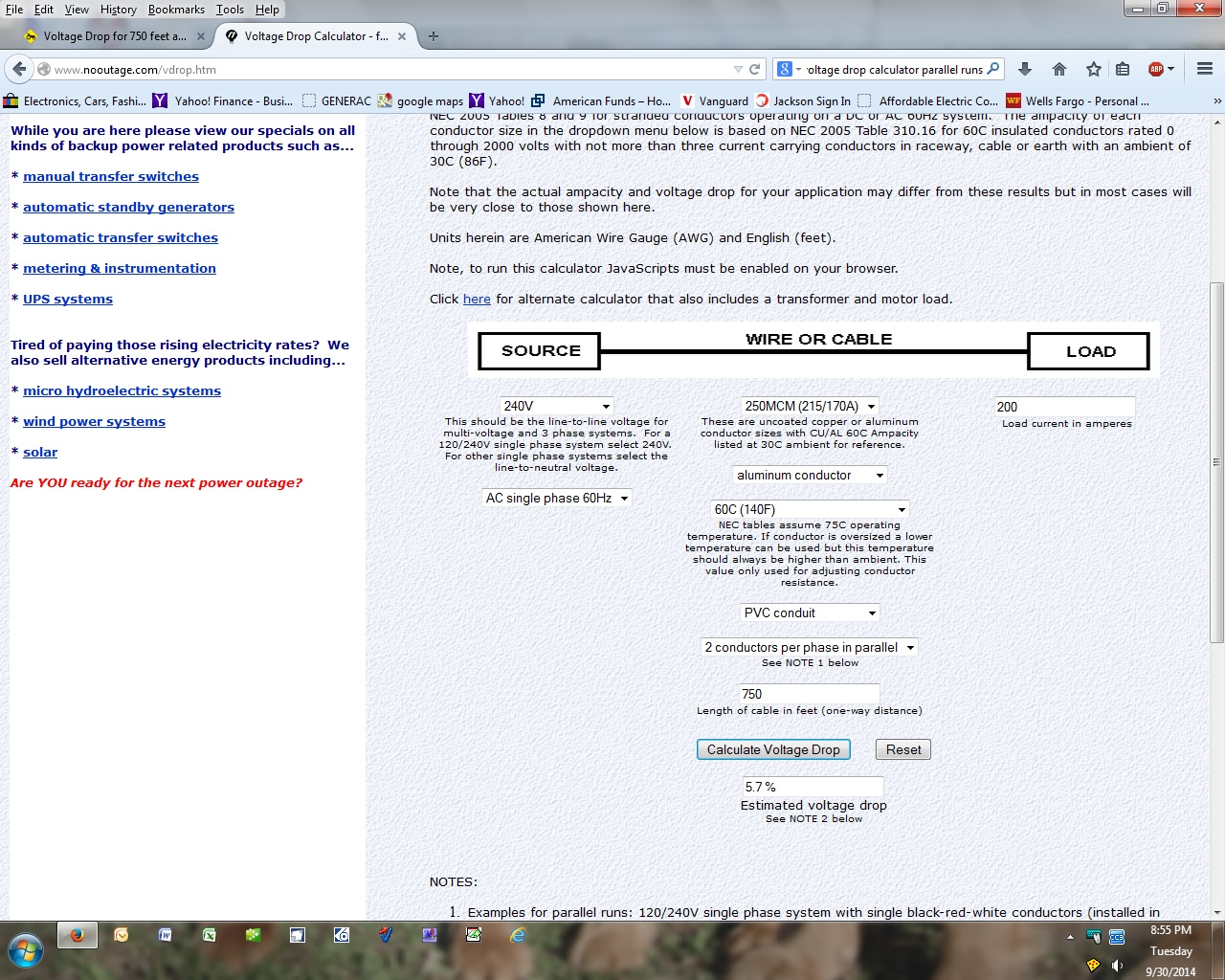

eddie,
does your area allow multiple (parallel) runs to supply power. Here, i can run, say, parallel runs of 250 MCM runs (2 hots, a downsized neutral and a #4 ground) in a 2-1/2" or 3" conduit and that would satisfy the voltage drop requirements.
this is much easier to run than 500 MCM wires. and alot cheaper.

Personally, i ran the voltage drop calcs for your situation, and you could get by with 400 MCM with a 5.6% voltage drop. thats allowed here in pacific northwest..not sure about texas. Heat affects wire , and were colder up here.

eddie,
I'm not familiar with this and will look into it. Would you connect both hot wires to the same 200 amp breaker or would one go to one breaker and the other to another 200 amp breaker?
