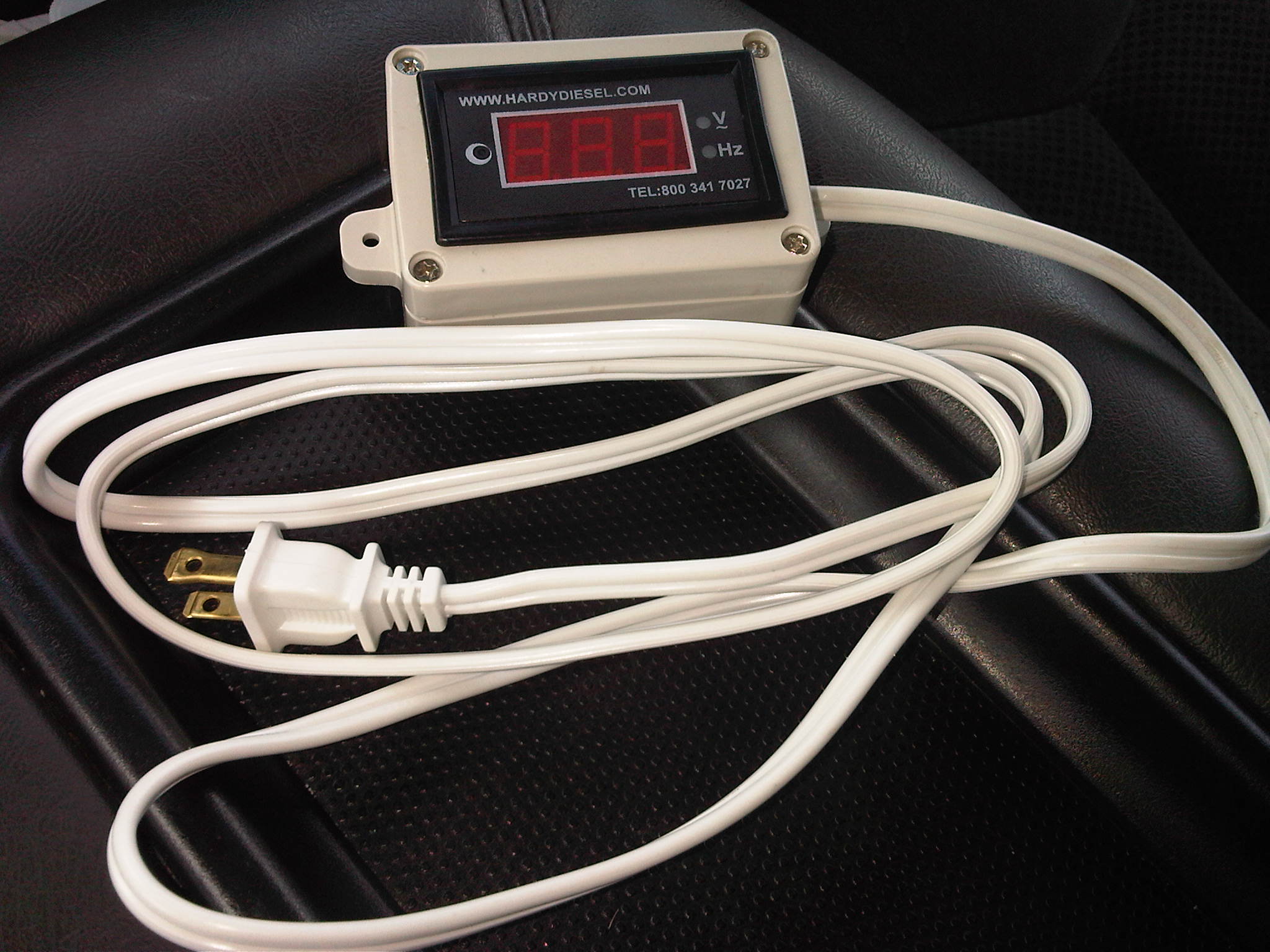

IMG-20120913-00456.jpgIf any of you PTO generator generator users need a frequency meter, there is a $20 one available on ebay or from Hardy Diesel. I found a small plastic box to mount it in and ended up spending $30 on the whole setup. It is very accurate and at that price you can afford to have one at the tractor and another one in the house.

View attachment 283596If any of you PTO generator generator users need a frequency meter, there is a $20 one available on ebay or from Hardy Diesel. I found a small plastic box to mount it in and ended up spending $30 on the whole setup. It is very accurate and at that price you can afford to have one at the tractor and another one in the house.
Sweet advice. I like the way you think

I installed a remote outlet on the carry-all facing the tractor seat and use one of these to set frequency.
Found one on fleabay for about $20, these will show frequency, volts, amps and after you input your power companies charges per kw will show you operating costs for a day, week, month or year.
It's interesting to plug it into various home items and see what they are costing to operate.
