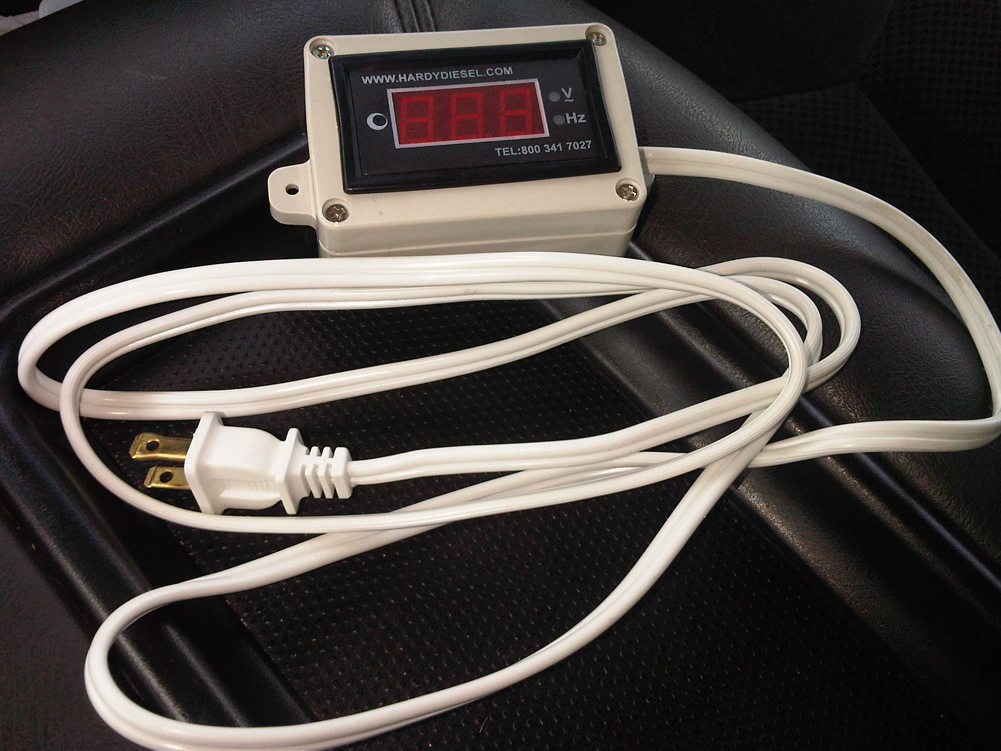

I have the Voltmaster 12/15 and I have not been entirely happy with it. My problems have been:
1) To keep the Hz at 60, voltage is always a little to high, usually 125-130, 250-260.
2) My tractor governor doesn't seem to sense the increase in load unless it is significant and so HZ and voltage drop a little more than desired. (Probaby not the generator's fault)
3) After a couple of years, the hole plugs on the side of the generator gear reduction box started to leak. Every year since, it seems to get worse.
What are you using to measure the voltage? How much do you use it or does it leak just sitting there?
/ Voltmaster PTO generator #23
I have several ways, a rather inexpensive DVM, a very expensive Fluke graphing power meter and a simple yet very nice Kill-A-Watt device.
The holes are the plugged holes on both sides of the gearbox, 4 in total. Also, the large black plug on the end of the gearbox and the main shaft seal (gearbox to generator) also has recently began leaking. Leaks faster when running and hot, but otherwise, just sitting too. None of the holes are anything I have touched, but instead those plugged by manufacturer.

Maybe I'm picky, but I wouldn't be happy with 130 volts@ 60hz. You won't be doing your loads or your generator any favors at that much of an over voltage.
/ Voltmaster PTO generator #26
you'r picky...
I lived for 22ys at the end of a street that was consitantly 131vac at the wall socket. ( yup.. and 260! at the dryer! )
nobody died. nothing exploded.
lotsa electronics are rated fro 150v.. and really care most about the freq.
any appliance based on a triac power supply simply won't care from about 90++ with many being universal 120/240 and again.. running 90vac+
even supressor's and clip limiters using old neon bulbs won't be clamping at 130.
only reason I even knew about it was i had a big APC smart ups and large line conditioner.
It had an led readout for line conditions. Our line was always at the 1st yellow led above the middle green one. On rare occasion we would have it adjust line voltage ( you could hear it do so ) bumping up or down depending on a large load kicking on. past that.. it was a real NON issue.
consumer grade electronics are built at least with a 20% tolerance minimum.. we are taling about 8.3255%
standard is 25% tolerance except for some specialty items. ( and many have MUCH% more depending upon design )

That voltage is too high. I took a quick look at the on-line manual, and the manufacturer claims voltage regulation should hold +- 1-1/2% so you shouldn't see over 121.8 volts. It looks like some of the models have an adjustable regulator with a pot adjustment, I would check and see if yours is one of the adjustable models. If not, I would contact Voltmaster and tell them of your problem.

That voltage isn't going to harm anything. Like Soundguy my regular line voltage runs 128 since 1984. Never had a problem with it. My Voltmaster runs 129vac@60HZ and will vary a tad with load. HZ is what I shoot for to keep steady. Oh and I've been an industrial electrician for 27 years. Work with ac voltage from 120 - 24,900. I'd much rather have voltage on the high side than on the low side. example: Allen Bradley I/O cards on PLC 5 won't operate below 108 vac. They work great at 125. When voltage goes down , amps go up. When amps go up because of low voltage things tend to run hotter and cost more to operate.

The manufacture's manual says their product should be 120 volts +- 1-1/2%. The poster said he wasn't real happy about it, and I wouldn't be either.So I don't get the point of the debate? Nobody said you can't run your own generator at whatever speed and voltage you want. My line volatge holds right around 120v. I expect my genrator to supply my house with the same voltage as it normally sees. I guess I'm just picky like that. A lot of appliances such as light bulbs have a much shorter life at 130 volts.
"When voltage goes down , amps go up. When amps go up because of low voltage things tend to run hotter and cost more to operate"
That ambiguous comment is totally wrong in many,many, many, instances. You should know better than that with your posted profession. Set your generator running your normal house at 130 volts and measure the current. Then I want you to bring it down to 120 volts, make your measurement, and get back to me.:cool:

My portable generator does hold 117-122 with varing loads, except for when the deep well pump kicks on. No luck needed at all. It's not a big expectation from a generator to simply do what it is supose to do- produce current at the designed voltage. That's all it has to do for the $1000 you pay- produce a 240/120 regulated voltage.
And yes, If I bought a new car and the spedo showed 65 when I'm doing 75, I wouldn't be happy with that either.
All the other discussion aside.
I DO agree that if they claim their machine shoul run in a certain voltage range, at correct freq, within rated load.. then it SHOULD do that. No argumens there whatsoever.
I'm guessing the ones ith an adjustable regulator might be an active andoe precis ystem, vs passive capictance regulation. I have an oler northentol chinese model.. I have the manual around her somewhere.. but 130v is withing their stated range.. guess they ween't raising the bar too muc.. :)
/ Voltmaster PTO generator #38
I have a chinese diesel generator and it is the brush type. It has an AVR (Automatic Voltage Regulator) that can be adjusted to tune the voltage. The AVR will adjust the voltage to the brushes up or down to change the output voltage. My 15KW brush type HF PTO generator is set up with an AVR as well.
