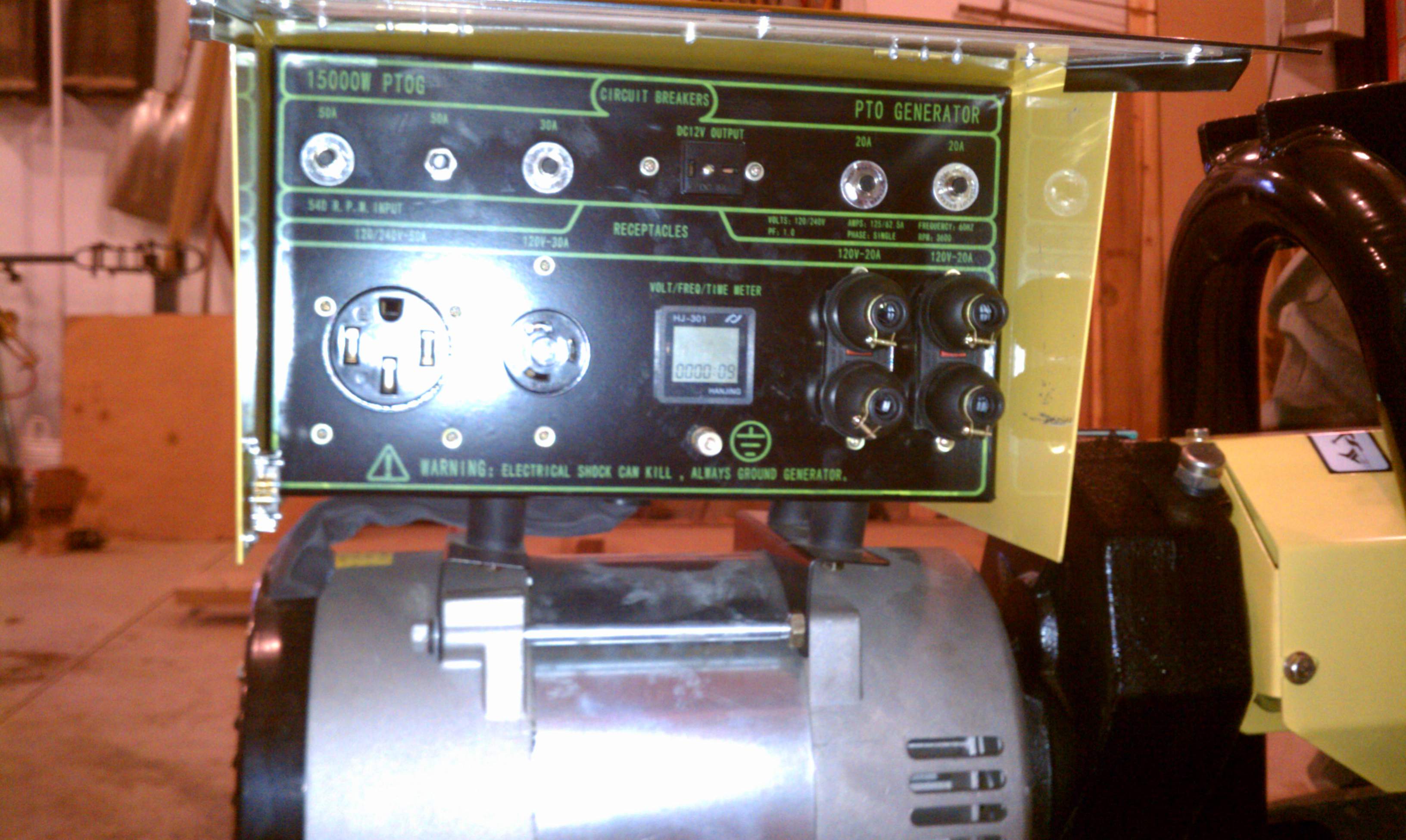

It states it is a revolving field, alternating current generator. The parts diagram refers to it as an alternator and I do not see any reference to brushes. Wouldn't there be brush access covers on the sides of the generator if it were a brush type? Also the fact it says it can generate 15kw constant and 16kw surge suggests to me it is a brushless type and brush type generators are much better at handling surge loads. As you probably can tell, I am not an electrician and only have a healthy desire to not be killed be electrocution. It is the exact same unit as sold by Harbor Freight and Torq and references the name "Segma" in the owner's manual. Pictures soon to be posted.

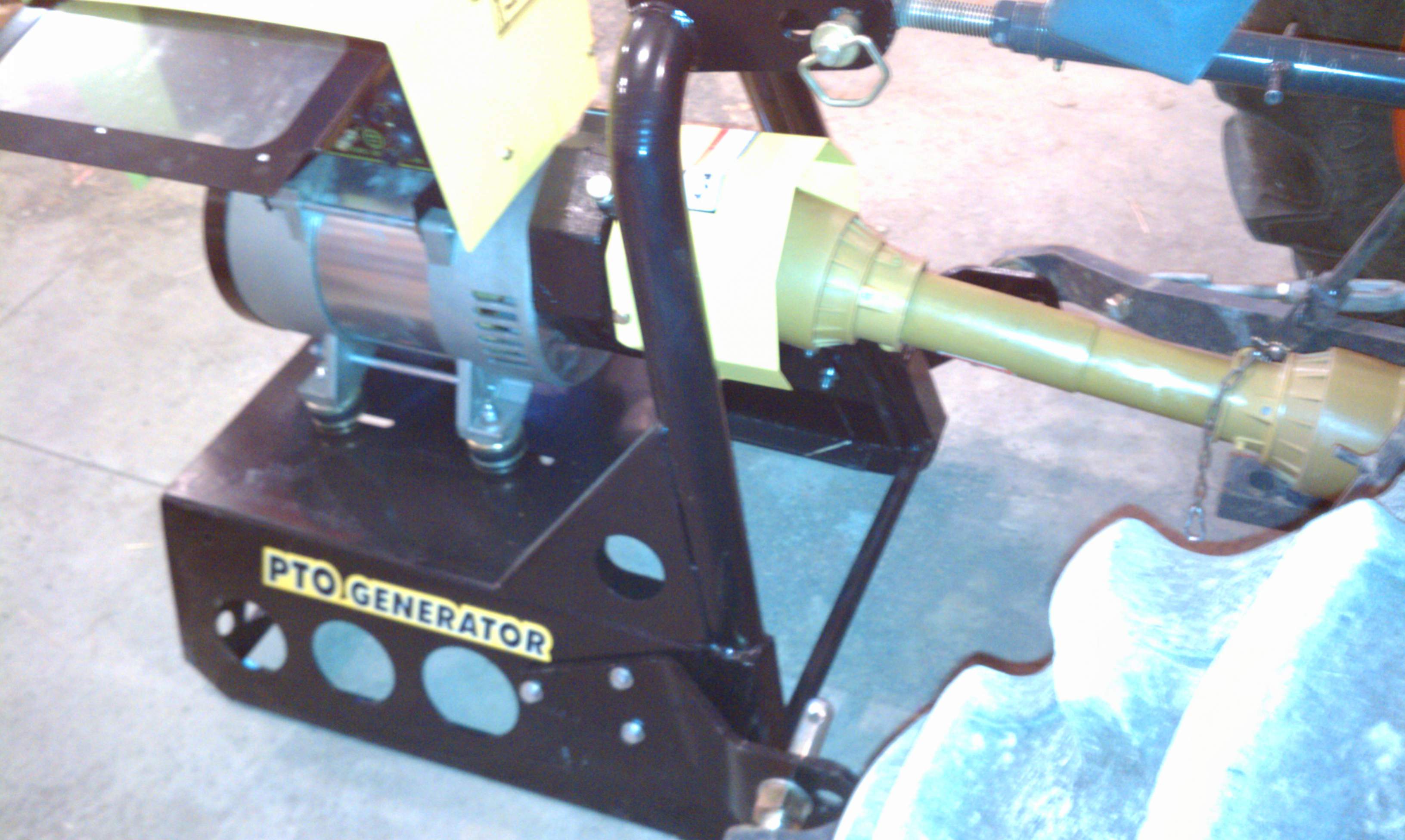

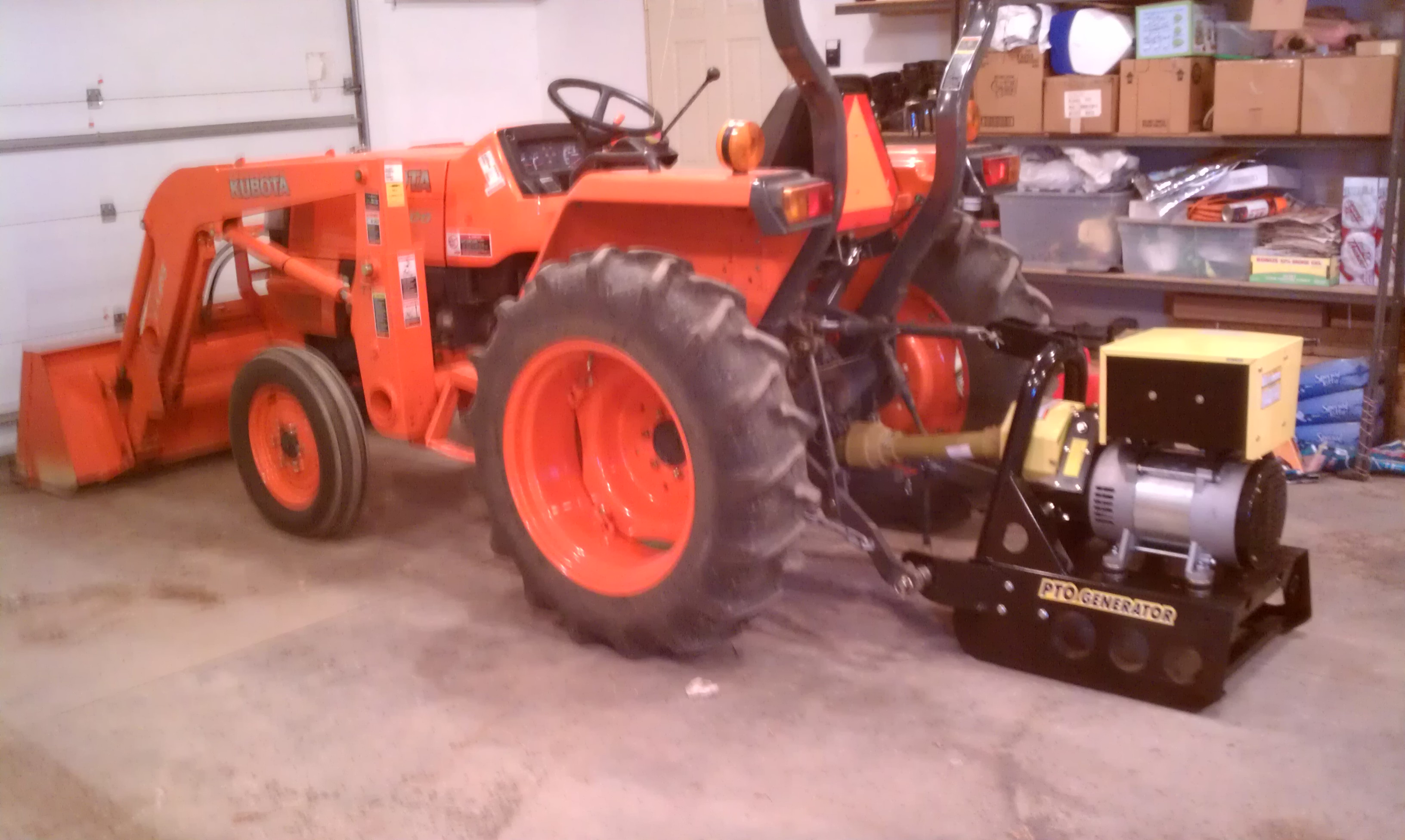

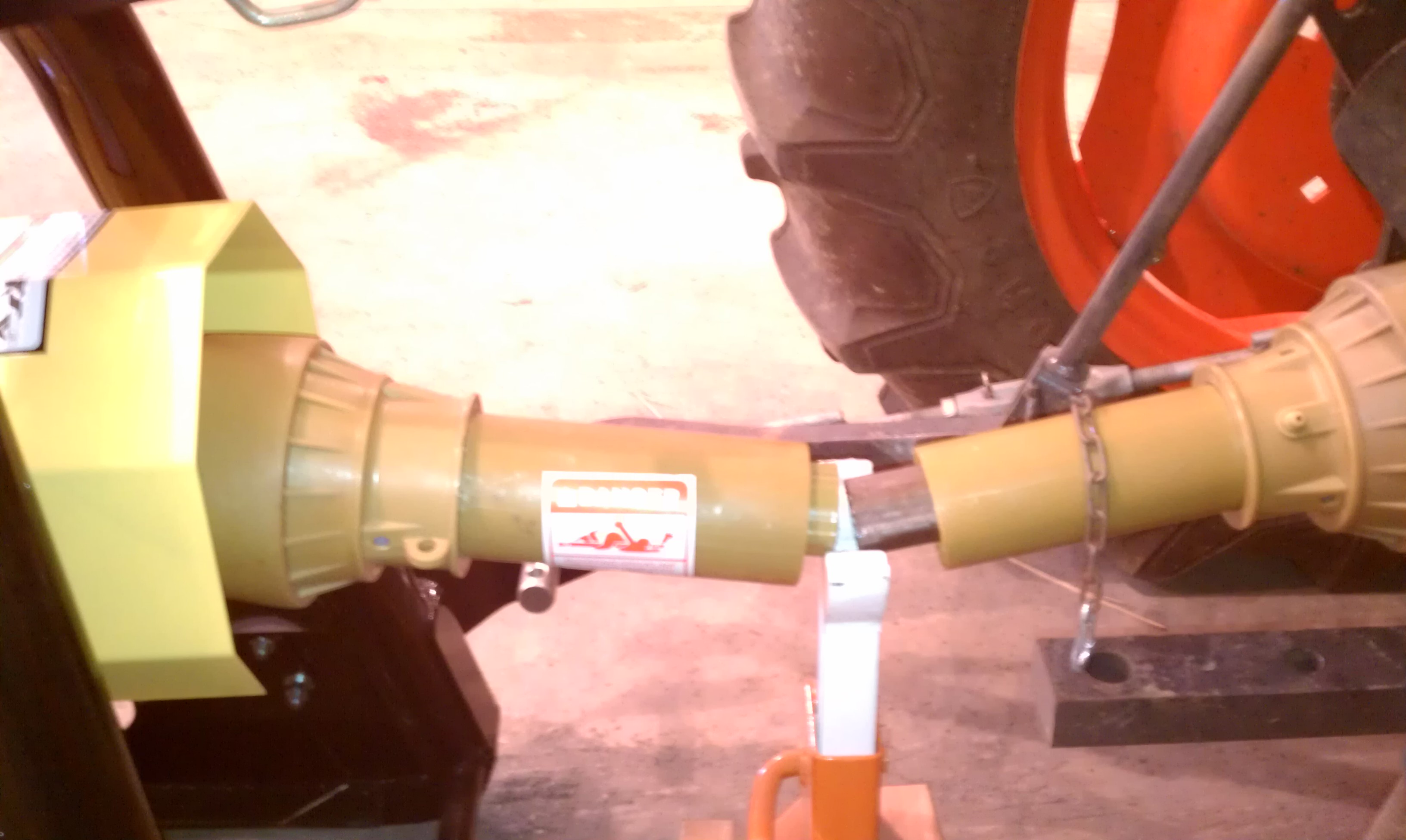

Some pics...
Oil Fill Gap.jpgPTO Gap.jpgGen Closeup.jpgGen Control Panel.jpgGen Profile.jpg
/ Voltmaster PTO generator #73
First pic is how crappy the oil fill plug was tapped at an angle...going to request another plug plate & gasket. I don't believe gasket can seal opening.
Second pic is the PTO which measured 26" from safety lock to safety lock...barely touching when hooked. Not sure what I can do.
Third Pic just photo of gen hooked up.
Fourth Pic the control panel
Fifth Pic another shot of unit attached to tractor.
/ Voltmaster PTO generator #74
dang that shaft is short!
on the plug.. I assume straight and not taper thread.. that's pretty sad....
/ Voltmaster PTO generator #75
Considering the relatively little use a generator will get, I'd suggest a PTO extender from Agri-Supply. They add 4" or 5" to the length of the tractor's PTO stub shaft which would be adequate for an implement that is stationary when in use.
