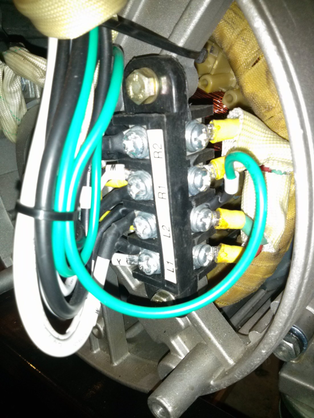

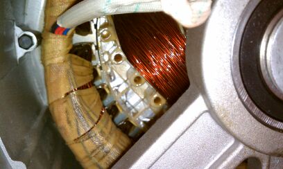

Take a few pics of the end with the cover off if you get a chance. I looked at mine and it seemed to be well built with sealed bearings. I do have brushs though.

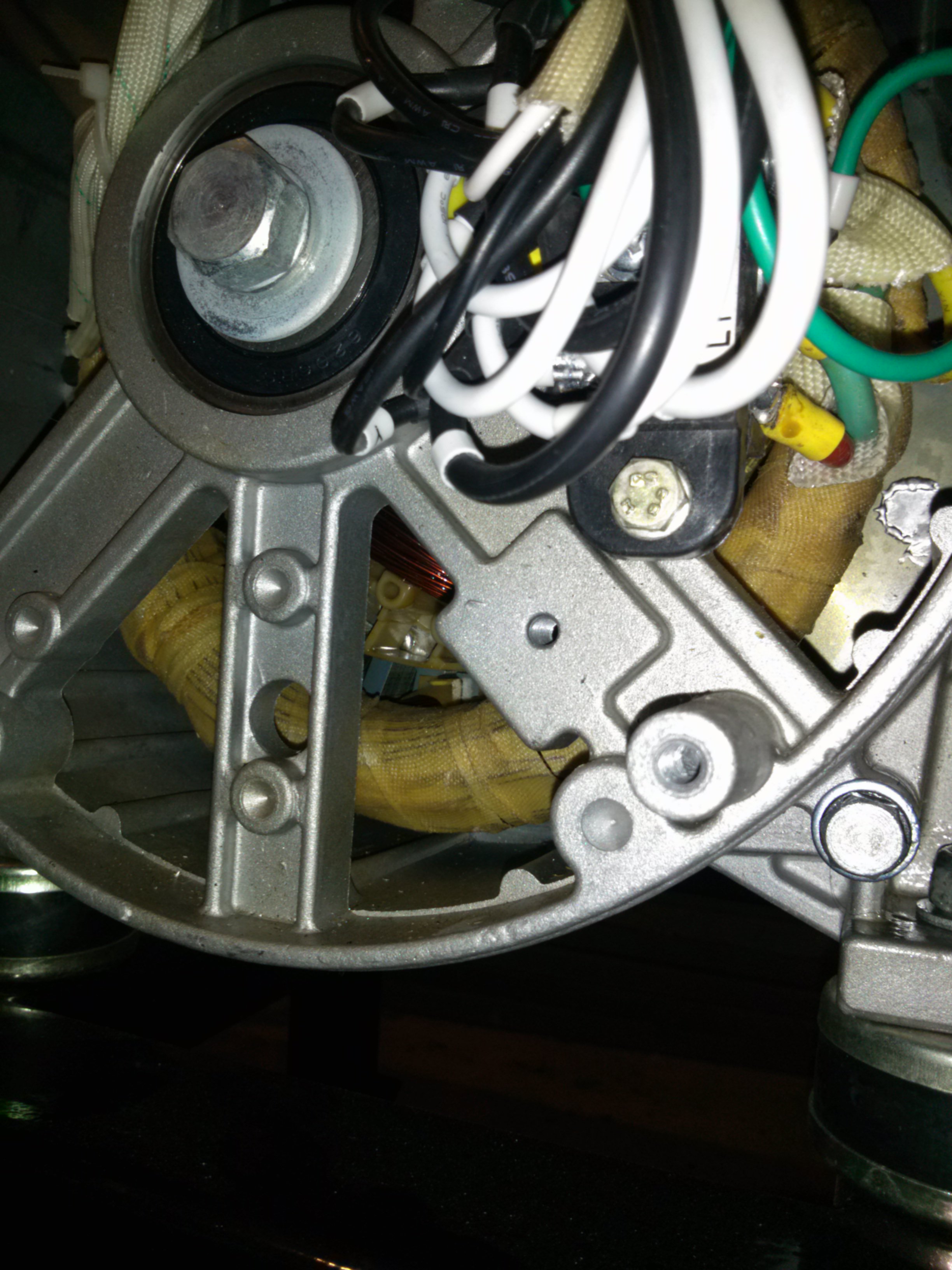

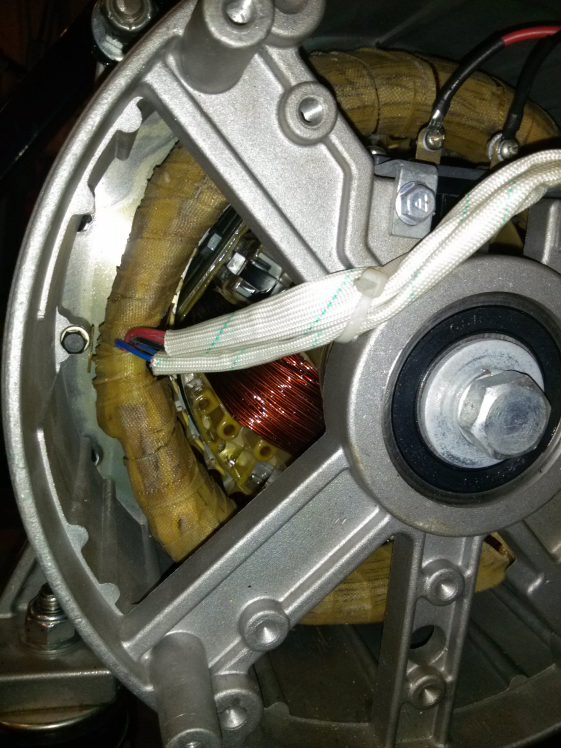

Ye ask and ye shall receive:
I could not see any brushes that would be touching the rotor. I am not sure if the pics accurately show that or not.

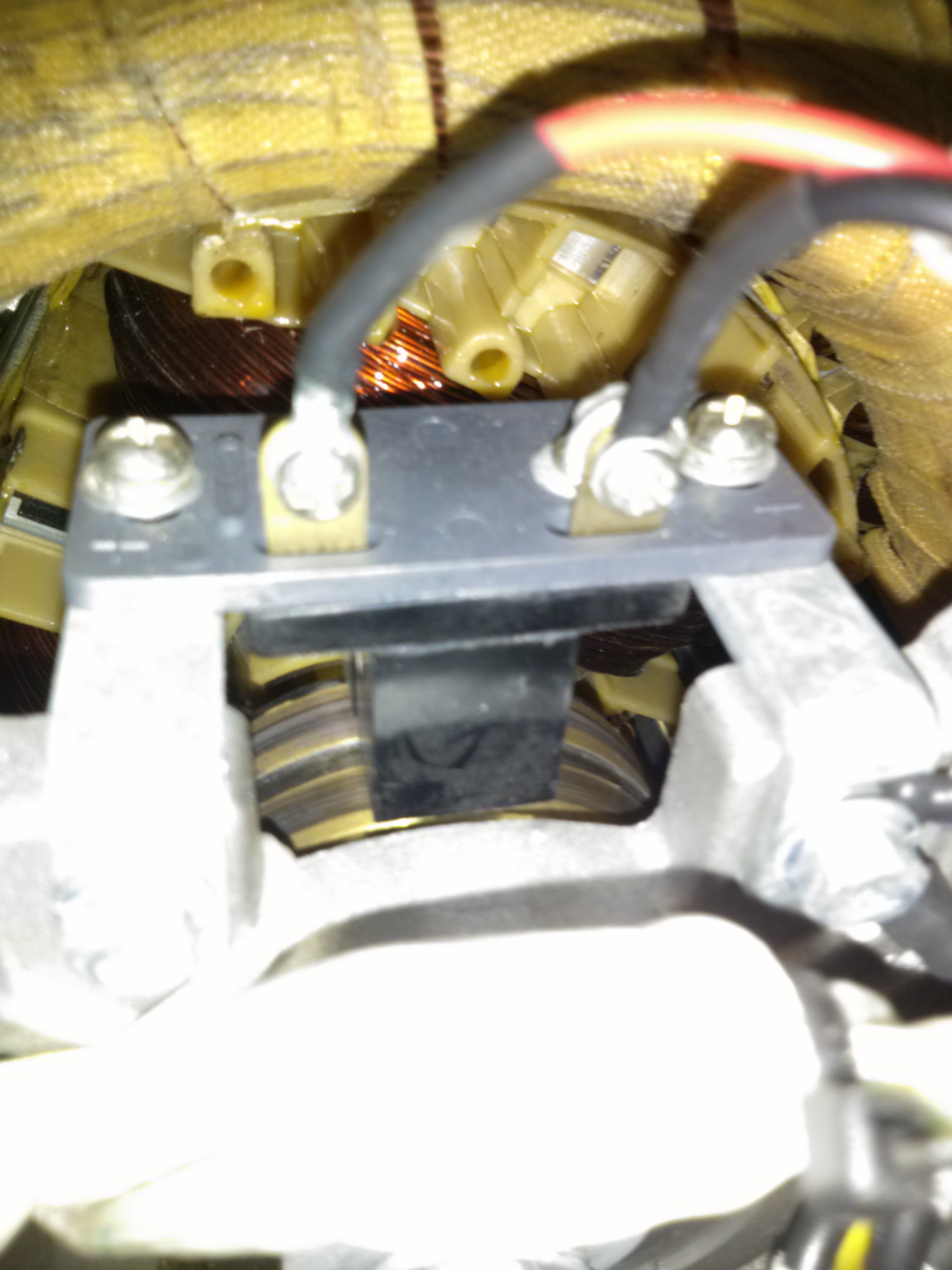

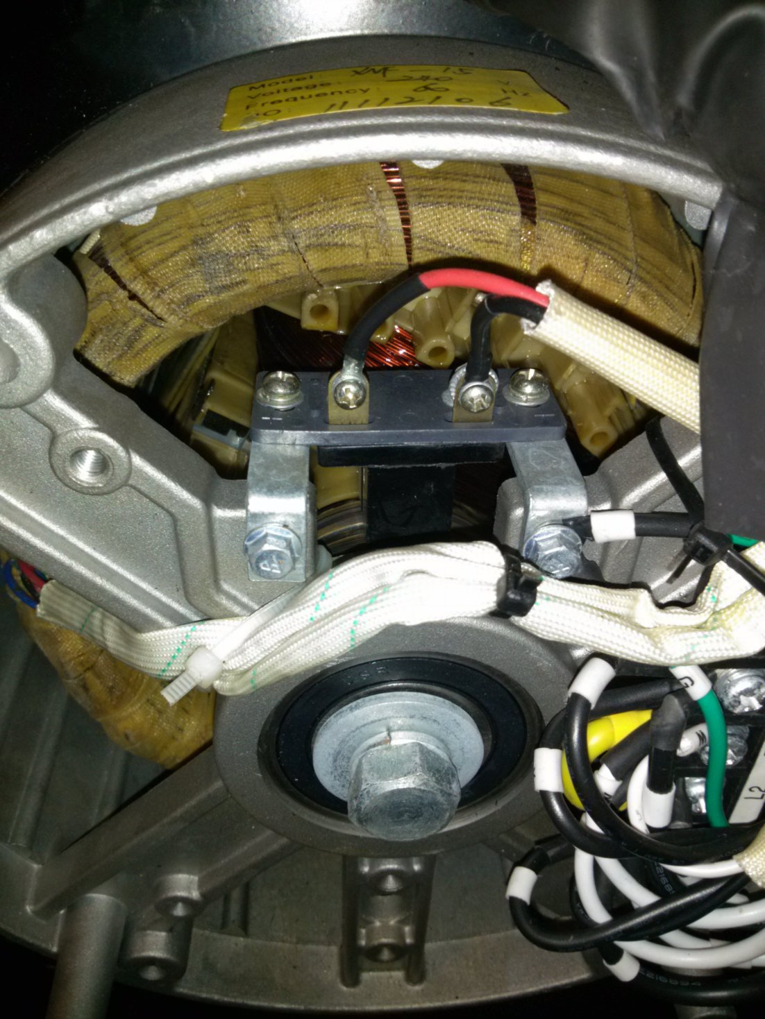

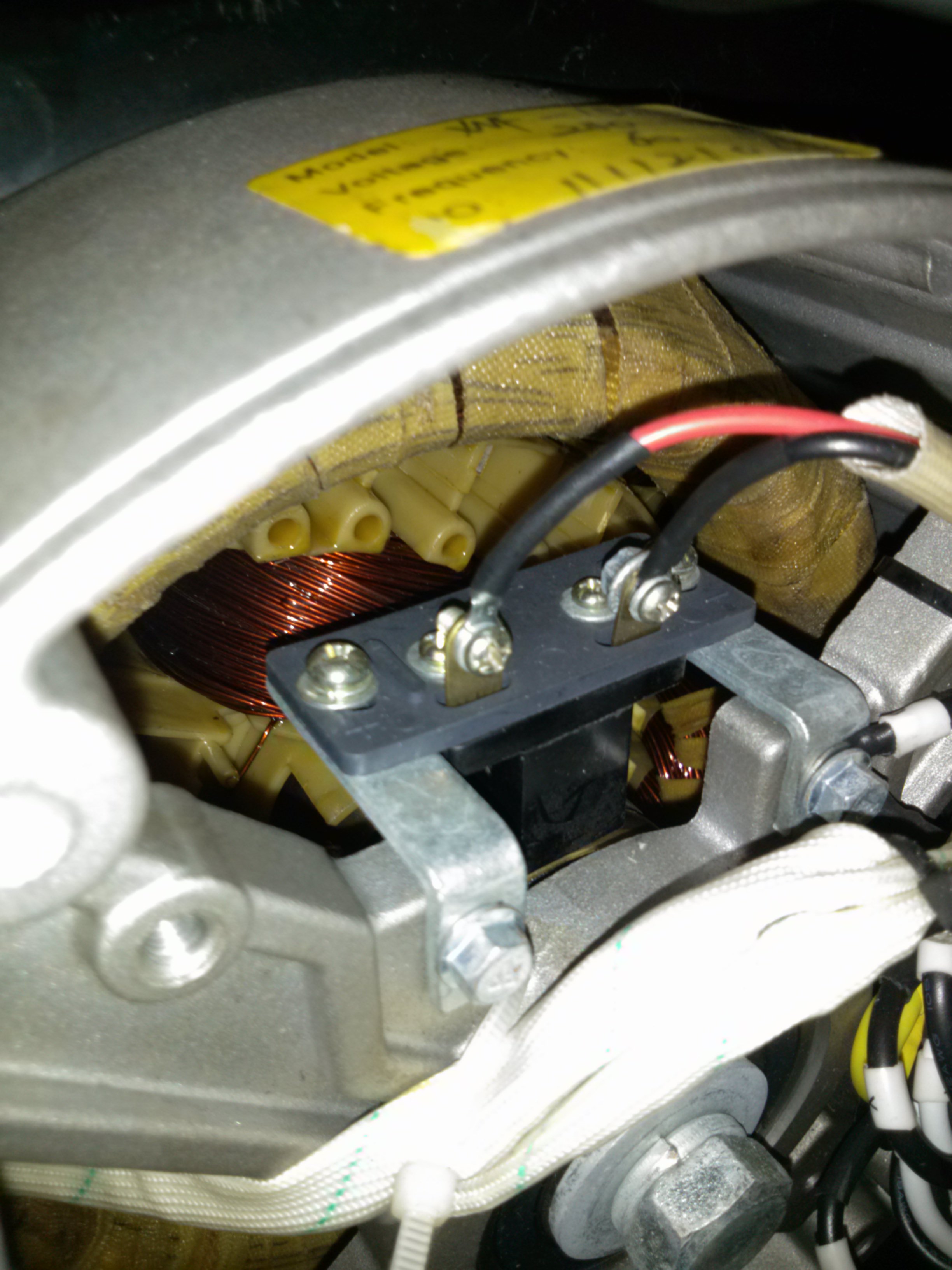

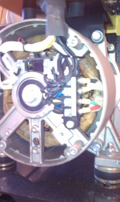

0905122050a.jpg0905122051aa.jpg0905122051ab.jpg0905122052aa.jpg0905122054aa.jpg0905122054ab.jpgIt looks to me like I can make out the brush holder in the pic at the top. I will post some pics of mine later today. If you still have the cover off take some of the area above the bearing Like in the first pic the brush holder has 2 wires going to it. Thanks

looks like they are the same. RK needs to change their statement about it being brush-less in their question and answer section.
Look just above the bolt on the end of the shaft there is a black plastic brush holder look below this box at the shaft and there will be brass colored slip rings for the brushes to ride. The pis I posted show close ups of the brush holder.

Here are the pics
You are correct it has the same setup. However, the wires coming off of mine of very light gauge like they are for the voltage regulator, an excitor, or some monitoring device, etc. There can't be many amps coming off of those wires. I can't tell for sure the gauge of your wires and should have taken a photo.

Regarding the wiring that comes off of the brushes at the end of the shaft...
Could those possible be associated with the 12V DC, 8.3A outlet located on the outlet panel? Just an after thought. Sorry to beat this dead horse.

The wires to the brushes are to provide exitation voltage to the rotor coil and the voltage comes from the AVR (Automatic Voltage Regulator).
