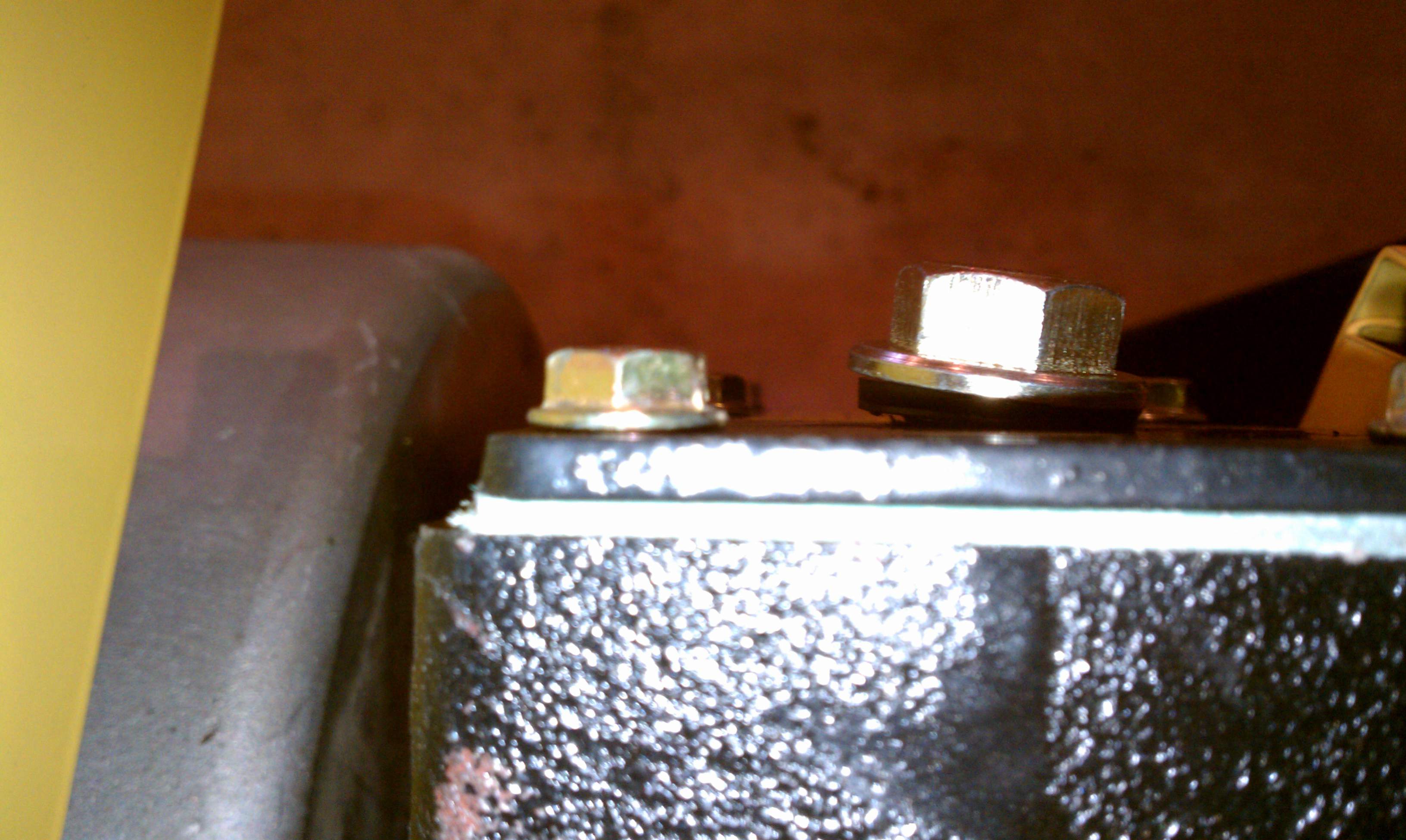

First pic is how crappy the oil fill plug was tapped at an angle...going to request another plug plate & gasket. I don't believe gasket can seal opening.

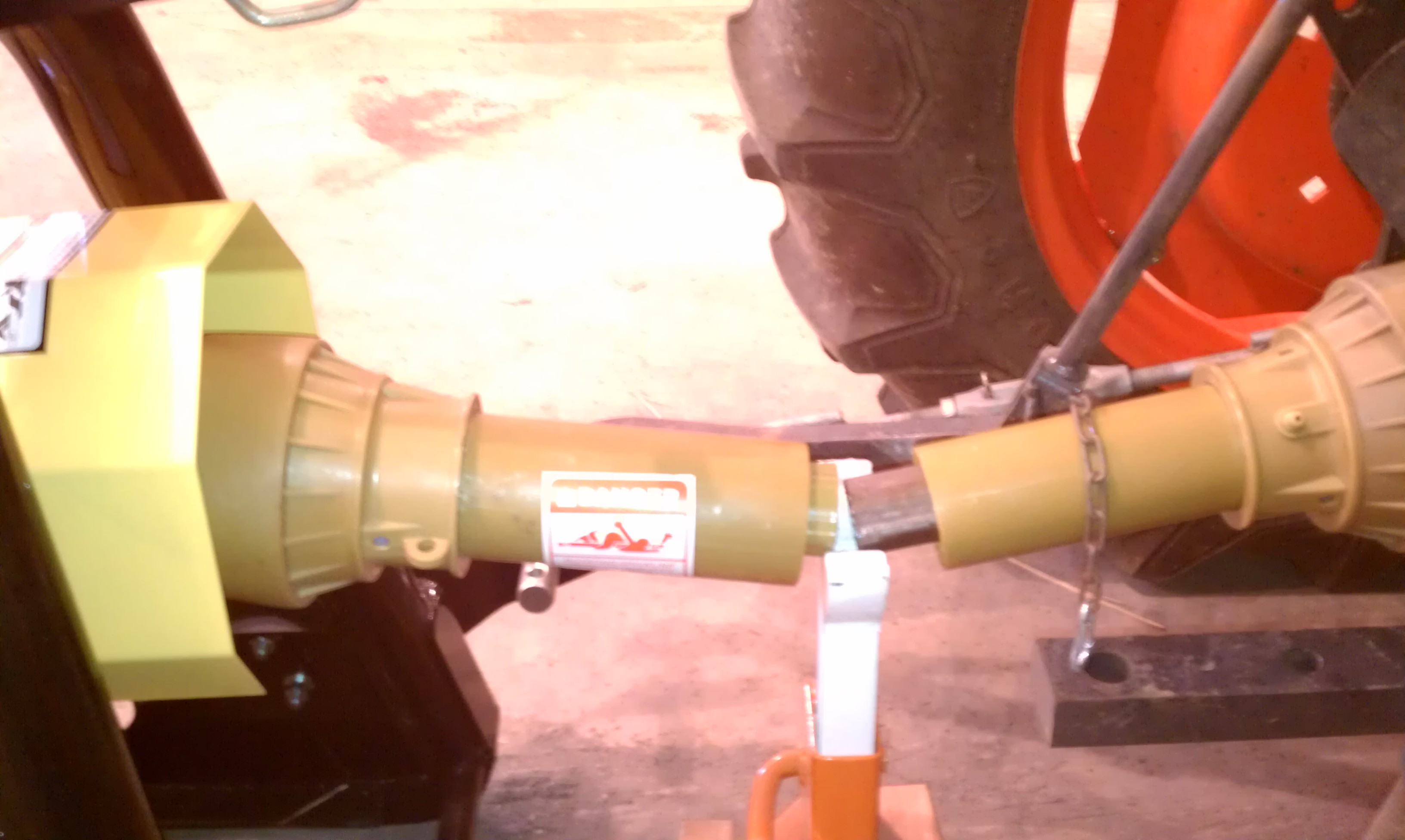

Second pic is the PTO which measured 26" from safety lock to safety lock...barely touching when hooked. Not sure what I can do.

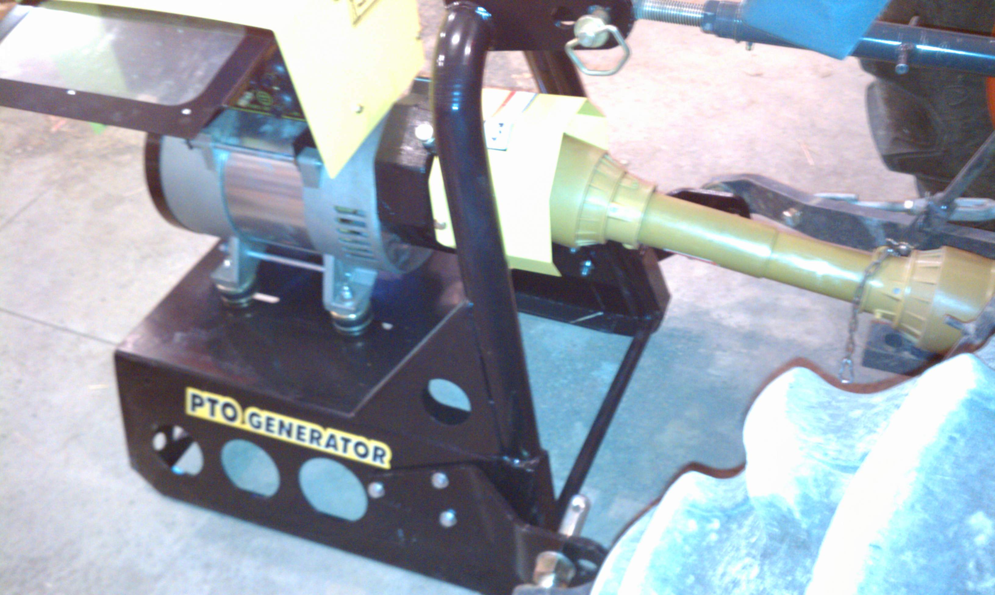

Third Pic just photo of gen hooked up.

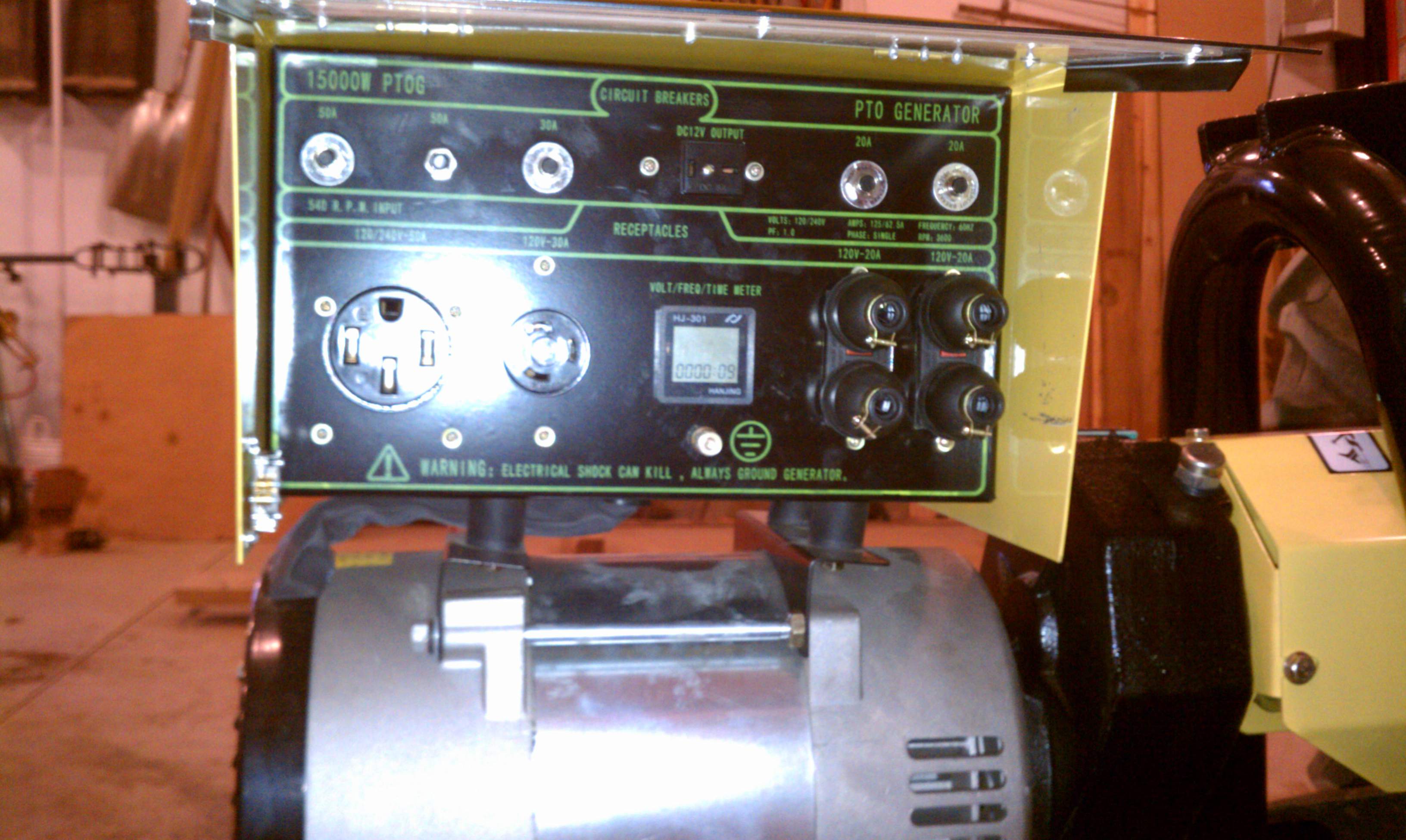

Fourth Pic the control panel

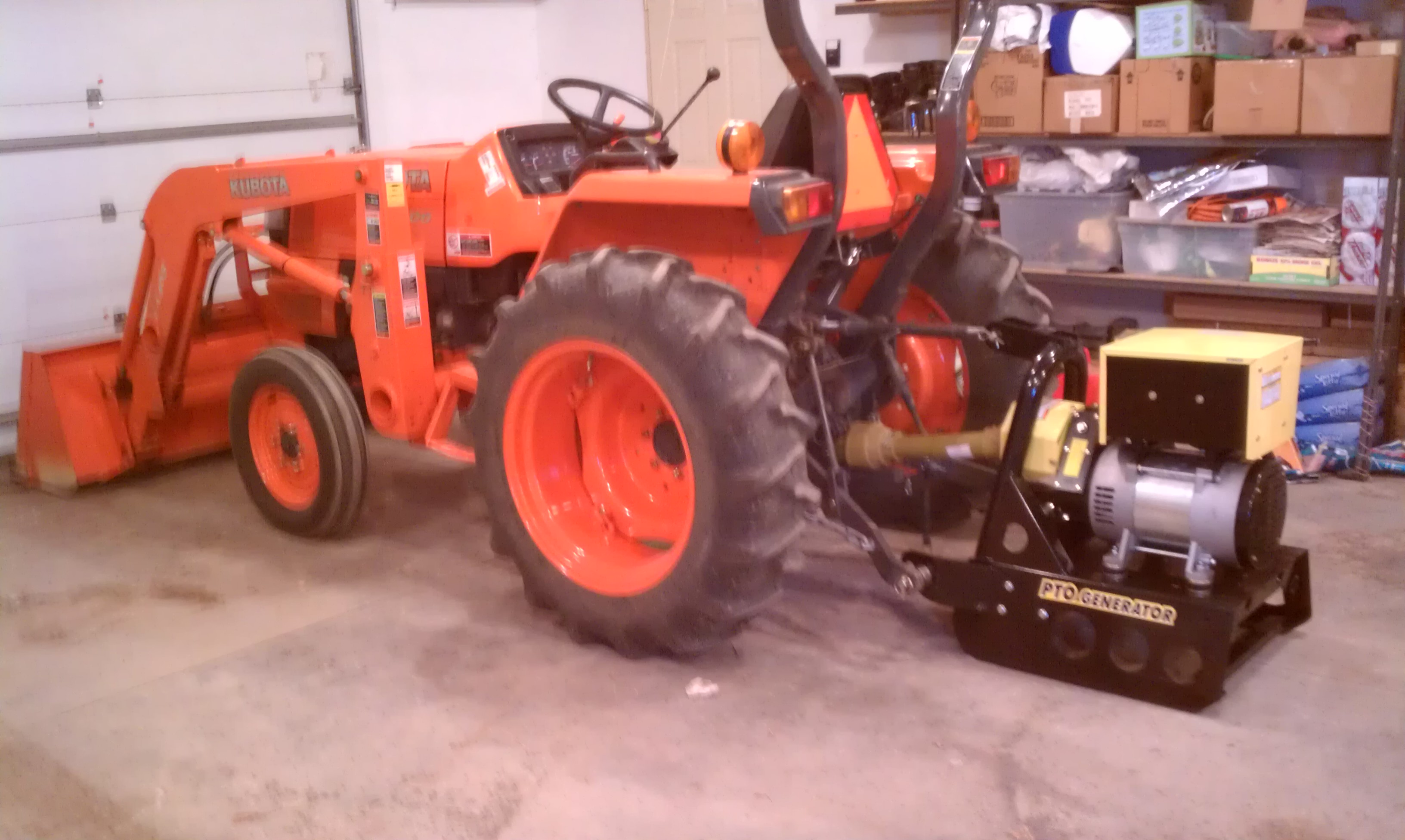

Fifth Pic another shot of unit attached to tractor.

dang that shaft is short!
on the plug.. I assume straight and not taper thread.. that's pretty sad....
Considering the relatively little use a generator will get, I'd suggest a PTO extender from Agri-Supply. They add 4" or 5" to the length of the tractor's PTO stub shaft which would be adequate for an implement that is stationary when in use.

No kidding, I sometimes wonder if the Chinese will ever catch on. I remember when "Made in Japan" was a dirty word...my how times have changed. The gears in the gear reduction unit appeared to be expertly done. I suppose the 5 year olds are in charge of tapping the oil overflow plug hole. Hope they get thirty lashes!!!:laughing:
I am going to contact Rural King and request another tapped plate and discuss the pto shaft.

the pto extender is a great idea roy!
