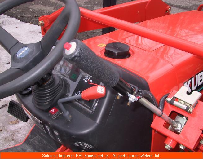

Thanks for the positive feedback on the pics. They were more of a hit than I expected. I realized a may have missed an important one--the electric solenoid button on the FEL stick.
So, here is one more.

The electric solenoid comes with button, new handle grip, clamps...everything needed to install.
