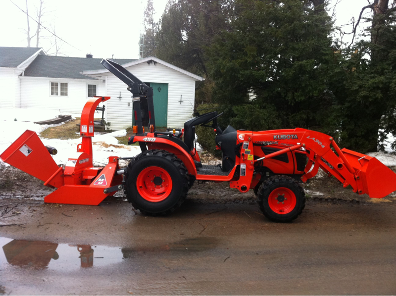

You guys are a bad influence,
Just got the BX42 today, tried it for 30 min and it is just awesome. We still have snow in Quebec so I am keeping some work for later on when the weather is better. Was a bit confused on which end the shear pin should go with the shaft but after reading the instructions I concluded it had to be attached to the chipper.
Here are a few shots.
