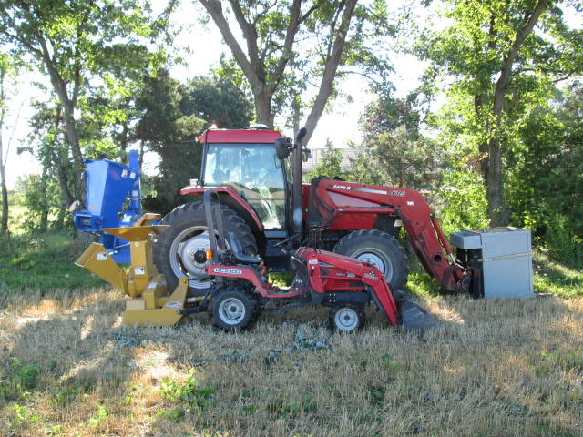

I was quite happy with my BXM32 until the neighbour showed up to trim the trees along the fields.:laughing:
