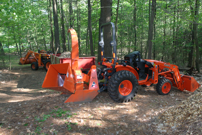

I have been using the BX60 for two years with a B3030 with a rated PTO of 23hp. I chip mostly soft wood.. pine etc. 3 to 4 inch without problem as fast as it will feed usually without limbing the tree. I adjusted the fixed knife to make smaller chips in the interest of chipping 5 inch trees without stalling the tractor. A little more horsepower would be nice. An L39 is not far away. Weight has not been a problem.
