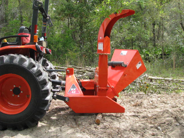

I have Wallentstein BX42s, manual feed, chipper only, powered by 25 PTO HP Kubota B3300SU.
If I had your more powerful, heavier L3940, plus the extra $1000, and wanted a chipper-only I would purchase the BX62s Your heavier flywheel and engine inertia plus 30 PTO HP is ample, AMPLE, to power a BX62s.
I would repeat my purchase of my BX42s but now I sort wood debris three ways: firewood billets, chip for mulch and burn pile.
Had I bought the BXM42 chipper/shredder I would have eliminated segregation of small stuff for the burn pile which in BXM42 scenario would be shredded where where collected.
With 43 acres as the "tie breaker" go with the BX62s chipper-only over the BXM42 chipper-shredder.
Wallenstein is really quality equipment. The rectangular shape of the feed opening at the rotor makes a BIG difference.

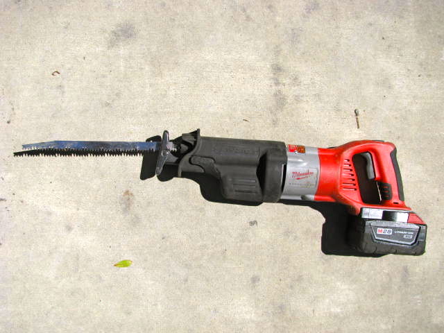

Consider a battery powered reciprocating saw for trimming tree branches. Faster than a chain saw for up to 1",equally fast for up to 1-1/2", blades much cheaper than replacement chains and MUCH SAFER.
Your wife will love operating a battery powered Sawzall.

That is the second mention I've heard regarding using the battery powered sawzall. I'm going to try that out next time I use my chipper. Thanks for the tip :thumbsup:

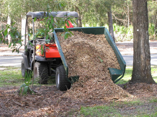

Thanks for the advice so far. Does anyone have pictures of the output for the chippers vs the shredder? My wife would like chips/mulch for planting beds.

I have Wallenstein BX42 with manual feed. I've powered it with 25 hp pto and now 56 hp pto. It has never given a moments problem. I'm chipping about 95% Ponderosa pine and the rest is mixed - apple, locust, birch. I NEVER limb anything and the chipper simply grabs the trunk/limb/brush and pulls the tree in. Anything bigger then three inches is saved for firewood. If I had a BX62 then I would have to cut the trunks into pieces because I find it just a little difficult to lift a full pine tree that is six inches at the butt. Besides, a six inch tree is firewood up to around three inches or so.

I have the BX42. I wish I had the BX62 just so I didn't have to trim branches as much before feeding, but its truly amazing what will fit in the 4x10 throat. The only jams I have had have been from trying to feed twigs and leaves thru it, so I chip down to where the branches get small and then pull them out of the chute and toss them on the ground to go over with my brush hog. Problem solved. I would love to have the hydraulic feed since at the end of the day my arms look like I lost a cat fight with a tiger. I don't wear sleeves since I don't want them getting caught in the branches. The Wallensteins are awesome.
