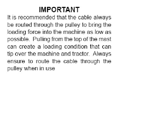

I was quoting the manual (i think). I hear what you're saying, but as long as the 3 pth arms attach below the lower pulley there's a downward force. I know that when it's running off the top pulley I can watch the draft control sensor on the top link flex, but I don't worry about it stressing the top link, then again I don't worry the blade not digging in when it's on the bottom pulley. It's all good.

Yeah I've never had an issue with my fx90 not digging in when using the low pulley. I've buried it way down on many occasion. I use the low pulley almost exclusively because I winch in then lock the drum and skid all in one effort without leaving the seat.

I agree with you guys. You can use your winch many different ways and it will work fine. They are robust versatile impliments. The weight of the winch provides some down force but a lot more is added by winching from the top. If you are on frozen or hard ground winching from the top really helps to make the blade grab. There are more of advantages winching from the top. For one, using the top tends to lift the logs so they don't plow so much and are more likely to ride up over snags and debris.
The point I was disagreeing with was where Coby said that you should never winch off the top pully. That is not at all true. And I feel a new user needs to know that. They are designed to be used that way. And if the winch matches the tractor the top link is plenty strong. Pulling at a side angle is what will tear your top link out. The top link should take a hard straight winch just fine. The weakest part of of the winch line is most often the cable or pully shaft not the top link.

I'm not crazy, I did read it in the manual:
....although I don't follow their guidlelines. What do they know!:D

I can see what you mean and why you would thing as you did. That is very unclear. But I believe that they are referring to when you are skidding the logs out to the landing and not to the act of winching. The key being they state you are less likely to tip over (backwards if the load catches or up hill, or sideways during a turn) when using the bottom pully. That only makes sense skidding. It would be almost impossible to tip the tractor over with a straight winch pull off the top pully unless the tractor is way to light for the winch. You could winch it over with a side pull however, which is a big no-no, and also twist up your lift arms and top link. Tip over is a definately a higher risk when skidding from the top pully especially if the load is to heavy for the machine set up.
If you read your manual the way I suggested about it agrees exactly to what the Farmi manual says about pully usage.
