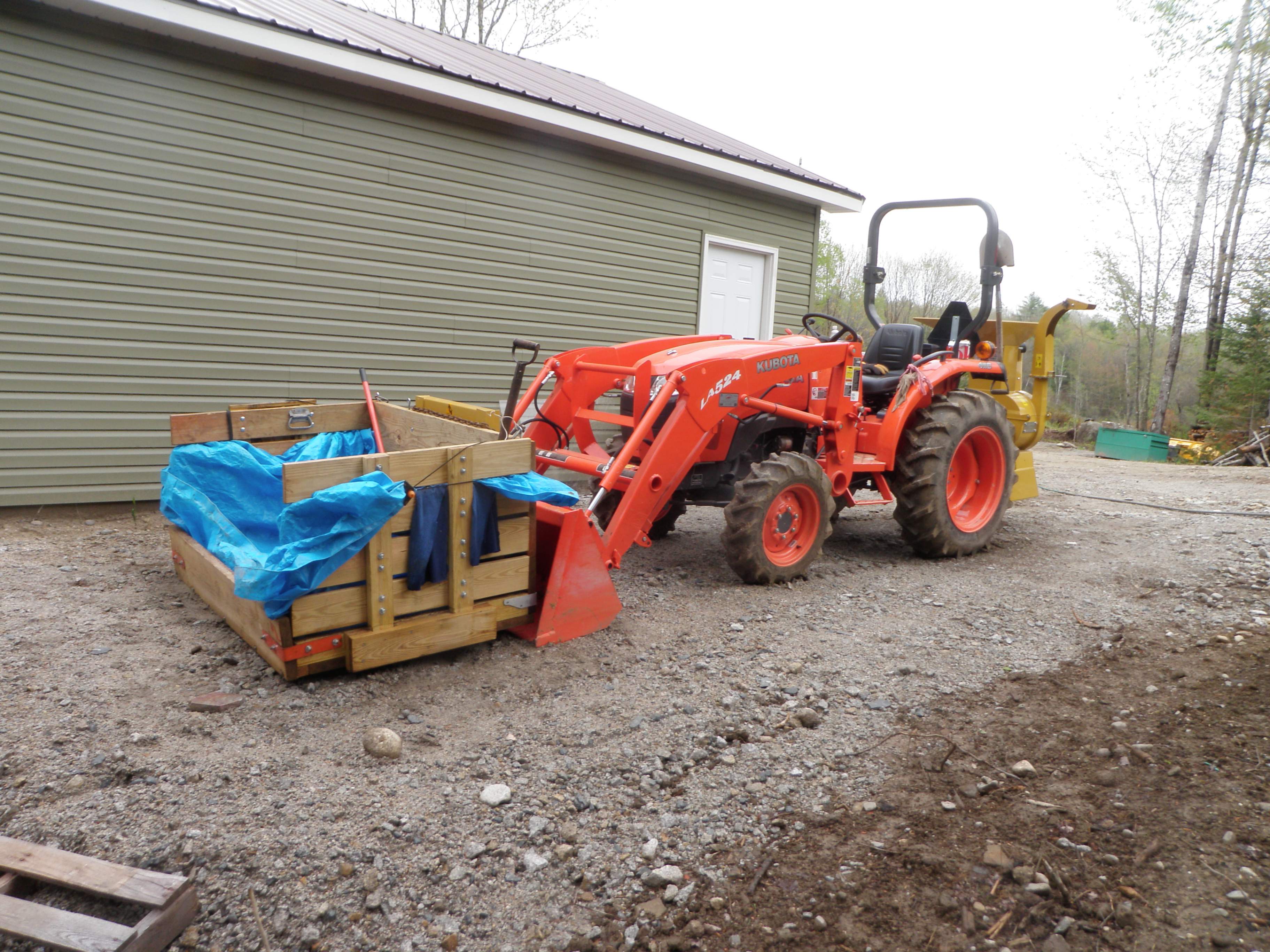

I figured I would add a few shots of the wally and the large carry all set up that I use in the FEL with a simple chain and load 3X as much, and can load it from the chute.

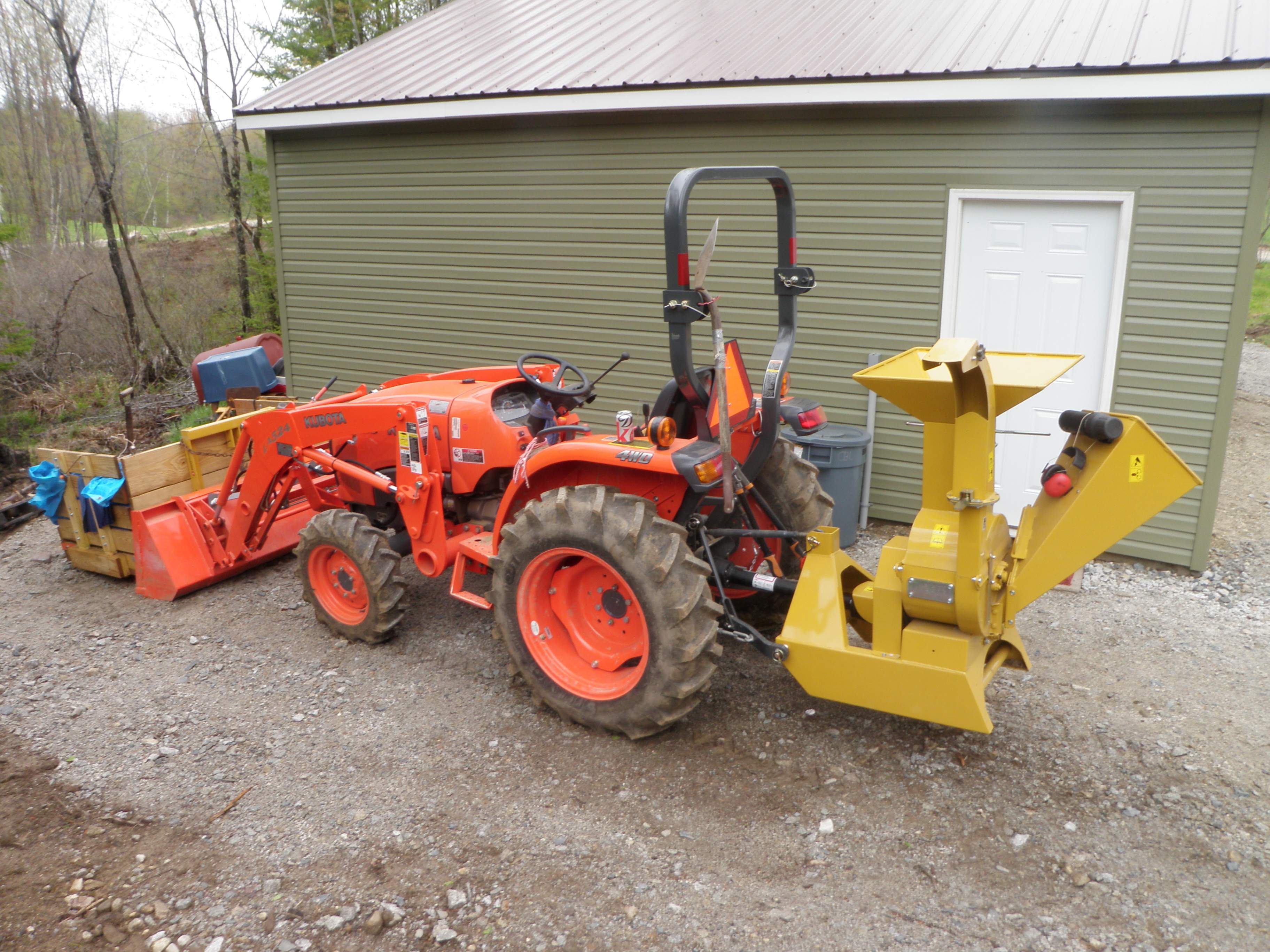

Nice. I never get tired of using my chipper, probably because I wanted one for such a long time and finally got around to buying one. I used to rent them and now I can take my own out of the garage any time I get a few branches together. My lot looks much better and I like using the chips to keep the weeds down and maintain paths. If I ever get another one it'll be the BXM42, in green of course. Then again I think this one is going to last forever.

   / Wallenstein WOW! #27
Gus,
Can I assume that those 4x4's are bolted to the bottom of your chipper and just resting on the dolly? I've been thinking about bolting some to mine as well.
   / Wallenstein WOW! #28
Yes, I attached them with lag bolts. I got the idea from this site last year, shortly after I bought it. I wanted to do it for a few reasons. It raises the unit a bit when it's in use, it gets the metal base off the wet ground, and it allows for a little down-travel with the 3-point hitch past the grounded position because it's elevated on the 4x4s. I had just ripped out an old deck so I ended up with some well-sealed 4x4s all ready for reuse.
I love this chipper but I admit I often wish I had their chipper/shredder because it would be much better for all the pine debris I get in my woods. This one will eat that stuff, but not as readily as the shredder hopper on the bigger unit. I just wanted a simple, small unit to start with. It seems to be a great quality, and although it's much more expensive than burning everything, I have too many uses for the chips so it was worth the investment.

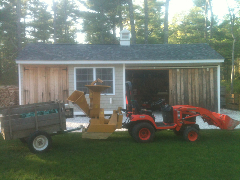

I also used 4x4s to get the unit up off the ground more so the drive shaft is closer to level while operating. Also makes it easier to hook up to my quick hitch as the unit is lower than the 3pt will go. Also added a hitch ball to the back so the trailer can come along.
