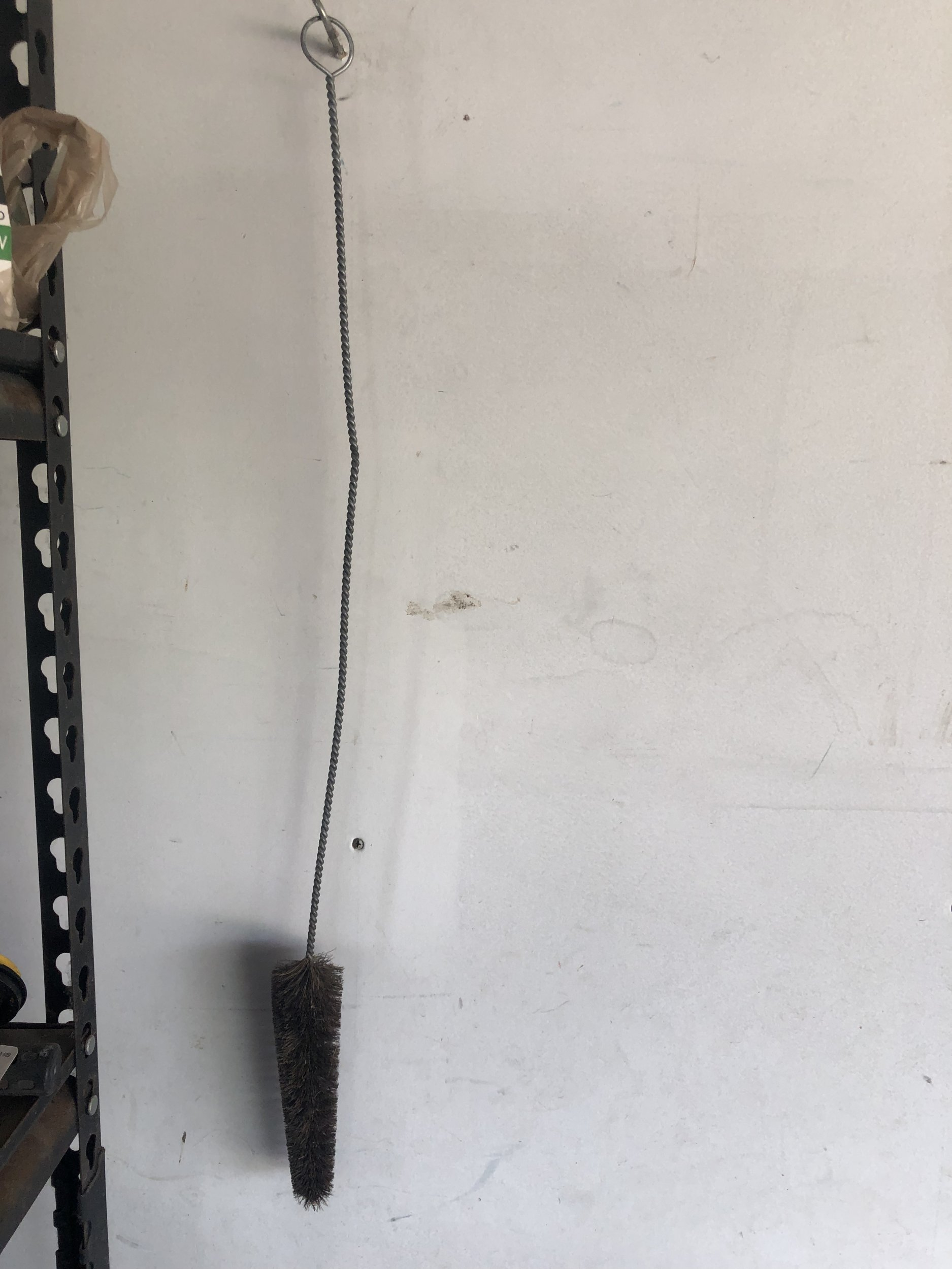

I use one of these - keep it behind the tractor seat when mowing the field. When the engine temp starts creeping up, just brush the chafe/seeds off of the radiator fins and screens without any damage.
