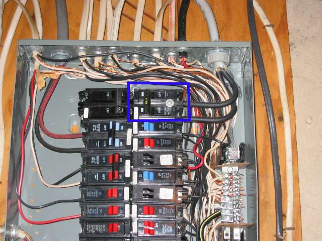

Okay. Here we go with pictures.
This picture shows the fuse box in the main house. The area surrounded in blue is what is labeled main. These are two breakers, each labeled at 50 A and tied together with a plastic bar.
Again, I thought that this would give me 100A service to the house. (2 X 50 A in parallel). The sticker on the inside of the door to the box says 100 A service. This sticker was put in place by the Electric Company.

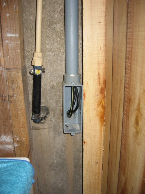

Here are the wires leaving the house. I was able to read the fine print on the wires and they said "Alcore THHN 6 AWG". Looking this up online makes me think it can carry around 60A.
I wonder if this means that the two breakers to the barn are carrying 220 V 50 A as that would make more sense... Anyone?

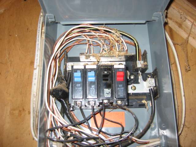

Final picture showing the breaker box in the barn.
Some clarification here. I was incorrect earlier with my description. The blank spot on the right of the panel held a 40A breaker which wasn't hooked into anything. I removed it so the rails could be seen behind it. (Don't worry all, the breakers in the house were off for good measure!)
There is in fact no main out here in the barn. Just a few 20A and under breakers for lights and outlets. I think there are maybe two outlets or lights per breaker. Very few here in the barn.
The barn is about 150 ft from the house (my original guess of 250 ft was WAY off).
I also have a voltmeter if that would be of any help figuring this out. I'm just not used to working with AC or this much current so I'm not in a hurry to just start messing around.
Thanks so much for all the help so far!
Mark

Hey, you are good to go... Just put a double breaker in the last two empty slots and wire that to your welder socket. If you need specifics on exactly how to do it and what you need just ask.

The photos indicate that you do indeed have a 220 service in your barn. You can probably get away with replacing that unused 40A breaker with a 50A. I would probably save the time and money and run the welder on the 40A breaker that you have.
Just understand that you're at the limit of your service when you fire up the welder and lay into something thick with all it's got. Also, you're bringing the rest of the house to about 50A at the same time, so try to not use the oven, stove, air conditioner, etc. at the same time as the heavy welding.
It won't cost very much to have a licensed electrician come out and verify our free advice, so please don't rush off and do what any of us say we would do if it were our barn. Get yourself comfortable with whatever you do, since you have to live with it.
