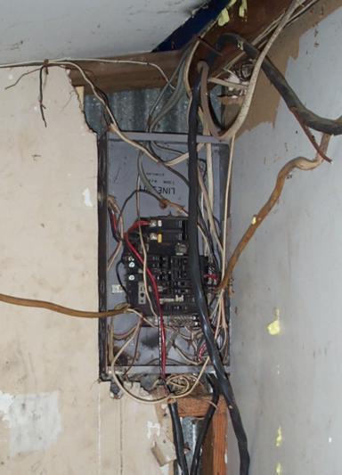

Want a good example of what not to do....
Here is a picture of the electric panel in my shop when we bought the property.

Yikes Bob! I'm glad I don't have that problem! /forums/images/graemlins/shocked.gif
   / Want to add 230V outlets to my barn #40
Bob,
That photo scares me more than any horror movie I have ever seen.
I have visited many folks in my area of Michigan and have seen some very risky wiring, much of it done with lamp cord type of wire or 18 gage extension cord. The wire in your photo looks scary but at least it looks like the right gage of wire was used.
Farwell
